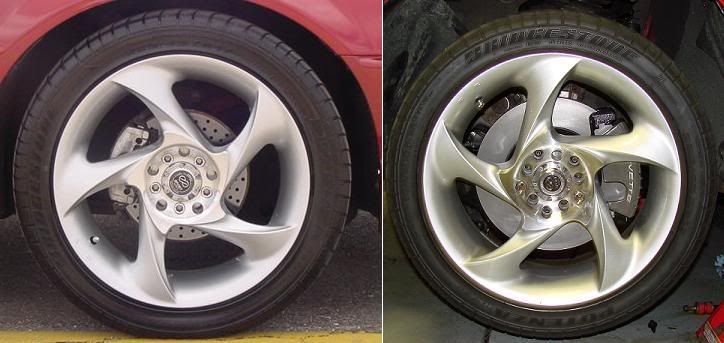

Here are some more semi-finished pics (I still need to get brake lines and my pads aren't installed in these pics).

This next one shows the difference in size of the stock rotors compared to the F-body rotors... 10.125" vs 12.19"
