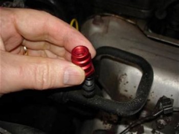

I'm thinking you still have an R12 system. From what I remember 1993 was the last year R12 was used by GM and 1994 started R134a.
Look for a fill valve, what type of valve/port do you see?
Do you have the v6? Check under the air cleaner on the canister.
In the example photo the red one he is holding is a R-134a retrofit kit adapter and the pipe below it has an R-12 fill port.
An R12 system can be converted to R134a. Usually you can put the fitting and fill it with R134a cans as long as it holds pressure.
R134a has a high and a low side, you want to put a low side adapter on the R12 low side port.
They are usually color coded Red for High side and Blue for Low side, however some cars I've seen black covers on all refrigerant ports.
My 1990 Indy I had converted from R12 to R134a. All that was done was the retrofit R134a fitting was added and the system was evacuated and recharged with R134a. It blows just as cold as it did with R12.

If there is any mineral oil left in the system the ester oil will mix with it and dilute it, the pag oil will not mix.
Easter oil works for both r12 and r134a.
PAG oil only works for r134a.
wiki link:
https://en.wikipedia.org/wiki/Polyolester
It is also recommended to replace the accumulator dryer canister and refill the new one with the proper amount of easter oil.
I usually get the one with the UV dye so if my systems ever leak out I can find the leaks easily.
