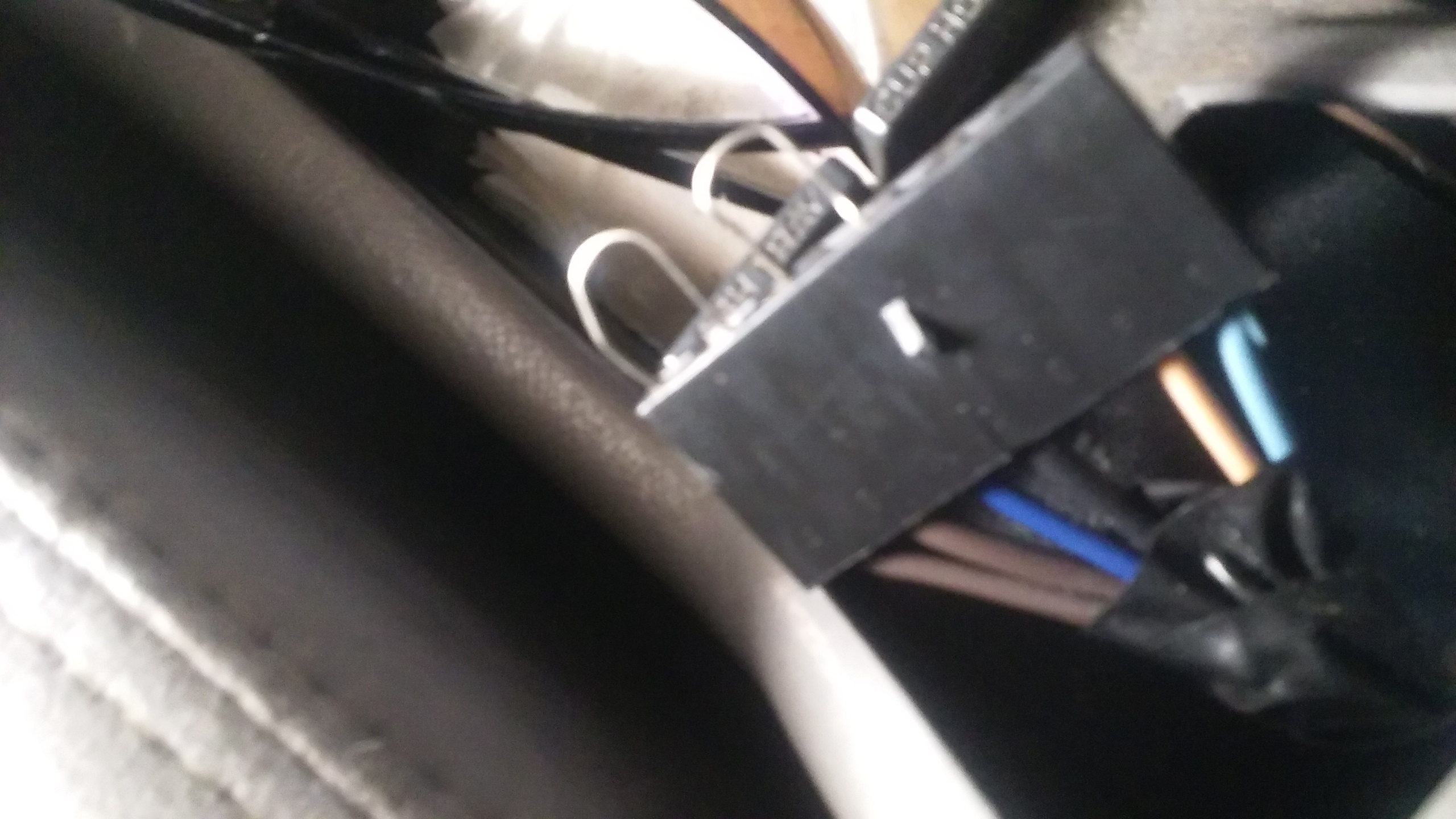

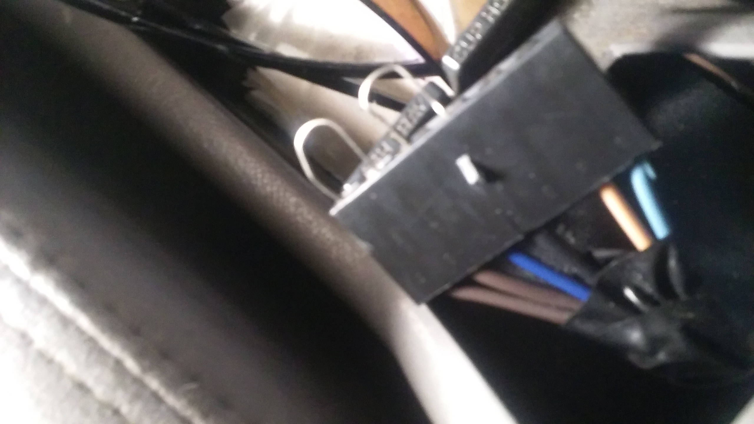

Before we get to that. I tested the switch on my 96 to be sure it works and it does.
However GM had some window motors or regulators as they are some times called that go bad.
I experienced them on my 93 mini van drivers side and my 94 mini van passenger side.
One symptom is it goes down pretty good but struggles going back up at first ]
but it gets worse until it won't go up or down.
To test your motor to be sure it is ok and that the switch is not OK, with the key off,
Pry out the bottom of the switch to remove it and disconnect the wire harness.
Use a paper clip cut in two, and place one between
the 1st and 2nd contacts. brown to brown.
Then the other on the 2nd set of contacts. Blue to black
See my picture, I tried this myself to be sure it would work.
Then turn your ignition switch on. The window should go down. If it doesn't your motor is bad.
But be sure to turn the key off before the window hits bottom!!! You don't want to stress the motor.
You can re-connect your switch back on to get the window back into the up position.
