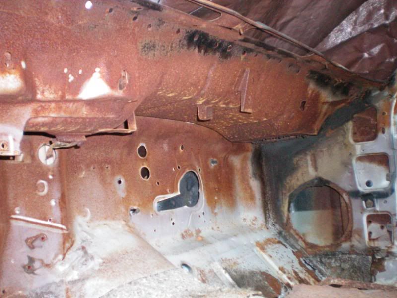

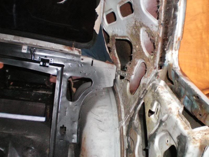

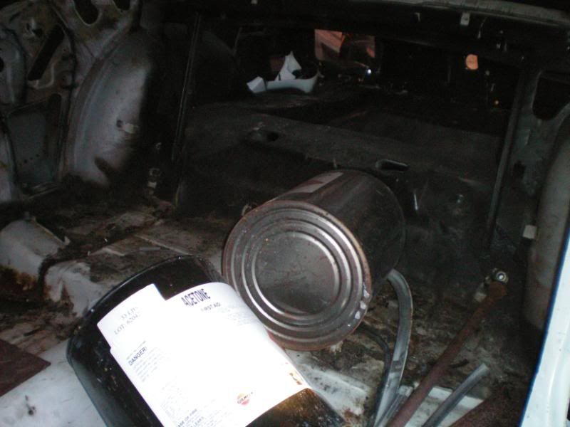

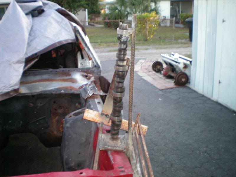

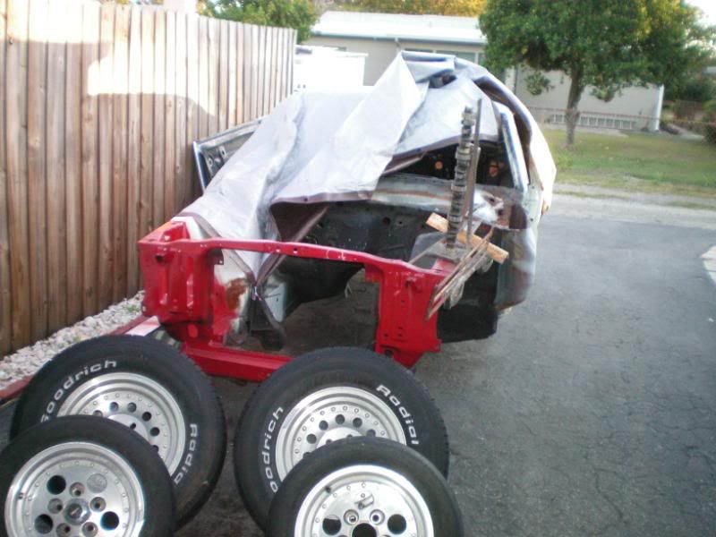

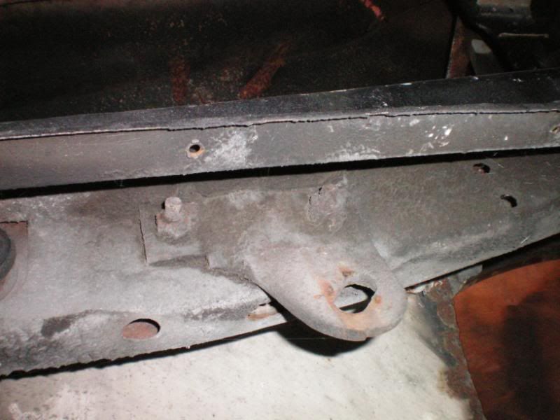

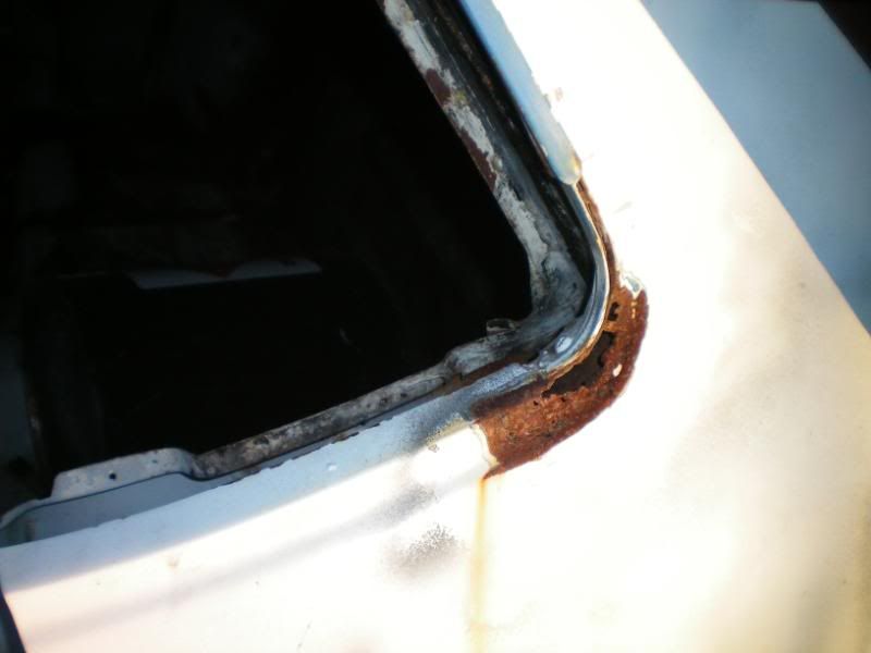

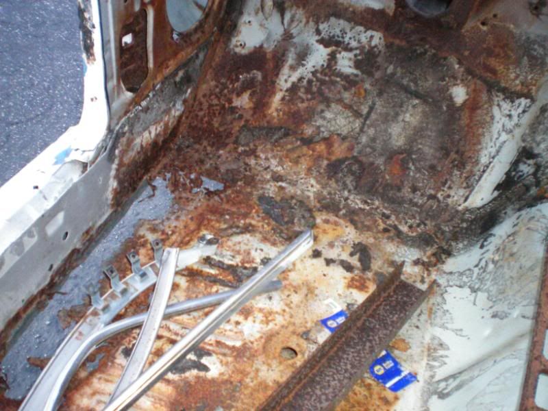

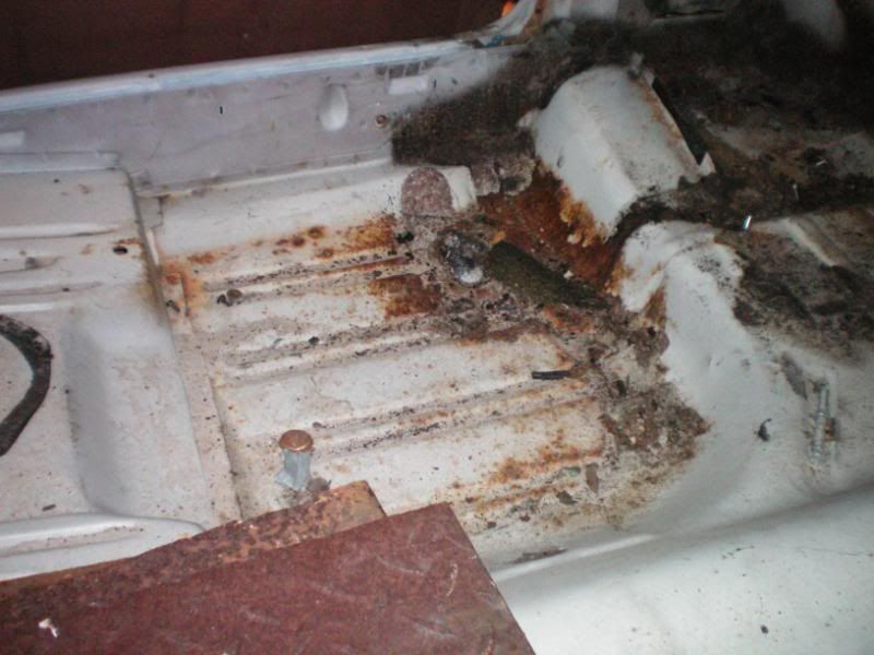

hehe you didnt see UNDER the tarp....
Here ya go...
Well i started sandblasting the front end and some of the frame...but my little compressor is just too small (35 gallon) and its taking forever so im going to build a rotissserie (now that i have a welder) and i found a guy whos going to blast my shell for a 100 bucks :D And its right down the street from my shop so i can tote it back right away and primer it up...

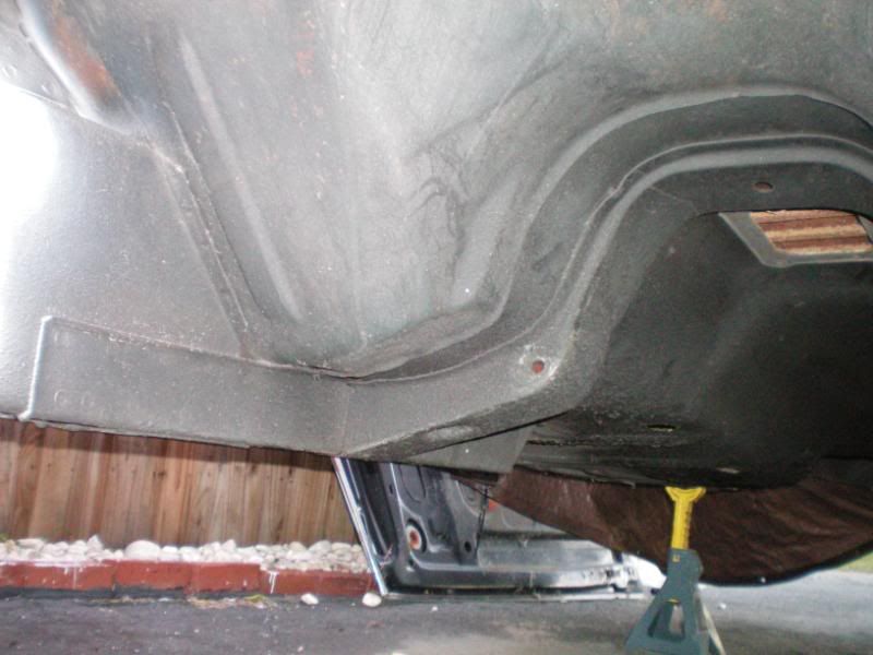

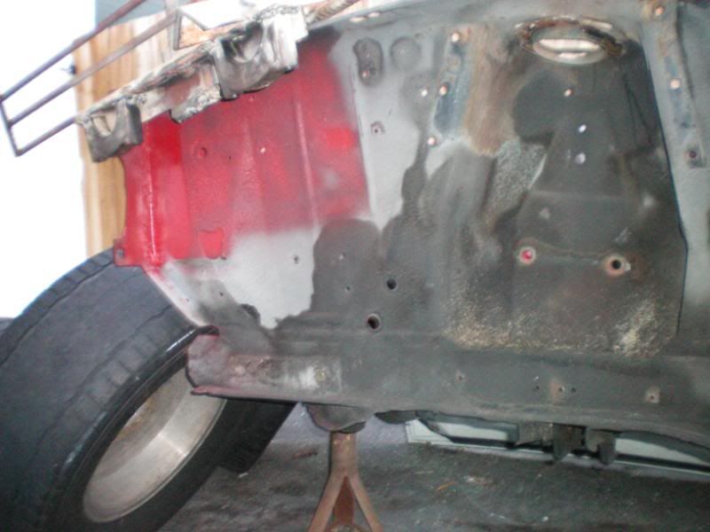

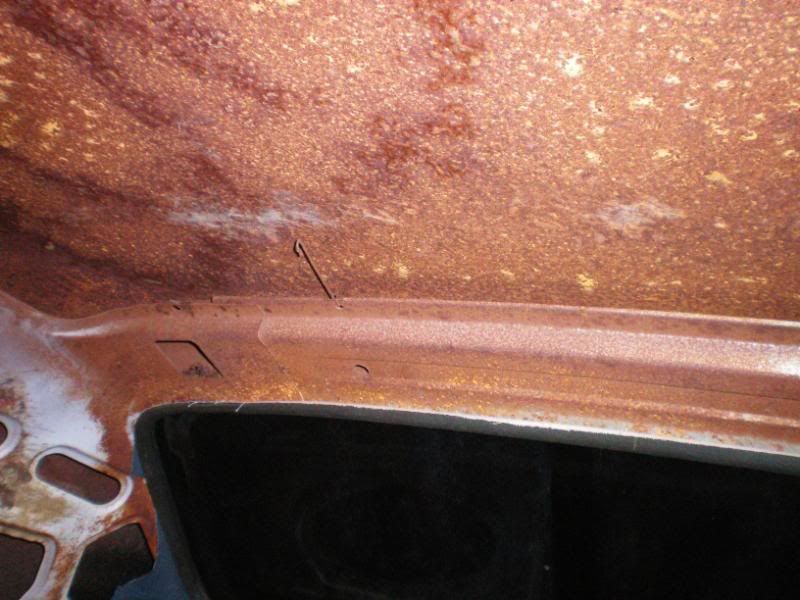

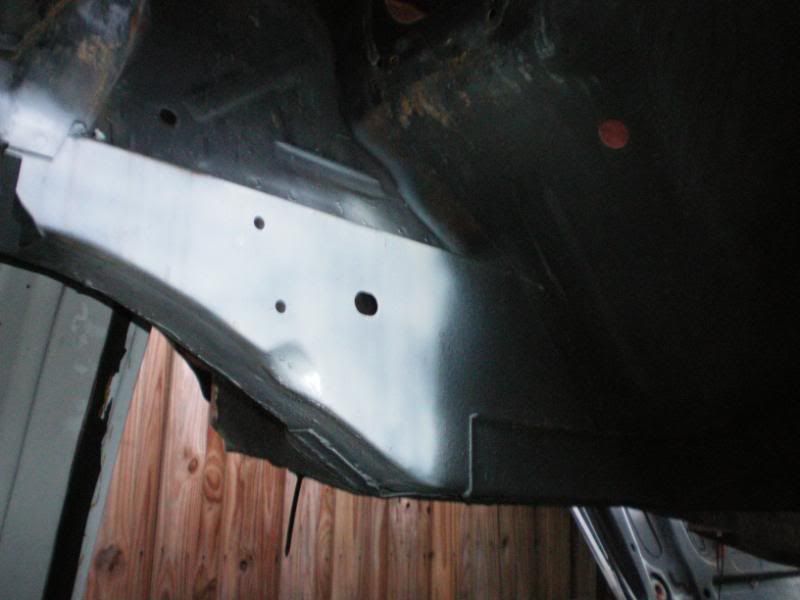

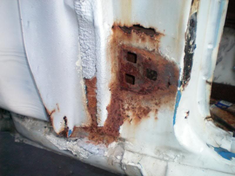

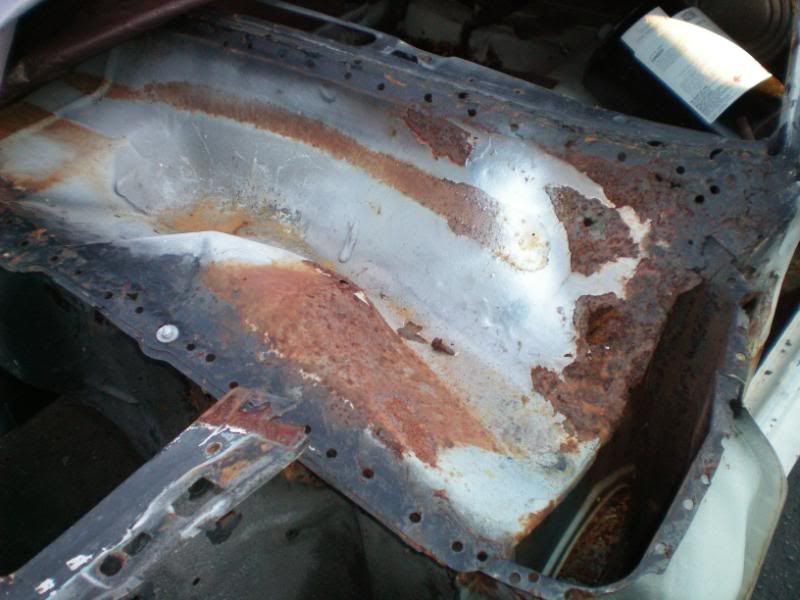

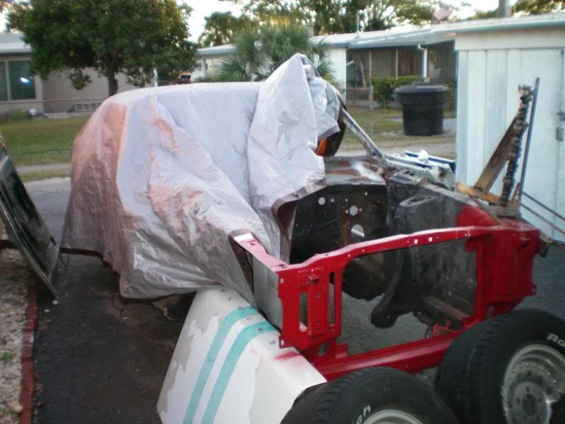

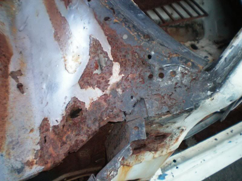

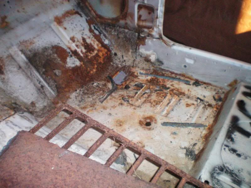

Yikers :(
Some of the frame blasted and primerd

Wow, lots of work there. I used the black 3M discs on my drill. Like them better than sand blasting, less mess and heat if you don't hit the same spot too long. Really, I did my whole 67 Camaro with them and a few wire wheels. Big or small wire wheels can screw up the metal so bad that primer won't stay. 3M's work great for derusting, not so good for paint.
