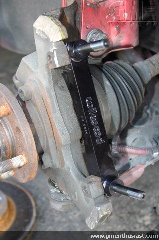

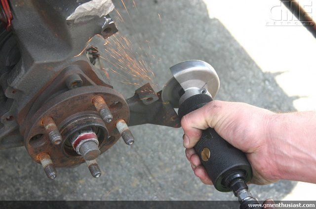

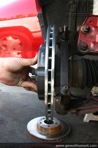

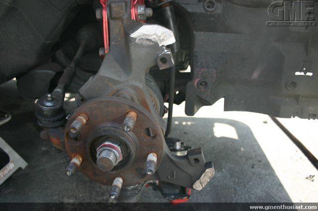

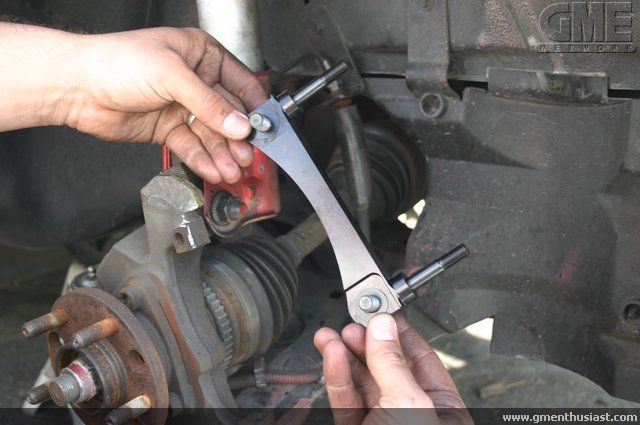

Um does this come with the modified knuckle necessary to bolt this up? I think the only mod is cutting off the ears that hold the pads but I can't remember now... I know the Baer kit had something else done.
It should just be the tabs being decapitated. Obviously the 'retta has the caliper on the rear of the disk but it should be bolt on. If I end up having to modify something, somewhere....I'll let future me worry about that one.
here's some pics, courtesy of J-body.org:
Re: Chevy Beretta FF
Ok, I thought thats what it was. Just checking because I remember the Baer kit you need to send them core knuckles to have them work on them.
PLEASE weigh the rotor though, I'm very curious to know how much it weighs vs a Camaro one.

Rotor is 10.8lbs total
Rotor is 9.6lbs
Hat is 1.2lbs
Amatuer, what offset is your rim? My 35mm offset rims clear fine but the stock gtu rims dont come close to fitting. The only other thing you'll need is custom brake lines.
I'm running a 40mm offset 16x7. if the fitting is too tight, then i'll just run spacers. I went to the junkyard today for a cursory look at the brake lines in a beretta and cavalier and they are exactly the same from what I saw. I'm just going to buy the stainless steel flex lines that wilwood sells seperately for this specific kit. It should just bolt on no problem.

Weba, the caliper will not clear under the GTZ rim. IIRC the stock GTZ rim has a 42mm offset and my OZ Ultraleggeras are 35mm. The OZs clear by 2or 3mm so I think your looking for a max of 37mm offset to clear them.
