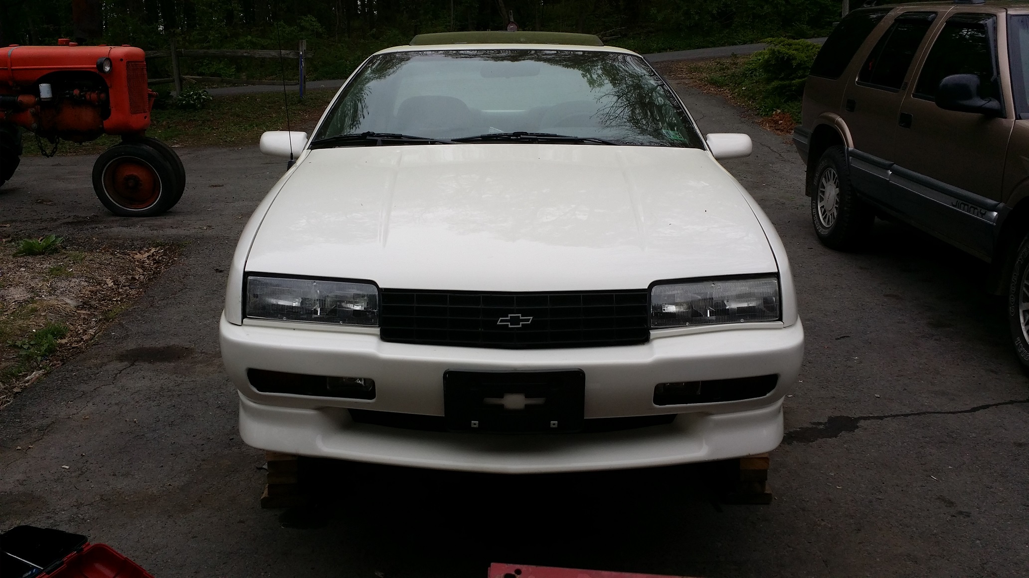

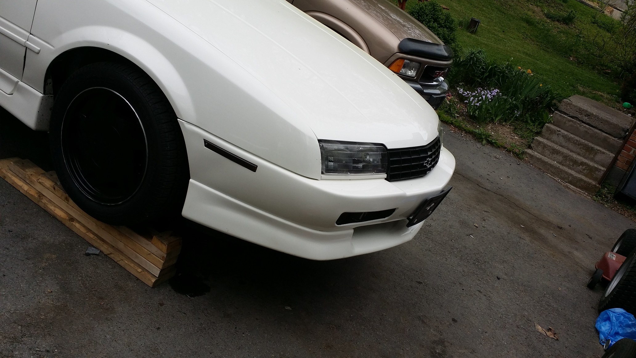

It's in pretty nice shape. Always get compliments on how it looks like new when its cleaned up. Interior is basically perfect excet the dash is starting to lift around the defroster vent now though. Very happy when I got the chance to tint the tails/fillers/side markers and plastidip the wheels since I was getting tired of the ugly cracked tails and the lack of contrast on it.
Original owner owned it most of its life and it was always garage kept up until I got it a few months ago. Hopefully the paint and interior hold up to being exposed 24/7.
That's probably more on the money. I heard 14.8s-15.2s depending on the magazine/driver but low-mid 15s seems much more realistic. I'll have to look around here and see if you have pics of your 90 gtz since I'd be interested in seeing it.
Wish I could find a picture that does the tail tint more justice. Looks much better and mirror-ish in person.
