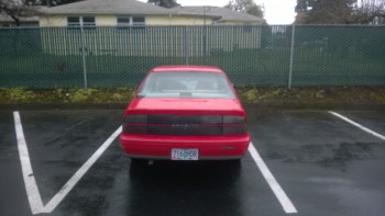

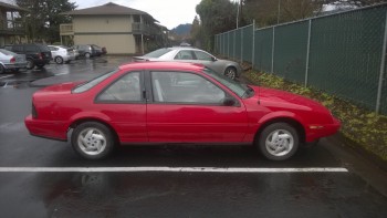

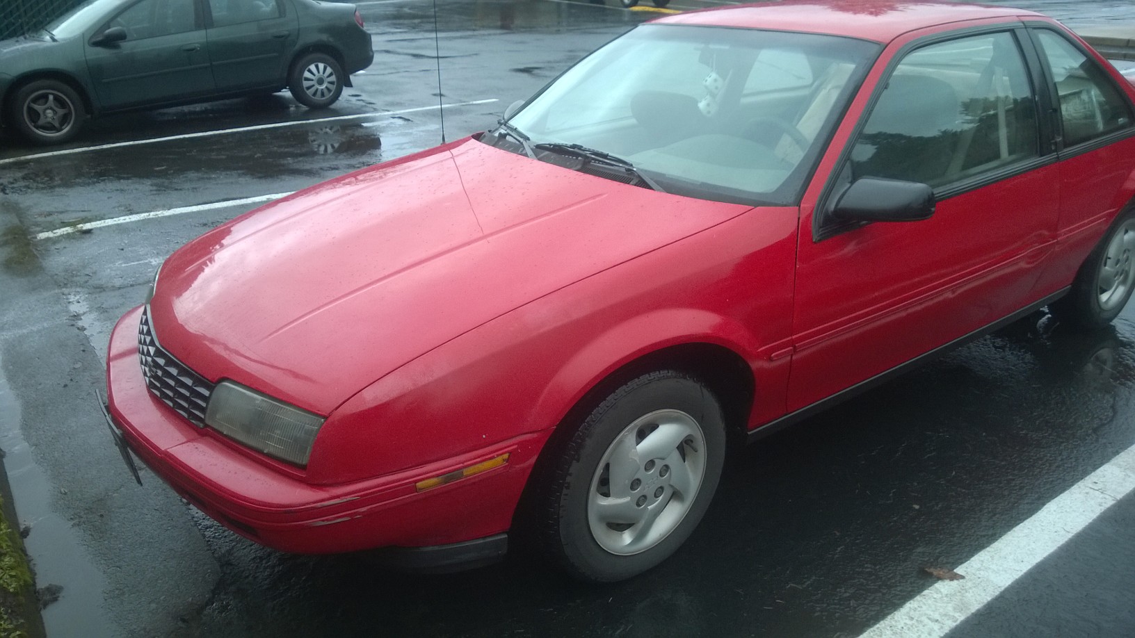

Postby SuperLbody » Sun Jan 18, 2015 7:54 pm
Here she is! Not the best pics as it rains non stop in the NW, but not too bad.
Posts: 6367
Has thanked: 2 times
Been thanked: 10 times
Re: 1994 Base
Postby Money pit Beretta » Mon Jan 19, 2015 7:27 am
Looks brand new! V6?

Postby SuperLbody » Mon Jan 19, 2015 11:19 am
Money pit Beretta wrote:Looks brand new! V6?
Yup, V6 and nearly every option except power windows and full cluster pack.
