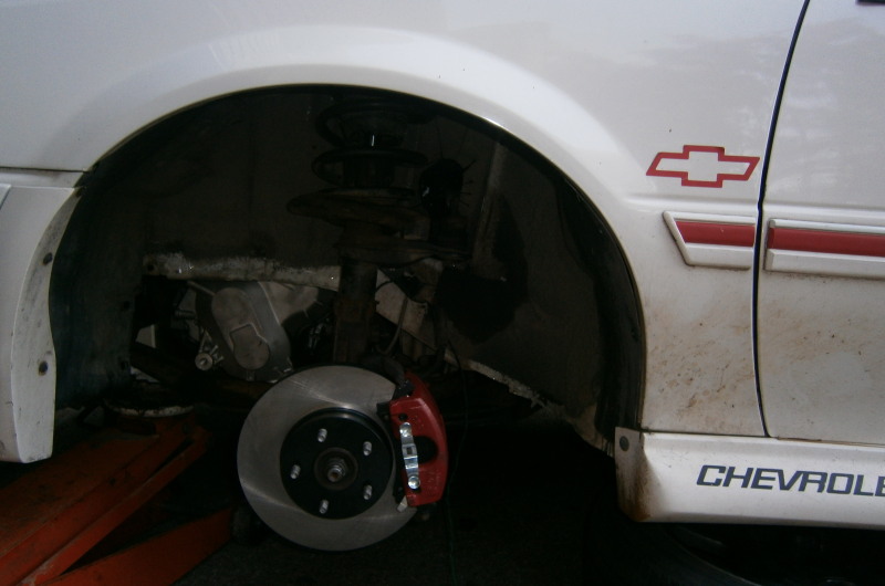

Noticed that 3000km driven new Clutch Slave Cylinder failed and leaks the fluid out.
Happy happy joy joy.. So easy to replace on internal slave transmissions....
