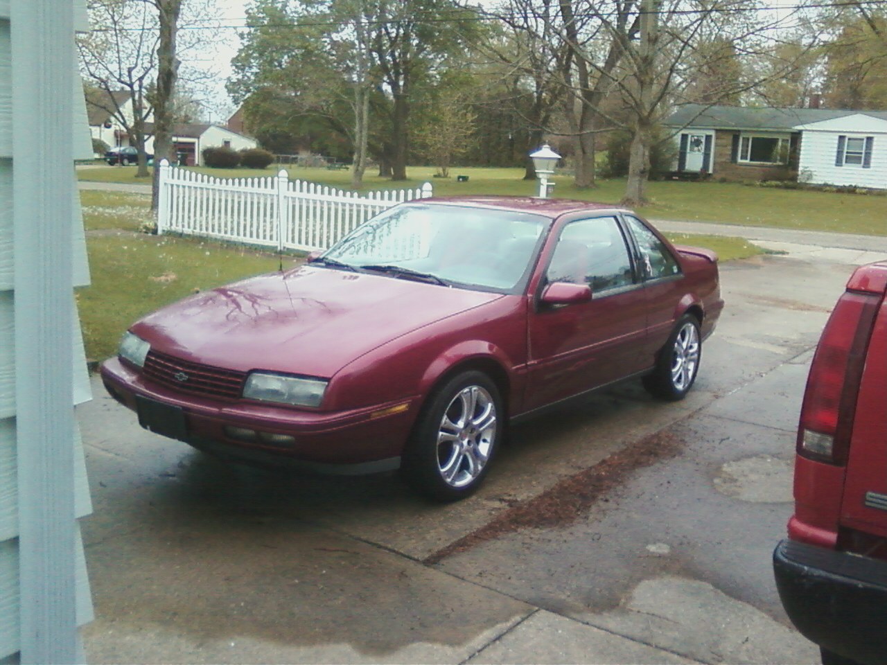

Postby EPfiffner » Thu Jun 16, 2016 8:04 am
Hey all, new member here. I had a '90 base back in the late '90s until 2000 when I had to have an s10 blazer (which I still drive today).
My wife and I were discussing how we needed better gas mileage and how we both had Berettas and thought they were awesome.
So I wake up the next morn and check CL and find this '93 GT. She was game to check it out so off we went. Dude was out in the middle of nowhere on a farm. The history of how he ended up w/ the car is sketchy, but we found the orig window sticker and some old registrations in the glove box. Car spent its life in Oregon & Washington until 2010. Being in OH this seemed a plus. I spent like an hour crawling in the mud and checking it out. Amazingly clean. The seller was trippin about how anal I was being but I didn't care. We took it home. Brakes were hosed, sound from front of engine (belt tensioner), soaked carpet. Until I found this site I didn't understand the magnitude of the wet carpet, many thanks for the info. I have spent the last 1.5 months going over the car, excited to get it on the road. Laid down the seam sealer on the cowl and firewall last weekend. Here's some pics the day after we brought 'er home.

Postby 1988GTU » Fri Jun 17, 2016 2:39 pm
that beretta is very familiar...

Postby EPfiffner » Fri Jun 17, 2016 4:01 pm
Thanks guys. @Woody, herpes, ha ha wondered why I always feel itchy around it.
@88gtu, someone on here has very similar rims as I recall. They let me title it so it must not be stolen.

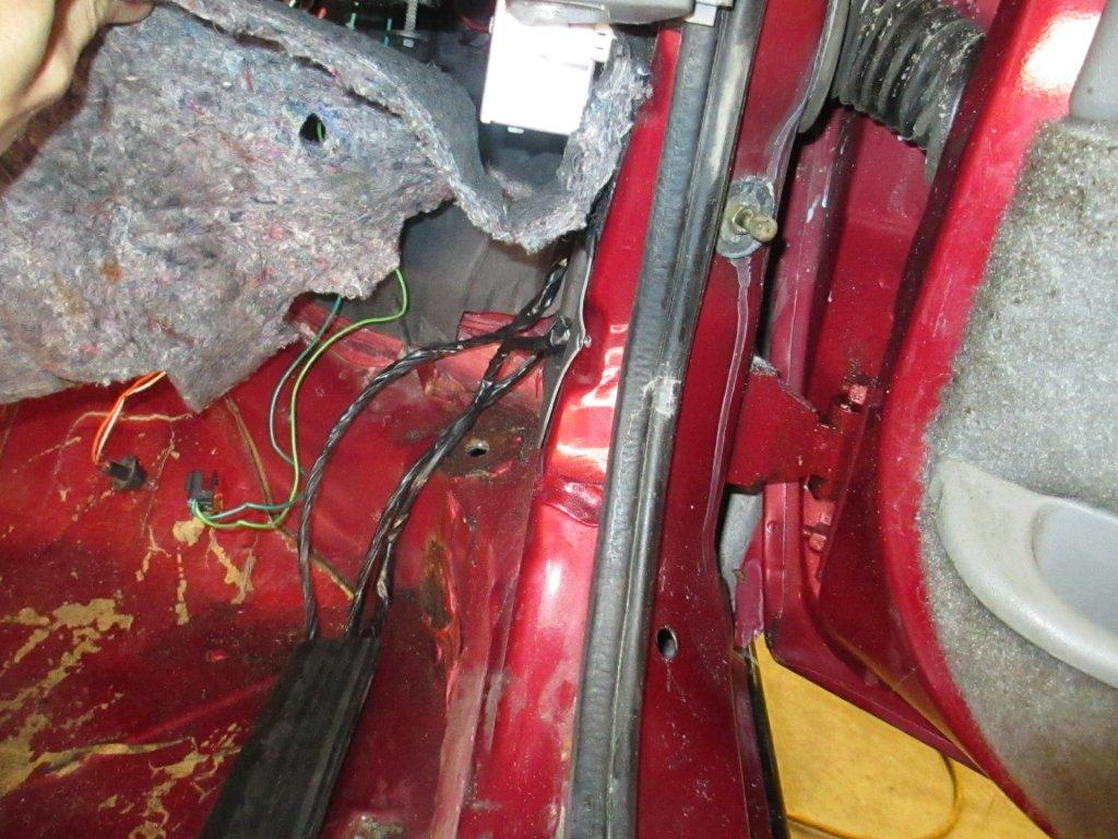

Postby EPfiffner » Mon Jun 20, 2016 9:41 am
I should have introduced myself in my original post. My name is Eric, I'm 40 years old, live in Canton, the pro football hall of fame city. Funny because I have no interest in football. I'm an electronic tech by trade, I work for genie company (garage door openers) in the engineering group. Wow sounds like a personal ad, sorry
Here's some pics of my efforts
I pulled the springs and gas tank out, blasted the perches, cross member, and surrounding areas. I sandblasted the fuel and brake lines from just behind the front wheel back to just behind the door under the rocker, knowing I was going to replace all from there on back (except the vent line, it looked pretty decent so I just blasted and painted).
Pretty tough to get a photo of the area. I used a paint called zero rust I found while researching, I brushed it on. This project is about longevity not aesthetics.
I blasted and painted the top of the gas tank, replaced the fuel pump, and used hard nylon for the pressure and return lines, joined them to the original lines mid-rocker with compression unions. I had never used this product before, but I stopped and asked a local mechanic and he highly recommended. At the fuel filter you can get short steel lines with the proper quick-connect crimp and the 16mm nut with the o-ring seal. You join the repair pieces to the nylon w/ compression unions. If I had to do it over I dont know if I would do it the same, its too piecemeal, but it came out very nice, all in the factory clips.
For the brake lines I used cunifer (nicopp). I joined to the factory lines mid-rocker with double flare nuts and screw together couplings. I don't know about the cunifer line either. It bends easy but I felt like the double flaring was way harder. My flares on the factory lines came out great but I had trouble with the cunifer. I didn't like that I had to use adapter fittings at the wheel cylinders and hoses either.
All seems well though, no leaks noted on my hoodless, drivers-seat only, no plates test drive. I did see a state trooper and miraculously he must have been texting or something so I got that thing home, put it away, changed my shorts, and decided it would have plates next time.

Postby EPfiffner » Tue Jun 21, 2016 7:53 am
This weekend I finished reassembling everything I had removed/dismantled to repair the cowl and firewall leak. Tricky job, it was in bad shape. Since the car spent most of its life in the pacific northwest I have to assume that is a worst case scenario for this type of leak. I pulled the blower motor housing (which required partially removing the rack and pinion to get to the one nut at the bottom), the alternator, pulled the engine forward, pulled the wiring harnesses out through both bulkhead connections. Good thing I did because it was rusted pretty good around the drivers side bulkhead. I pulled down the flanged end from under the dash and scraped/wire wheeled/cleaned everything and painted it with 2 coats of the zero rust paint I have been using. In the engine compartment I sandblasted the worst of it, and then scraped/wire wheeled the rest. It was bad around the hood release cable also, I basically had to glue it in with seam sealer which I'm not proud of, but I'll do a proper repair when its time for a drivetrain swap. These shots are prior to reassembly.
The seam sealer I used is Lord Fusor 804EZ. It is a 1part product that you can use in a standard caulk gun. 2 part product is excellent, but for this repair I felt that the 1 part would give me more time to work the product with an acid brush, etc. The other stuff kicks off in just a couple minutes so with so many obstructions in the engine compartment it would be tough.
I'll post up a couple pics of how it looks reassembled. I used black paint and grey seam sealer which is ugly, but the contrast allowed me to be sure I didn't miss anything.

Postby Cliff8928 » Tue Jun 21, 2016 1:54 pm
It's nice to see someone use an appropriate product to seal these areas and not RTV. I did a similar repair to my old GT years ago with 3M 1-part sealer, still leaked through the wiring on the passenger side. The newer years have a rubber boot over the wiring to seal out the water.

Postby EPfiffner » Tue Jun 21, 2016 3:59 pm
Thanks for the info on the flaring tool 3X00, I read about those and they definitely would result in a factory quality repair.
Cliff you know I looked at that passenger side harness and wondered if it would leak. It looks like they inject p!astic around the wires and then wrap the entire thing with tape. Mine doesn't have the boot but its good to know that's a leak point. I'm going to water test it prior to putting the interior in so I can always pull the harness back out and come up with something if I get the leak. Or just give up and live with it lol
