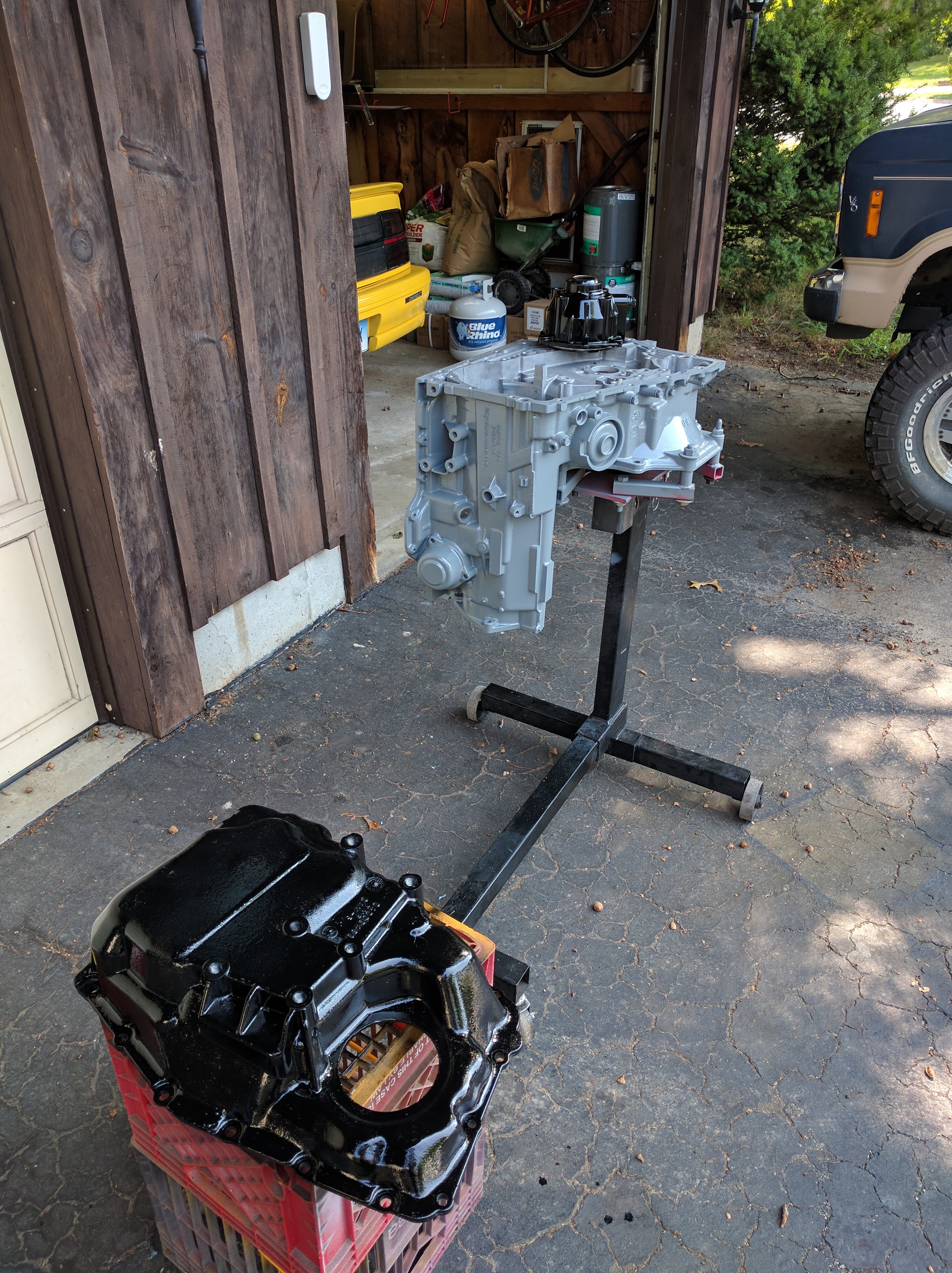

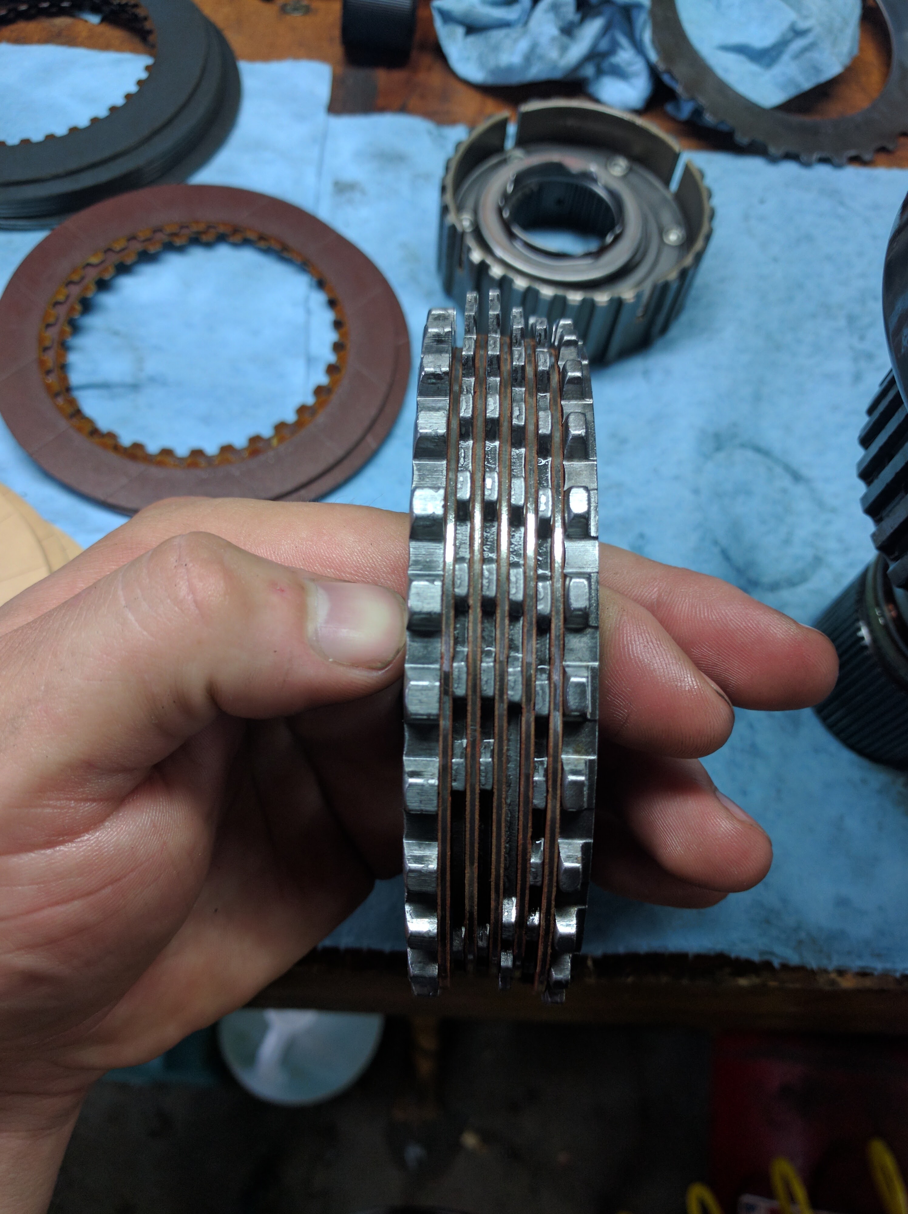

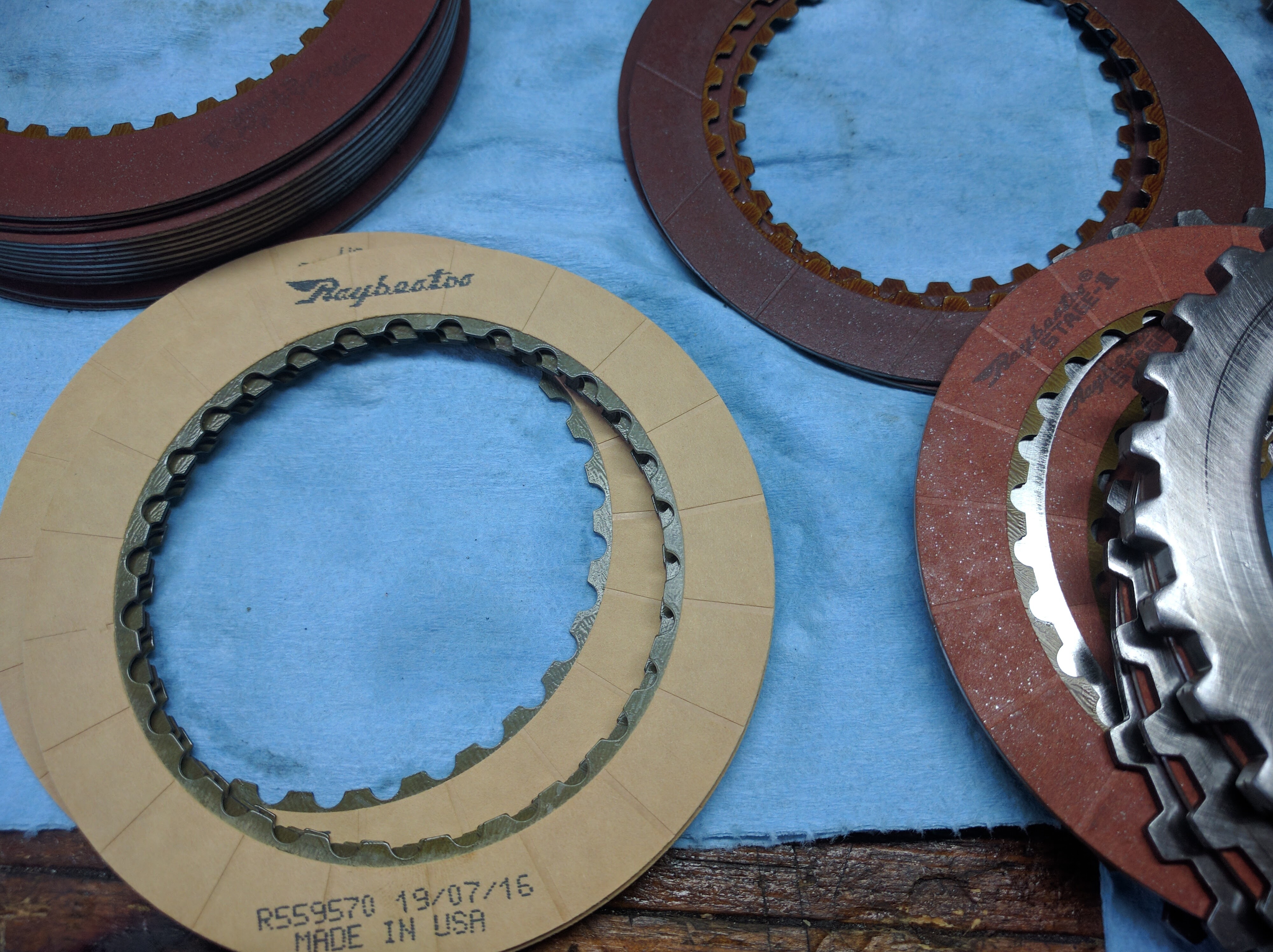

Postby 3X00-Modified » Mon Sep 12, 2016 10:00 am
Beautifying stuff... lol
Random clutch packs that I was assembling at the time... Have the option for standard paper for the input or the Raybestos Sage 1 Reds... I'll give the reds a try :) it will match everything else I have.
Removed the wavy spring plate to improve clamping force as well as added a 5th friction disc which improves the friction surface area by 25% of the existing.

i would never install that transmission in my car, exterior is way too clean, the internals must be faulty. :D :lol:
Posts: 10733
Location: Plainfield CT
Has thanked: 12 times
Been thanked: 48 times
Re: 1996 Mr.Pink
Postby 3X00-Modified » Mon Sep 12, 2016 10:34 am
You know I cleaned it and painted it simply because you said it was dirty right? At first I wasn't planning on re-painting it.
Posts: 1549
Has thanked: 3 times
Been thanked: 20 times
Re: 1996 Mr.Pink
Postby themixer » Mon Sep 12, 2016 12:51 pm
it actually looks good! i cant wait for you to come visit me, we will need 400 cans of brake clean and some industrial grey paint to do mine!
