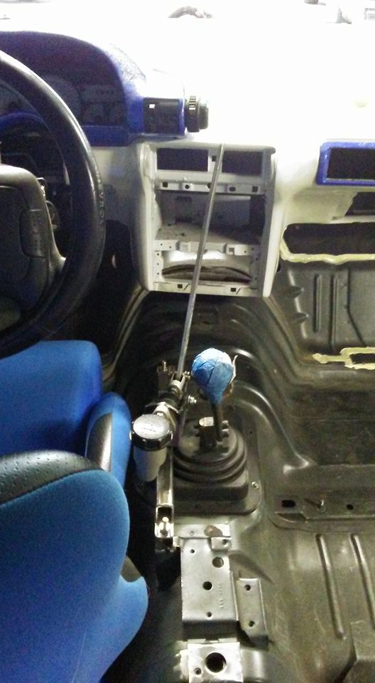

Postby jjanke » Sat Oct 22, 2016 4:05 pm

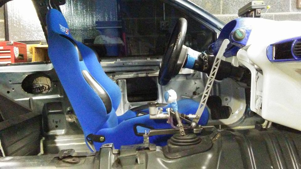

Still got some tweaking to do ....but placement should work well. Hydro E-brake mount done

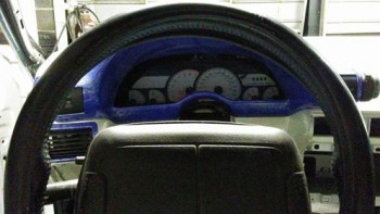

As always If it don't fit ....start cutting ....Camaro Gauge cluster in the Beretta IP/Dash

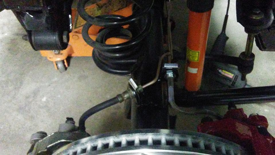

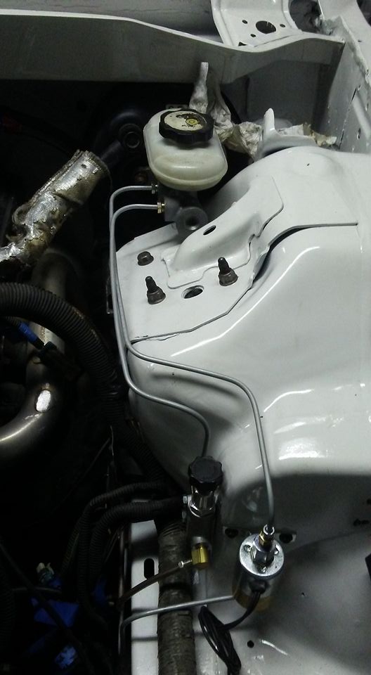

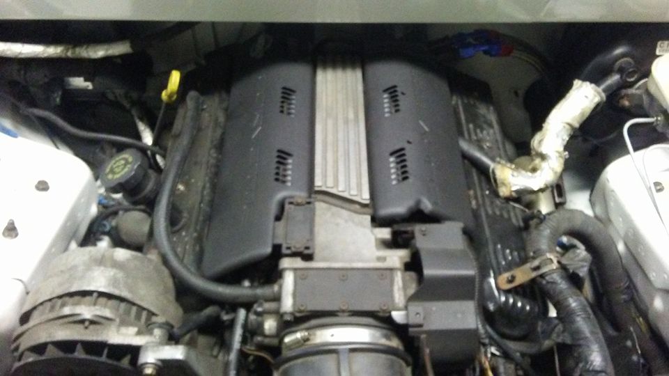

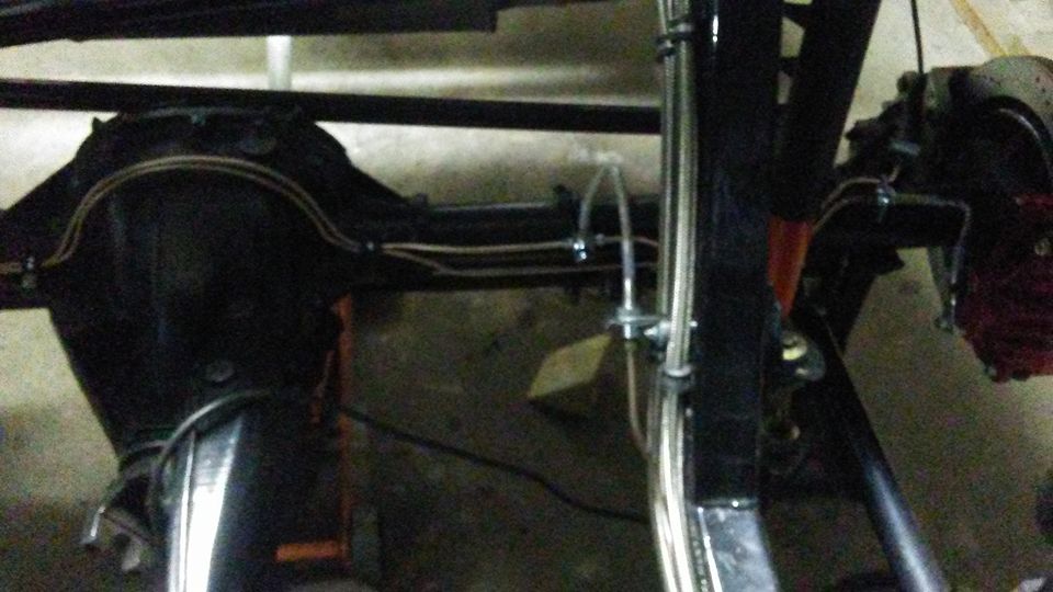

Postby jjanke » Sat Nov 12, 2016 12:13 am

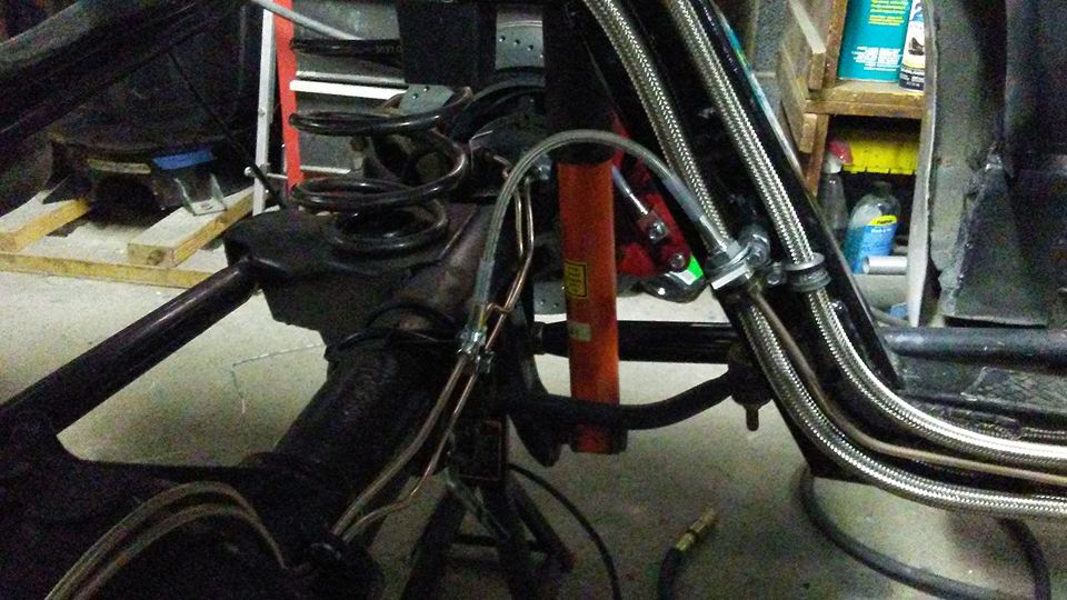

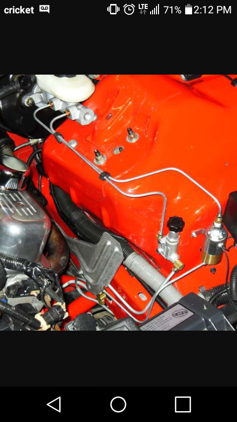

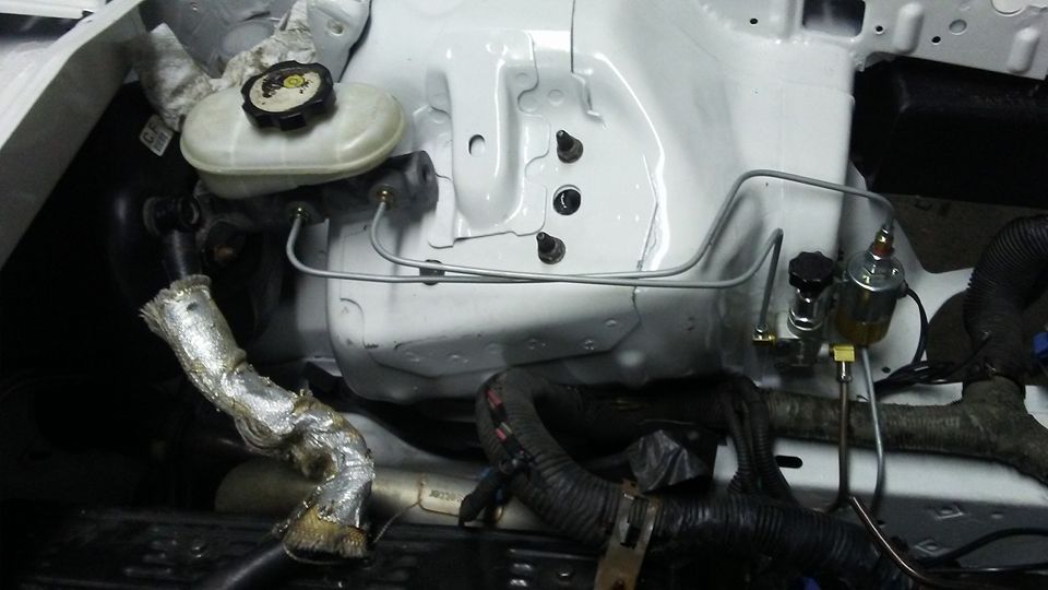

All brake lines and braided brake hoses ran. Abs delete with SJM performance front line lock and willwood rear proportioning valve. Just gotta get fluid and bleed. Also got the Corvette engine covers on to dress/ clean up the clutter on the LT1

Postby 1988GTU » Sat Nov 12, 2016 9:49 am
That looks as if it's touching the strut tower?
jjanke
Posts: 361
Been thanked: 5 times
Re: Beretta Z28
Postby jjanke » Sat Nov 12, 2016 1:32 pm
Yes....The master cylinder is very close to the strut tower.... but not touching....the fire wall may have leaned forward when I welded it to the cowl......it did clear so I didn't worry about it

Postby jjanke » Sat Nov 12, 2016 2:17 pm
That's kinda how the 4th gen Camaro are ..... everything is pretty packed in there

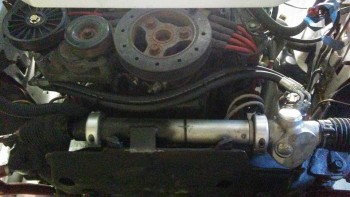

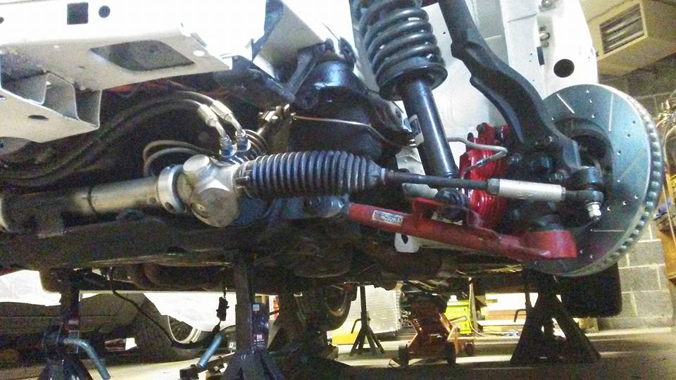

Postby jjanke » Thu Dec 29, 2016 1:58 pm

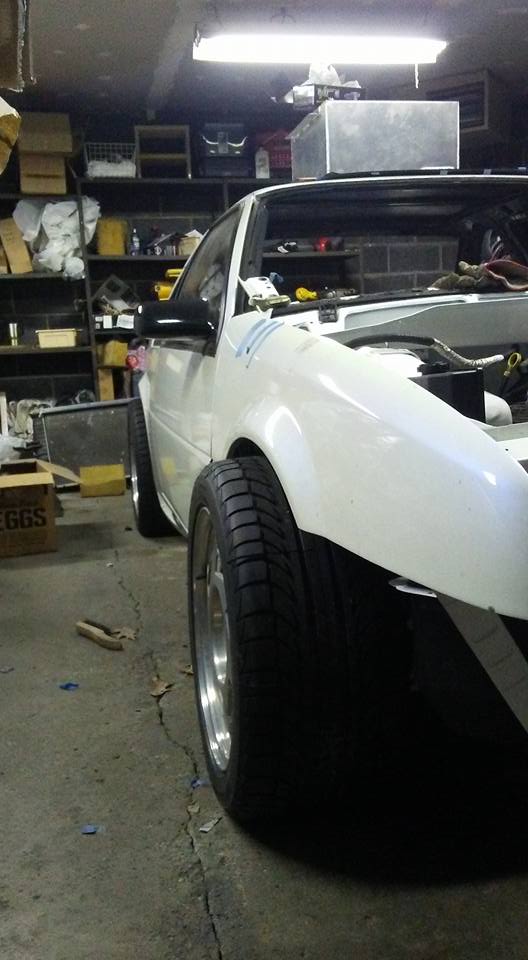

Progress has been slow lately as ive been working lots of OT and holiday stuff....... finally Worked out some clearance issue on the flaming river power steering rack spacer brackets and installed it hopefully for the final time. Rack is also welded to the cradle to prevent it from slipping. front steering / suspension is 99% complete for now...im really happy with how fast the steering is with this rack and knuckle setup... As u can see in the last pic. It's time for fiberglass widebody fender flares

If everything works out I will be able to 3D scan the existing body surfaces an recreate new wider fenders that have tire coverage.
Plan b is to continue cutting and sectioning the "universal" fiberglass flares which I started doing and haven't felt like it's what I really wanted.....But is an option
