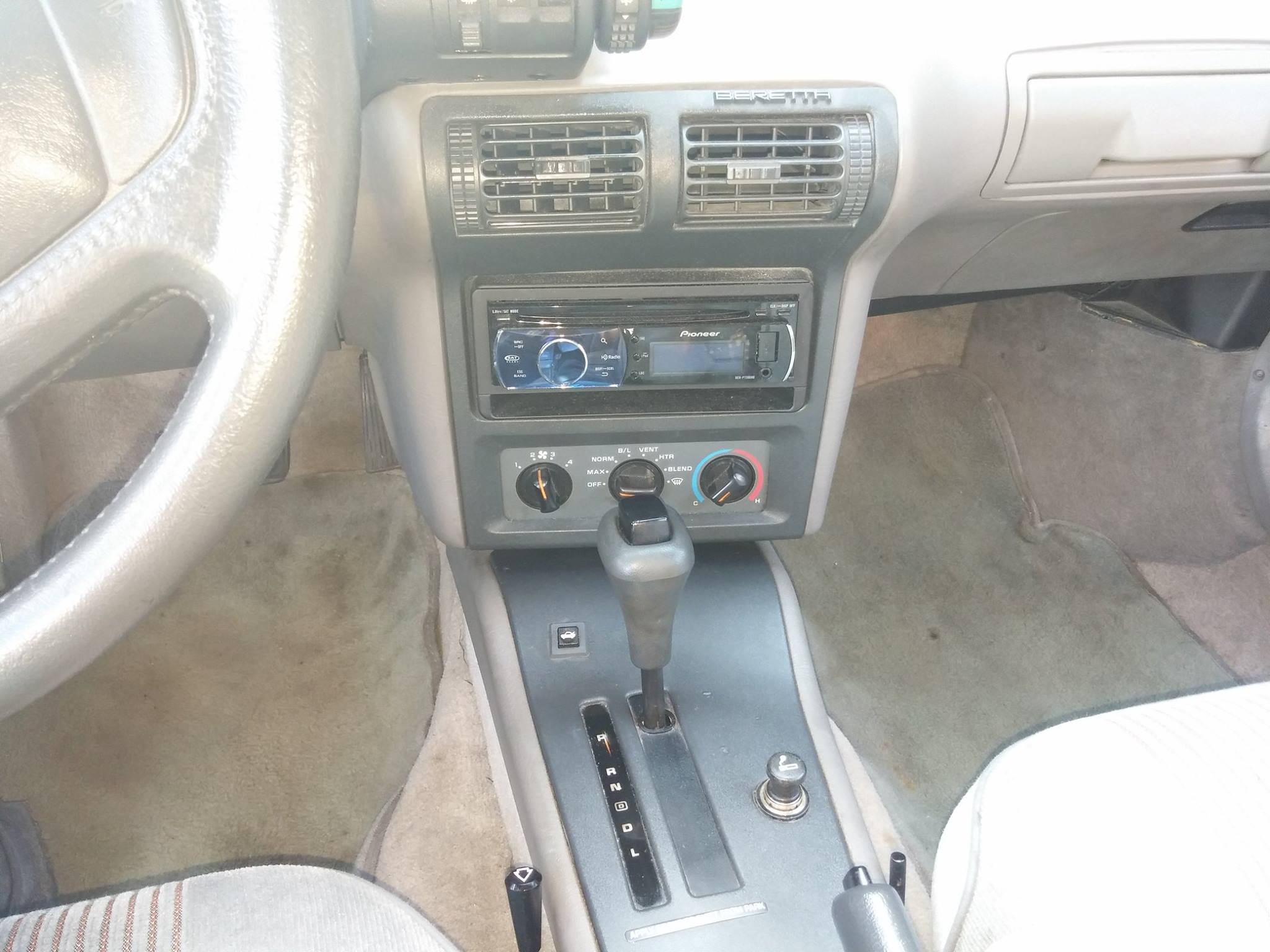

This is what I have in my 96 Beretta if you want to compare (More photos in the for sale listing):
Pioneer 25 Watt rms 50 watt Peek head unit, 4 outputs, Front L/R, Rear L/R.

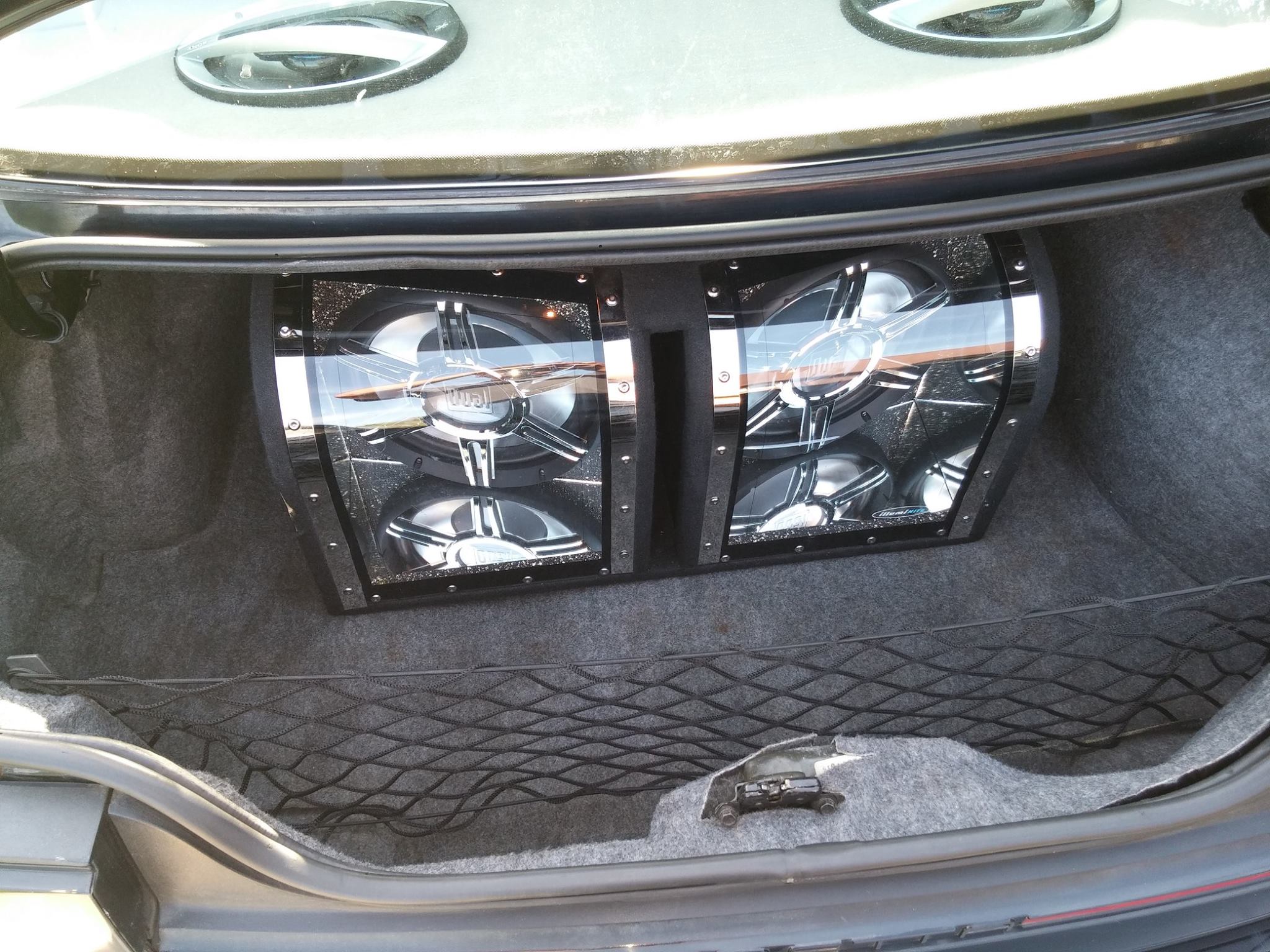

RCA cables to my Alpine Sub amp, 300 Watt RMS and about 600 Watt Peek if I remember right.
And two 12" subs, polypropylene and stainless cone configuration.
Gives great tone quality along the ranges, and hits the bass good. But I'm not trying to win competitions so its not over the top.
Works great on the stock battery and alternator, haven't had issues there.
I like it because I can change my settings in my Pioneer radio on the go without having to set amp dials, although my alpine amp does have Low pass, high pass, and boost dials on it but I never change those.
Something similar might be good for you, maybe a higher powered amp if you like louder bass? idk.
I spent about 900 on parts, everything was bought new at the time.
