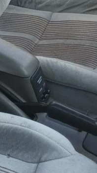

This is a zoom from one of my older photos of my 96 Beretta.
That is the newer switch design. Sadly I can't seem to find a clear image online.
Unfortunately these newer switches are not being reproduced. I think another member may havemade a adapter to attach the older switch on the newer car at one point, but I can't find that at the moment.

Re: Driver's side window stuck in the down position
Postby Exciter570 » Fri Nov 03, 2017 9:46 am
Yup, that's the same switch I have in mine. I found some used ones online. Going to take my chances with one of those.. It's too bad the newer style is not being reproduced and strange that the old style is when the newer is not.
