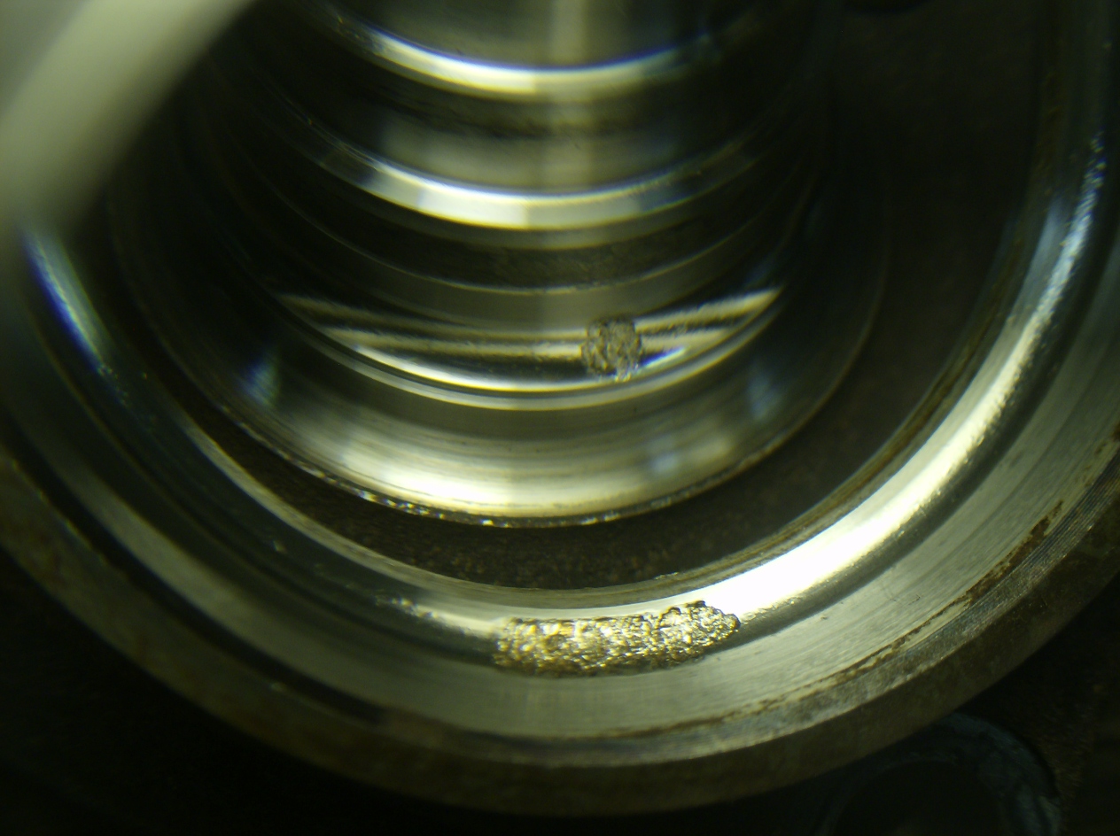

It's been about two years since I rebuilt the trans on my Lumina mini van. At that time, I replaced the original hubs with new since I had
over 150k on the originals. All has been well until my ABS started acting up. I inspected and found the brakes getting rusty on the inside of the rotors so I did a complete brake job, new everything. A couple weeks later, I notice a rumbling sound at certain speeds. It would start at 35 mph then fade and get stronger at 55 mph. It seemed to be coming more from the driver's side. So since the brakes were the last thing done, I thought it was something to do with that. We had driven on a road with fresh gravel and the rumbling started just after that. I read that the dust could foul up the pads and so I cleaned them and the rotors as well. It didn't help. I emailed the store where I bought the pads and asked if they had any other complaints. No was the answer but they were nice enough to give me new pads in exchange. The new pads didn't help. So I wondered about my new rotors. I swapped an old turned rotor for the newer one and it didn't help either. So I finally decided to try changing out the new hubs I put on two years and 12k miles ago. I first changed the drivers side and no more grumbling was heard. So I changed the other side as well as a precaution. The noise is gone but I still have trouble with the ABS which I will continue to sort out. But I wondered what the heck happened to the hubs so I knocked them apart. Here is a picture of the bearing race that has chunks missing. I have no idea what the heck caused this. They had plenty of grease left in them. The other one looked fine. I wonder could the gravel dust have gotten in and fouled them up or were they just cheap Chinese junk that won't last? Any ideas?

Postby 3X00-Modified » Thu Jan 04, 2018 8:14 pm
Well what brand were they? but that does just look like cheap metal that was not properly hardened for a bearing race which results in it crumbling apart.

Postby ifixalot » Fri Jan 05, 2018 9:47 am
I do not know the brand. I bought them long prior to doing the trans.
I don't know if brand matters anymore since everything seems made in China,
India, Taiwan Etc.
I bought them off Ebay as spares to have, when/if one failed so I
decided to use them when I did the trans.
Ebay doesn't keep your history that far back.
They are hardened in the area where the ball bearings ride.
I can't scratch that surface with a file.
I put it out there in case others have run across the same thing.
I'm going to assume it has something to do with either dust from that
fresh gravel road getting in or damage from a bad pothole I don't remember hitting.

Postby 3X00-Modified » Mon Jan 08, 2018 10:52 am
That's poor metal forming, it may be surface hardened only and the hardened part de-laminated from the rest of the metal. And yes brand still matters on quite a few things. Timken and MOOG seem to be higher quality than basics you can get on ebay.
