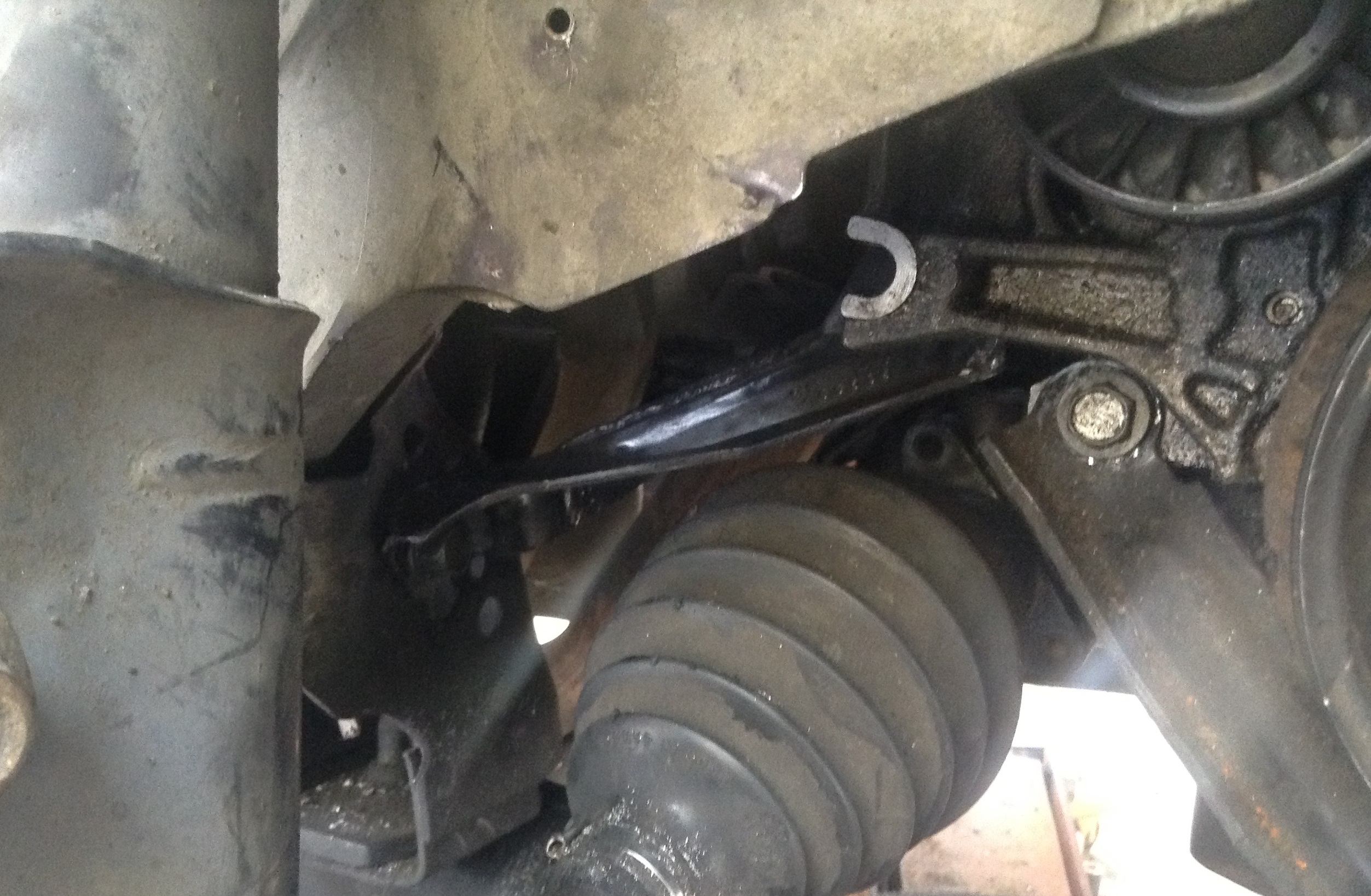

Wow, I can't believe you crammed that blown 3800 in there, I saw it in your sig, but I hadn't seen a pic. Impressive.
Re: Finally...
Thank you, that was actually the EASIEST swap/conversion I've ever done. It is tight, but fits well. Only permanent mods needed to the car are two holes in the right subframe, although I also added in the two-speed fuel pump control (not necessary, but nice) which also required cutting a ground-wire to the pump, and the side-outlets for the exhaust required trimming the ground effects, which were cracked in that spot anyway. In many ways, the 3800 fits the Beretta better than a 60-degree engine does -for instance, the heater-hose outlets are actually at the back of the engine, so i was able to delete the pipe running half way around the engine-bay... The exhaust was the hard part, mostly because I was going for a six-pipe "Hexhaust" all the way out (had several pictures of that back in the day, I did a full step-by-step write-up on the whole build back on bstuff before it died) which was way too loud (yes, six small mufflers CAN fit under that car!) and had to be rebuilt as a dual setup. The F40 six-speed swap I did in the car years later was pretty challenging, and I doubt I would bother again, although the ratio in my '06 tranny is nice on the highway. The tranny rattles horribly in neutral, due to the internal issues they were known for, and the lack of a dual-mass flywheel that could bolt-up to the 3800's eight-bolt crank.EPfiffner wrote:Wow, I can't believe you crammed that blown 3800 in there, I saw it in your sig, but I hadn't seen a pic. Impressive.
