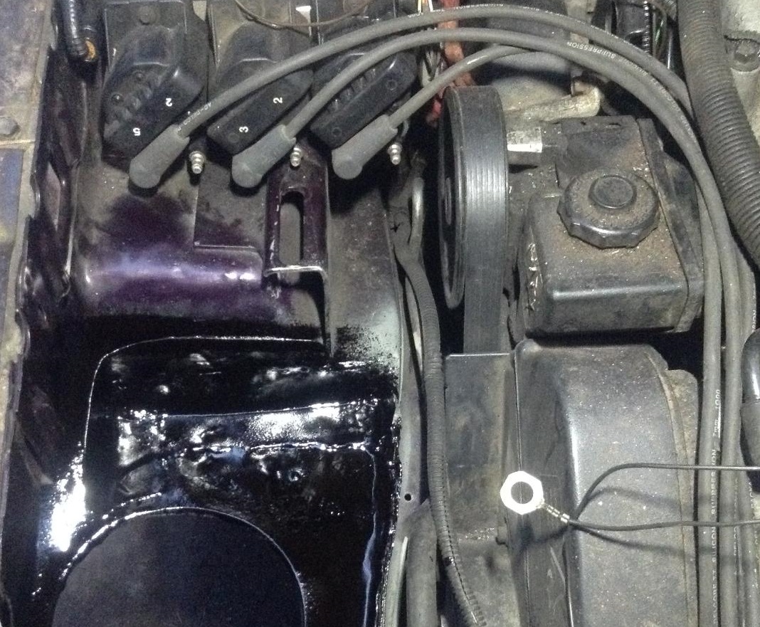

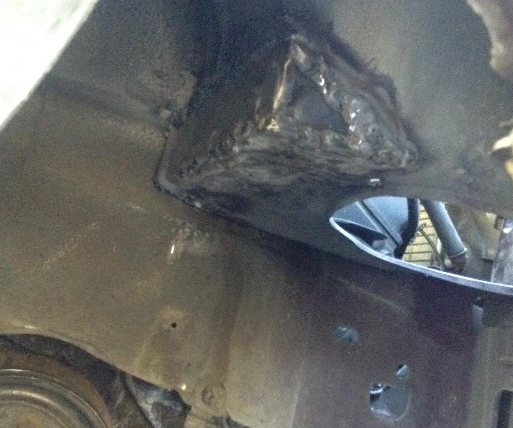

Battery relocated! The right side of the car is shaped a little differently in front of the strut-tower, having more of a gradual ramp up to the top of the tower. The left side has a steeper ramp up because it starts farther back, to leave a long flat spot for the battery. I love the idea of transferring weight to the rear of the vehicle for better weight distribution, but hate the idea of having to run massive cables the whole length of the car. So, I modified the space in front of the right strut tower to allow enough room for the battery to comfortably snuggle in there. I still have to place the coolant expansion-tank elsewhere in the bay, but I don't see much trouble there, and may even do something cool for it instead.
I started out building an actual battery tray out of stainless steel, but it is such a tight fit it just caused problems. So, I just grafted-in a small corner piece instead. There was about a 1.5 inch gap created in the steel, to give an idea how much the metal had to be moved to make room for the battery. Given the usual corrosion issues that batteries cause, I am glad I listened to my own complaints and upgraded to the stainless for this part. I then primed the whole area, and topped it off with rubberized undercoating. I also applied a generous coat to the underside, where it could be exposed to water. I am actually pretty happy with how this all turned out.

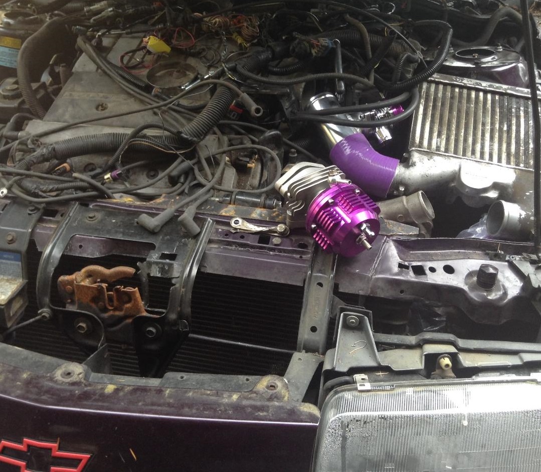

Snapped a quick pic of the exhaust parts and turbo pieces. I had intentions of running two 2.25-inch pipes out of the muffler (single 3-inch in, dual 3-inch out, would use a pair of reducers like the one pictured with the muffler to bring it down. A single 3-inch pipe flows more than two 2-inch pipes, btw, so I was going to go 2.25-inch to keep restriction out of the exhaust) over the axle-beam, then to the rear as semi-duals, but the muffler body is too long to fit in the catalytic converter cavity, so the exhaust will just stay 3-inch single to the rear, with the muffler mounted in the stock location and splitting from there (I waited to buy the smaller tubing because I wasn't sure the Flowmaster would fit). My old '95 Z-26 will be donating its' exhaust-tips (slightly reworked to mirror the stagger originally present), so the car will have four total outlets, with a factoryish look. Not certain what I will put back on the old Z yet -I would like to use a single large rectangle, but I'm not going to put any money into it right now, it runs and drives nice but needs so much work I'm not sure what I'm going to do with it yet -that is for another thread though.
Yes, the waste-gate, bypass valve, and silicone intake fittings are all purple, as is the exhaust wrap and even the silicone radiator hoses are purple -hey, the car is Black Rose Metallic, which is really just a super-dark plum color, so it fits.
I am overall really happy with how tight the intercooled intake setup is. It all stays inside the bay, nothing running back and forth across the car, nothing in front of the radiator core-support. Clean, short, compact.Yes, the waste-gate, bypass valve, and silicone intake fittings are all purple, as is the exhaust wrap and even the silicone radiator hoses are purple -hey, the car is Black Rose Metallic, which is really just a super-dark plum color, so it fits.

Remember where my battery USED TO sit? It is a 'snug' fit, but it is a fit. This is a little better pic than I posted on page 1, as this is the actual turbo going into the car, but I was still waiting for most of the silicone elbows and fittings...WhiteGTZ wrote:The intercooler is not in front of the radiator? I am interested to see how you had space for the intercooler in the engine bay.
This particular Blackstone intercooler has a small footprint, but a very thick core, so still gets a decent Delta-T despite its' size. I'm not going to be running high boost levels, so I'm not too concerned with having a massive intercooler either. The biggest problem of course is feeding cool air to it inside the bay. If you know how I set up the ram-air on my '90 Turbo T Beretta, that will give you a sneak-peek as to my solution here too...
It was a bigger issue to fit an air filter in there with this thing and the required MAF. I really didn't want to run a 3.25-inch intake pipe in front of the wheel-well splash-guard and up in front of the radiator (or under the headlight) just to place an air filter or air-box in a semi-accessible location, and I wasn't going to put an air-filter directly in front of the splash-guard where it can't be serviced without removing the wheel. I wanted this all in one place with as short an intake run as possible into the turbo.
Come to think of it, this is the second time I've put an intercooler under the hood of a Beretta -back when my '90 'Retta still had the LG5 and its' original T-25, I relocated the battery behind the engine nestled into a customized heater-duct plenum, and stuffed the intercooler in that spot. But the air filter was a tiny K&N cone clamped straight into the front of the turbo, no MAF, no external waste-gate, no BOV or bypass valve, and the biggest pipe was about 2-inches in diameter. That thing spooled at 1800 RPM, and was an absolute kick-in-the-pants fun to drive though. The FMIC it has now is definitely a better way to go for that particular car, but yes, it has intake piping running back and forth across the front of the car.
So yes, not only can this 3.4 DOHC fit in the Beretta bay, but it fits with a T-04 turbo, an intercooler, ALL of the intake ductwork and air filter, the ECM, original cooling fan, retains all of the ABS system, AND still keeps the battery under the hood! Lets just not talk about Air Conditioning...
