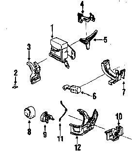

Wow i sure didn't know that ALL of the mounts are different.. this really changes my 5spd swap plans if i need to move the whole drivetrain... how can i do that with passenger side upper mount, or is the T-piece different on auto\manual?
edit: found it allready from parts catalog
http://www.beretta.net/how_to/b-tech/pa ... t31-1.html
http://www.beretta.net/how_to/b-tech/pa ... nt31-1.gif

Is that what it is? The T piece? But that still doesn't help the fact that heavywoody has to use 3100 T piece...

Hmm... I'm going to have to scour the yards hardcore to find a 92-93 5spd setup... I never messed with my upper mount stuff, just added the poly insert. This might help eliminate axle breakage.
I'll go to the dealership and see if I can get better pictures than what's offered on the BNet website.

Thinking about this more, you could get a 92-93 upper mount for a manual, and use the aluminum T from a 94 3100 and it should bolt up. That should move it back 1".
The 95-96 style is better with the top piece and holds the poly insert better though. The 95-96 T won't work on the 94 or older mount though.
EDIT: Maybe the 95-96 4banger manual mount is 1" back and like the 95-96 3100 style? If so that would be the best route with the 3100 95-96 T.
