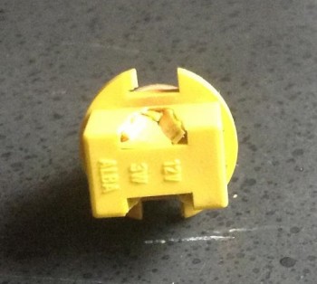

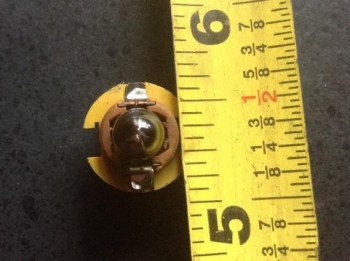

Markings on the bottom of the smaller-type bulb 'socket' says "12V 3W ALBA", so obviously 12-volt 3-watt to start with. Socket hole is ~3/8" diameter, plus the little tab-holes on either side. Interestingly, the original bulbs are soldered to the socket's contact-tabs. The plastic of the socket is really brittle from heat and age on mine, obviously. I searched a little, and found nothing comparable. You could TRY a PC37, it might fit, but it won't be bright enough. If you can solder, you could either direct-solder some 194 bulbs to the socket-rail in the cluster, OR install some LED strip-lights along the bottom instead. My '88 Katana 1100 was modified with the strip-lights, looks awesome, more even lighting and has that LED 'cool' white look.
Brittle plastic didn't like my pliers!
About 3/8 inch hole -just under the 194 bulb's diameter.

I can solder, so that wont be an issue. I have some of the green and blue ones that were too large in there right now with wires running to power. It does look good. What I might do is connect an RGB led strip I have into there. That might be really cool if I can get it to work. But I might just solder some lights in there. Ill have to wait until the rest of my LEDS come in.
From some other research, I believe they are the 74/T5 type. Ill have to purchase that and try those. They seem to be the correct 3/8in size.
Also seems to be 37/73 So you were correct before with the 73 and are still correct with the 37
