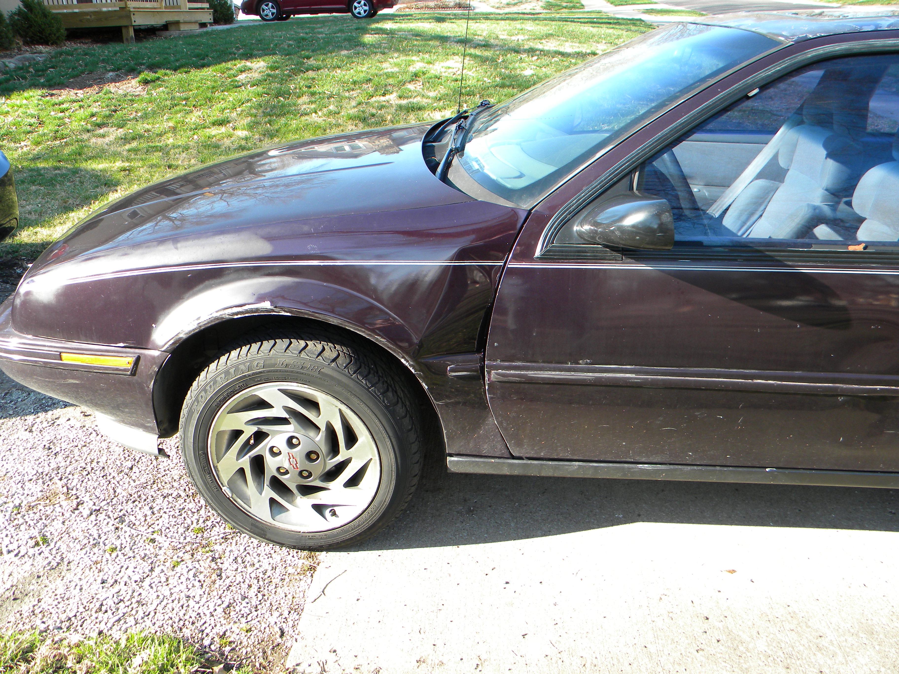

My car got hit on the driver's side front fender. Not my fault. Going to need a few parts and help finding others. Will be trying to repaint the whole car, so will need everything that goes with doing that, window trim is one thing. Not fully sure what all is needed for that.
So far the shop has not told me what needs to be replaced(may have to change shops). On my own I'm searching for a left front fender in purple (base metallic rose). Having a bit of trouble getting replies from car part.com. Replacement Z26 wheel is on the way.

Ok have the car. Looks like the ball joint is bent on the passenger side. Plan is to replace everything if Moog still has all those parts. Drivers fender is trash, but could be bent out to get me by(will post a photo sometime). Think that the fender support bar is bent because the bumper is a little off. For now that seems to be it.

Ok, from what you say I'll need to find some push- ins for the plastic part of the fender well. The apron is falling apart, so it may not be replaced at this time. On the wiper switch all you have to say is that it's in good shape Rettax3. Known you long enough to trust what you say.
Going to double check the mirror housing this weekend. Pretty sure it is ok. Not so sure the studs are though, we will see.
