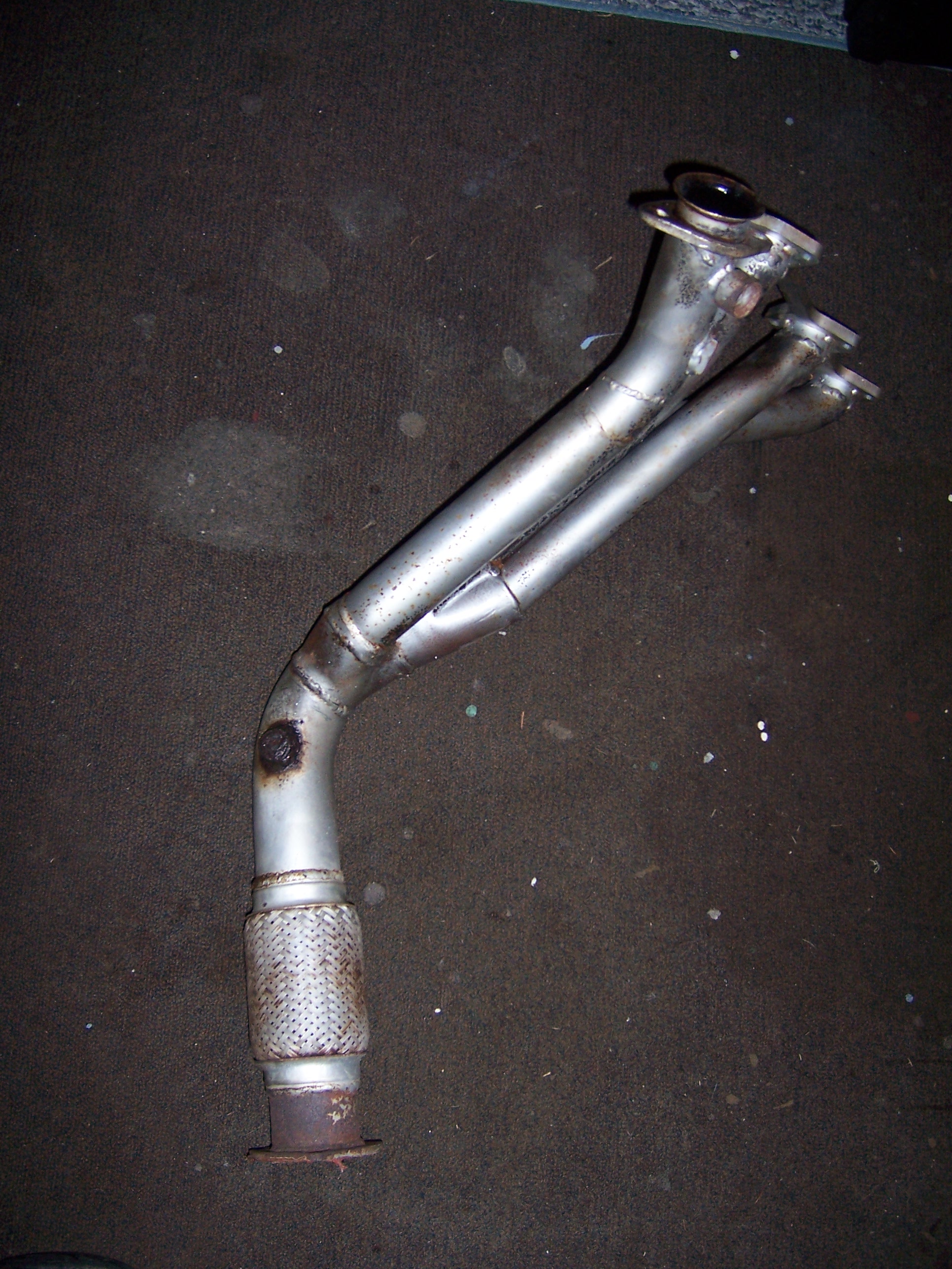

This fits a 3400 4t60e and 3400 5-speed combo (after grinding bellhousing on 5-speed)
The 3t40 needs some more work on the #1 cylinder.
Here are some pics of the
modifications I had to do to the S&S headers to get them to fit my car... Also pictured is Erics unmolested set... which will soon receive the same treatment.
A few notes of things I did was cut all three tubes at the back flange and bent the main
header down further to give it a sharper angle, then shortened and angled the last collector in the opposite direction so it wasn't aiming so far down. And lastly re-aligned the cross over pipe again.
Completed
header
Last collector cut and weld.
Cross over hacks, It could have been done it one cut on each side but since I didn't have both on the same motor it took me two or three shots.
Bottom of rear down tubes.
Angle of mine
Comparison to unmodified... the rear flange does angle it a little more too since its not flat.
Collector comparison
collector flatness comparison.

I know this pic had been done before but it was with a manifold and a S&S stock to compare... here is the
header that works and a factory S&S so you can see how much I modified it down to fit.
All chopped up!!!
I had to add 20* to get the angle right.
They don't call it a 60*V6 for notin... LOL
What I started with
Right now the tubes are welded back up and set for a 60* angle on the mock up motor. Remember that's not a definite measurement, that's what it ended up being after I removed the DIFFERENCE... That's all you need to remember and tweak for.

Jon did a GREAT job modding mine, and the 3t40 additional change is just some "persuation" a few inches down #1 pipe, approximately 6" long.
I will post a pic when they are off over the winter if no one else beats me to it, although I may have the ONLY 3t40 set, LOL.
Unfortunately mine had to be "persuaded" after they were ceramic coated. At least you can't see it back there.

The modding for the Pace setters is pretty similar...
Cut the back one at the flange and algle it just a tad over 20*.
The crossover pipe has to be compleatly re-made.
Front header needs no work. 5-speed bell housing needs a grind, looks like it will clear the auto.
OPSU needs to be re-located, need to swap in a 96 fan.

Barry wrote:The modding for the Pace setters is pretty similar...
I guess there is a good reason why I went with the S&S ones... My OPSU is in the same spot as stock, just has a sparkplug sock on it to protect the wires, and I also put a sock on the closest heater core line. I didn't have to move one other wire.
