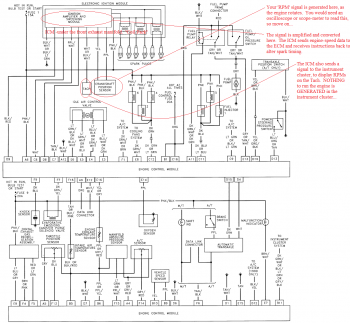

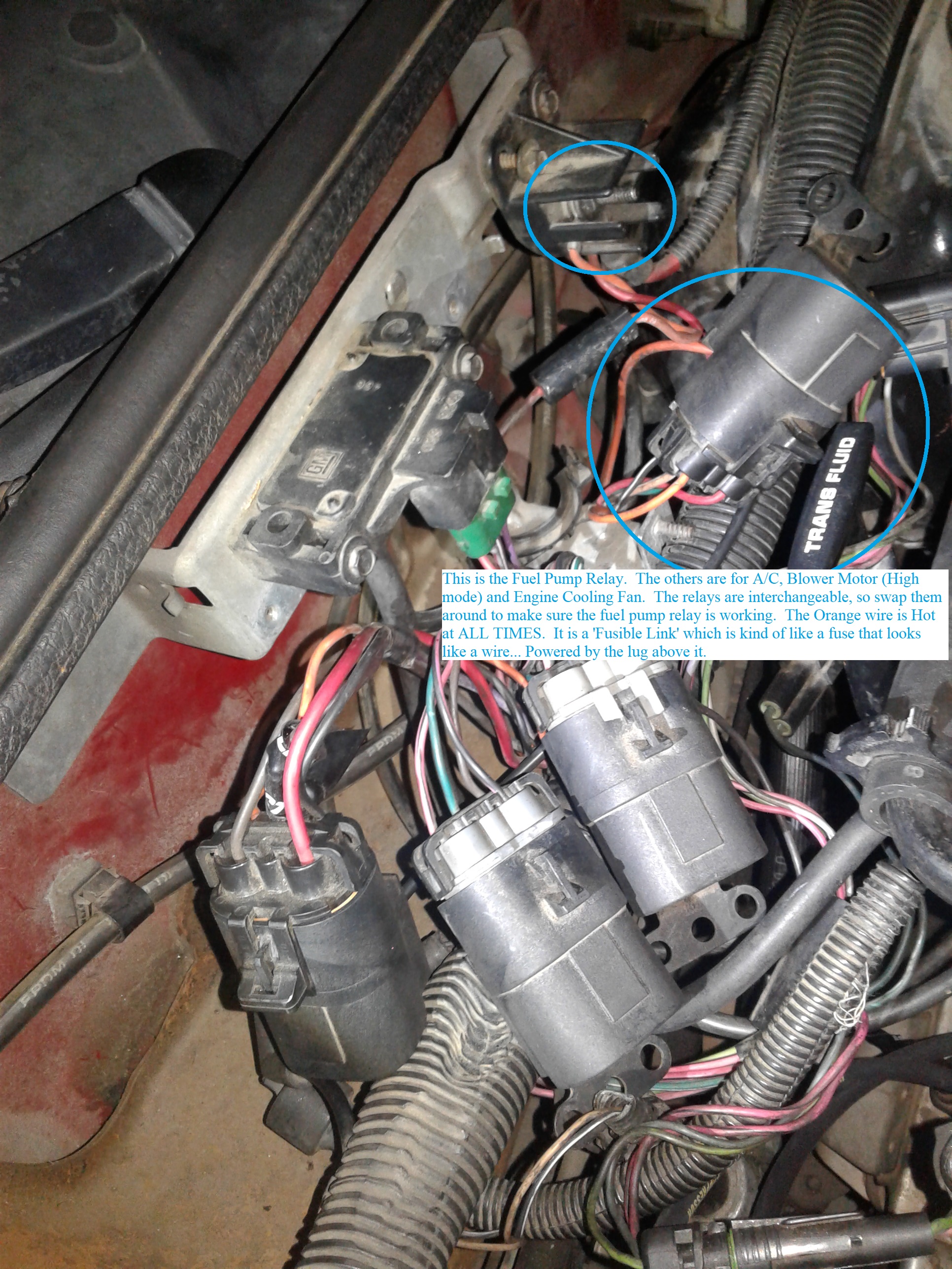

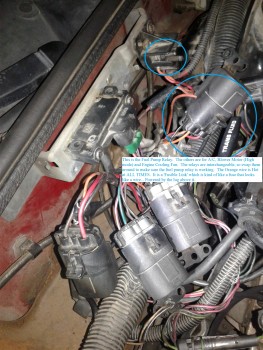

Where does my RPM signal come from??? And if anyone has wiring diagram?? And can I test injector pulse for pcm or injector connector??
Re: Need help trouble shooting
Fuel Pump Relay... PM replied to regarding RPM signal, I strongly recommend getting a Chiltons or Haynes service-manual for your car. You can clearly do the work, but without a guide to give you specifics, you are shooting in the dark, especially on diagnostics. Newer Chiltons (showing a red Corsica on the cover) have better wiring diagrams.

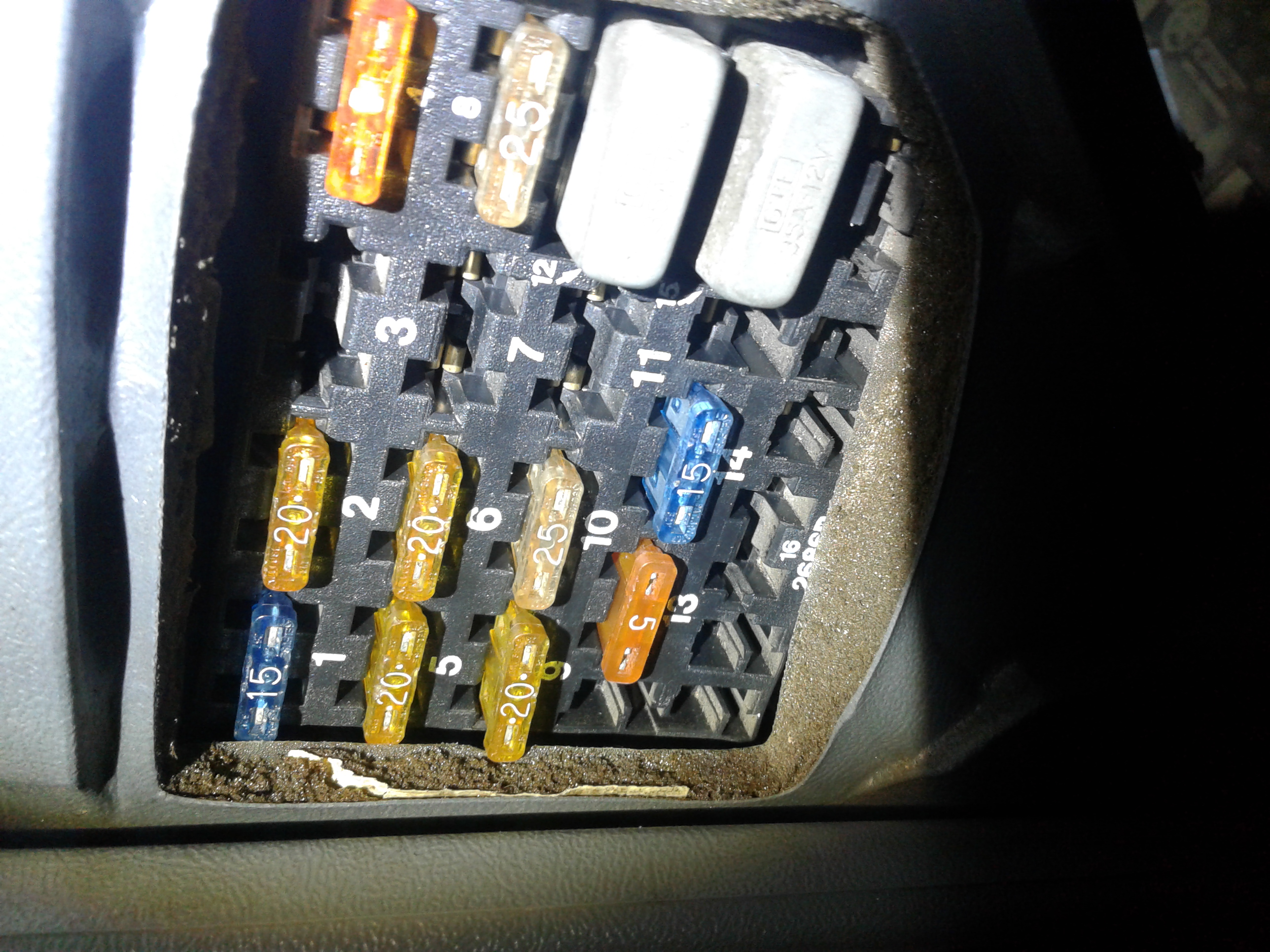

#13 in fuse panel is a 5 amp fuse when car first started problem tested all fuses this one fuse wood only work on one side until I wiggled it, now I don't get any power to it with key on or off, this Keys goes to my instrument cluster which I think is where my RPM signal is. So how would I look that up what kind of diagram would I be looking for from the fuse panel out, it's a green and a gray or white wire, where do those go?? Or come from??
The attachment 20200221_180718.jpg is no longer available

This should help you figure out where and how the car gets its' engine RPM signal from. You CRK or Crank 5-amp fuse does not run anything, it simply tells the ECM you are cranking the engine over so it knows how to adjust fuel and spark trims -it should only have power while holding the key in 'start' as I recall. Removing it might make the car harder to start, it won't prevent it from starting or running though.
