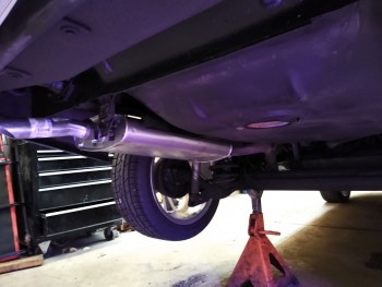

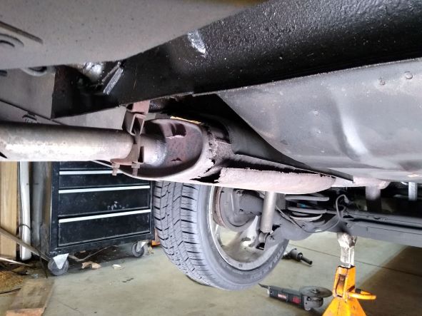

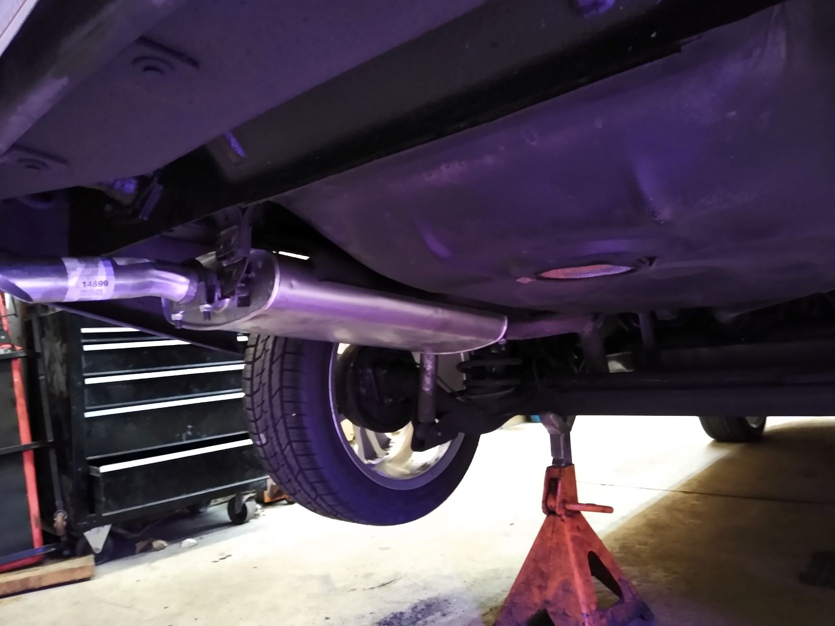

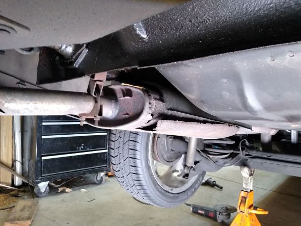

The car was getting a little raspy, so finally time for a new muffler. Still was rockin' the OEM (!)
I just ordered stock replacement stuff from RA, I figured the ol' 3.1 is wheezing away at 180K, and any old muffler will be enough breathing for it. The pipe is near mint. Someone deleted the cat years before the car became mine, but they sectioned in a piece and seemed to do a good job welding it.
I still have the window sticker and i think it says it came with a stainless exhaust, so that would explain how it's held up for 29 years, the replacement stuff lasts 5 if you're lucky.
I ordered new hangers too, but they didn't match what I had, so it was easier to use the OE's. The rear one had rusted off of the muffler a few years ago, but I kept it and it fit the new muffler fine. Had to give up my dual outlets, but you have to take what you can get, no choices on RA, and I wasnt motivated enough to put together a custom setup.

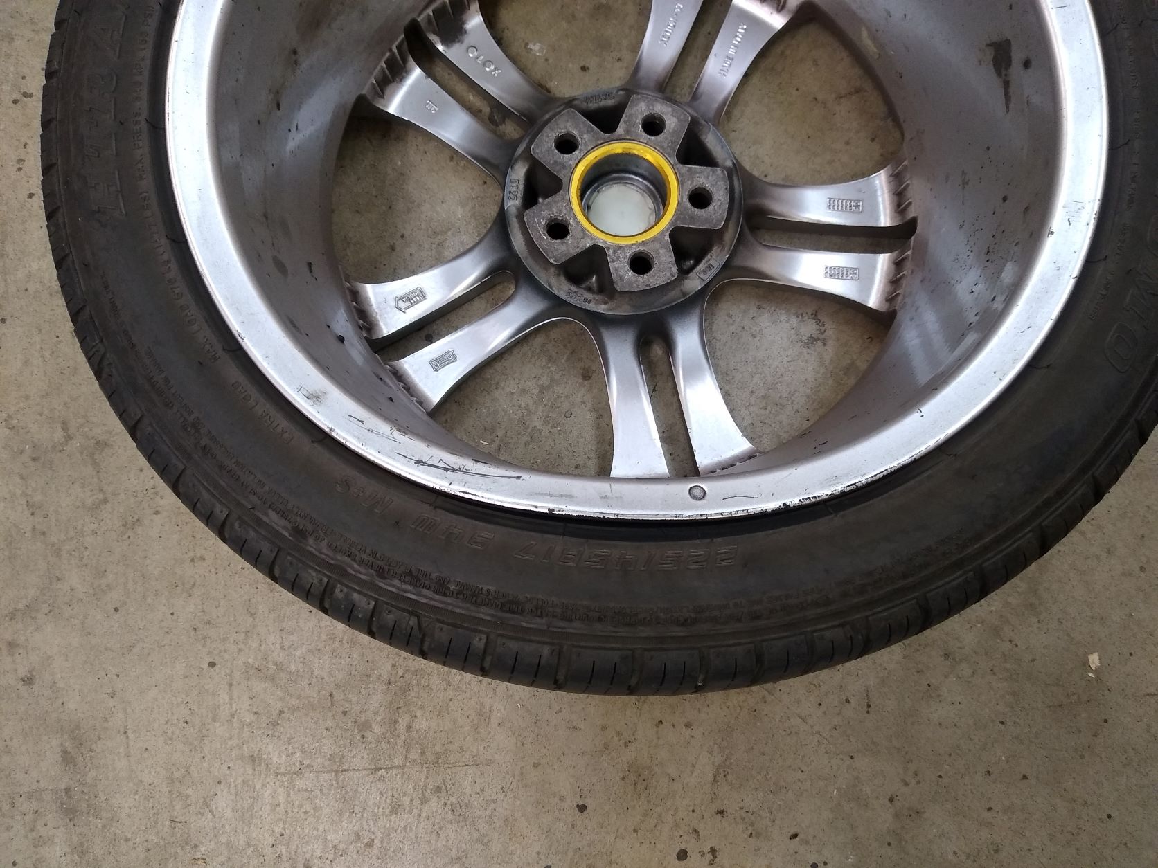

I'm learning that my new freeway commute is pretty tough on my cars! I was in the GT, looking over my shoulder to see that I was clear to change lanes, and BOOM biggest pothole of my life.
Instantly a major vibration so I thought I was getting a flat. Once I was off the highway I looked out the front window and the tire was still holding air.
This weekend I investigated, and it bent the hell out of the rim: toast. These are aftermarket 17" that were on the car when I bought it (Mille Miglia Action 35MM offset), and they are old, so finding another seems pointless. I found someone in NYC that has a set, but the offset is different, and I only need one. Plus it shows pickup, and I ain't driving to NYC that's for sure.
I think I am just going to hit the Pull a Part and find a Cavy wheel to get me by, they are $35 with a tire I think. Save up my coin for a new set of Enkei's. or, just drive it forever with (3) 17's and a steelie lol

Oh that sucks man! That was one of my fears with the Speedy Lite-5 17s that I had on my last car since 2004. LOVED those things and was always a little worried one would get ruined and screw up the set. They lasted through 2 different Berettas in 2 different colors and I had planned to use them RWD since they were dual pattern 114.3 to match up with an explorer. haha
