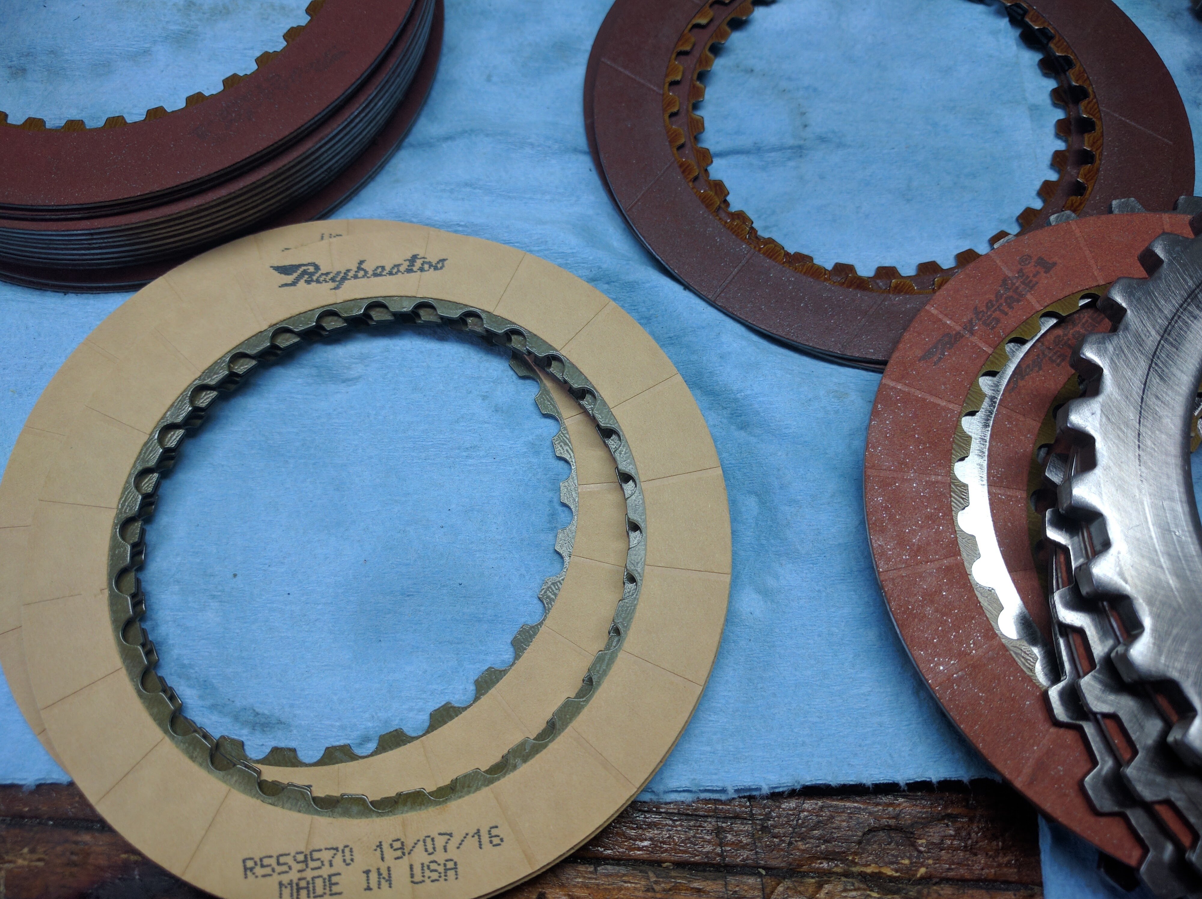

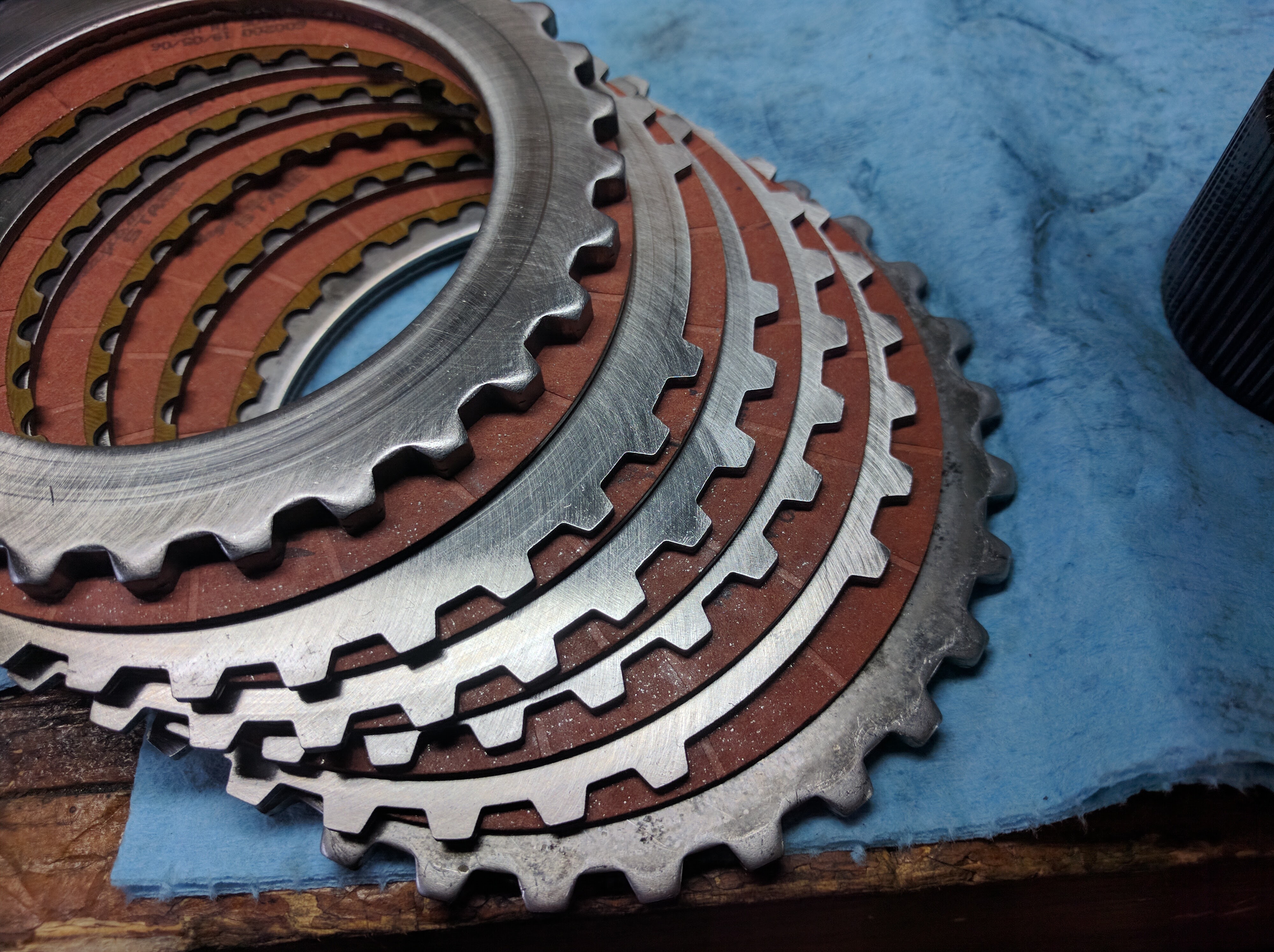

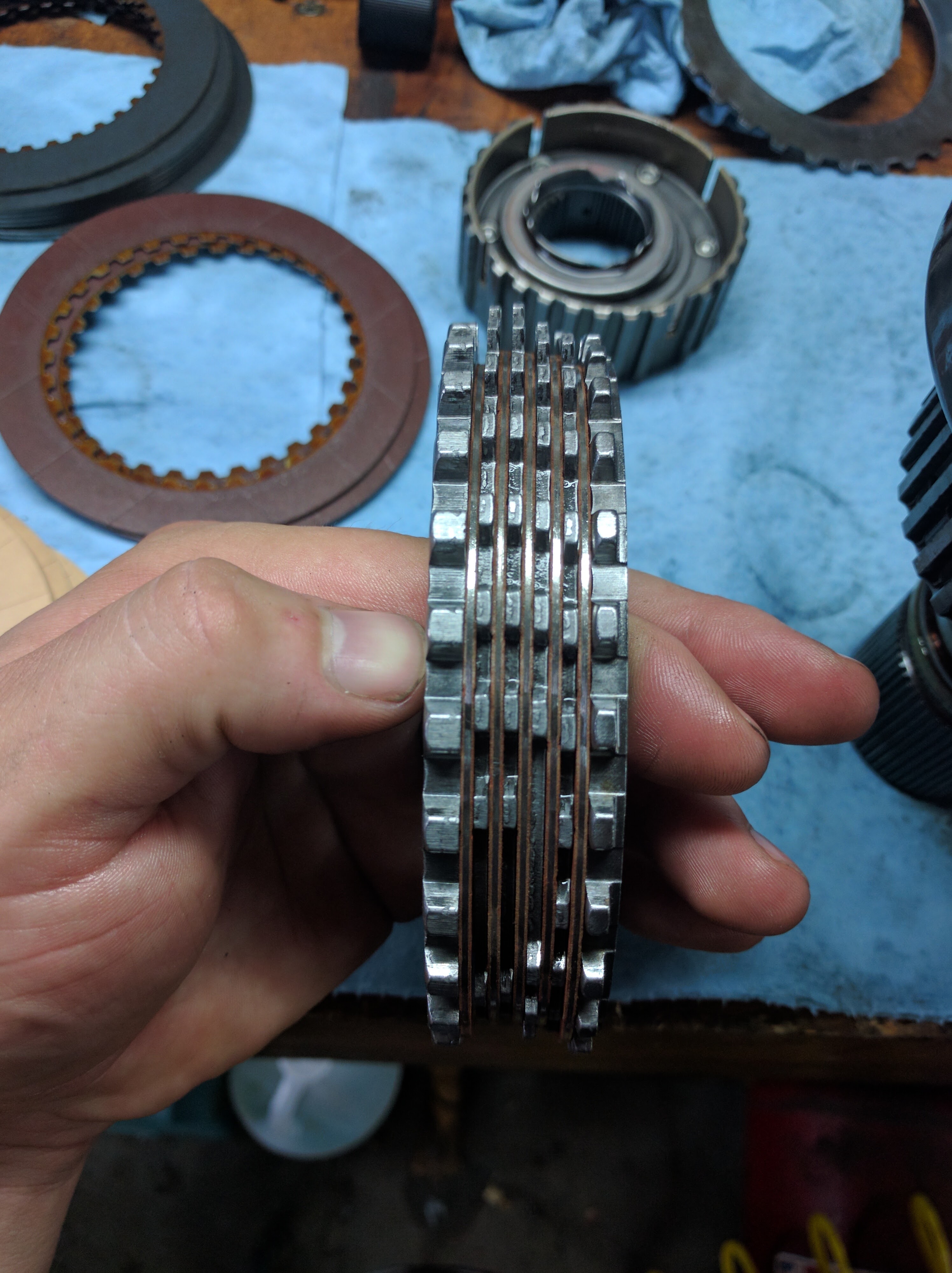

Beautifying stuff... lol
Random clutch packs that I was assembling at the time... Have the option for standard paper for the input or the Raybestos Sage 1 Reds... I'll give the reds a try :) it will match everything else I have.
Removed the wavy spring plate to improve clamping force as well as added a 5th friction disc which improves the friction surface area by 25% of the existing.

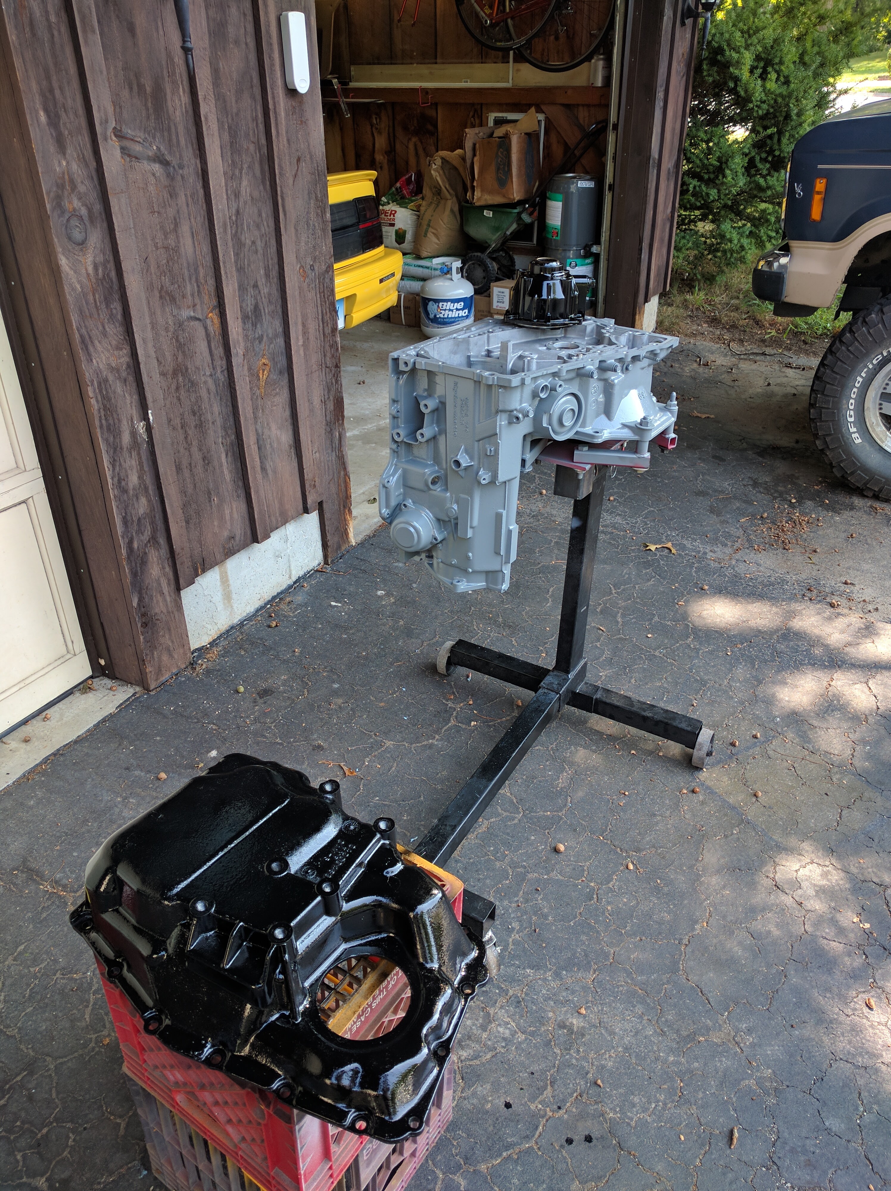

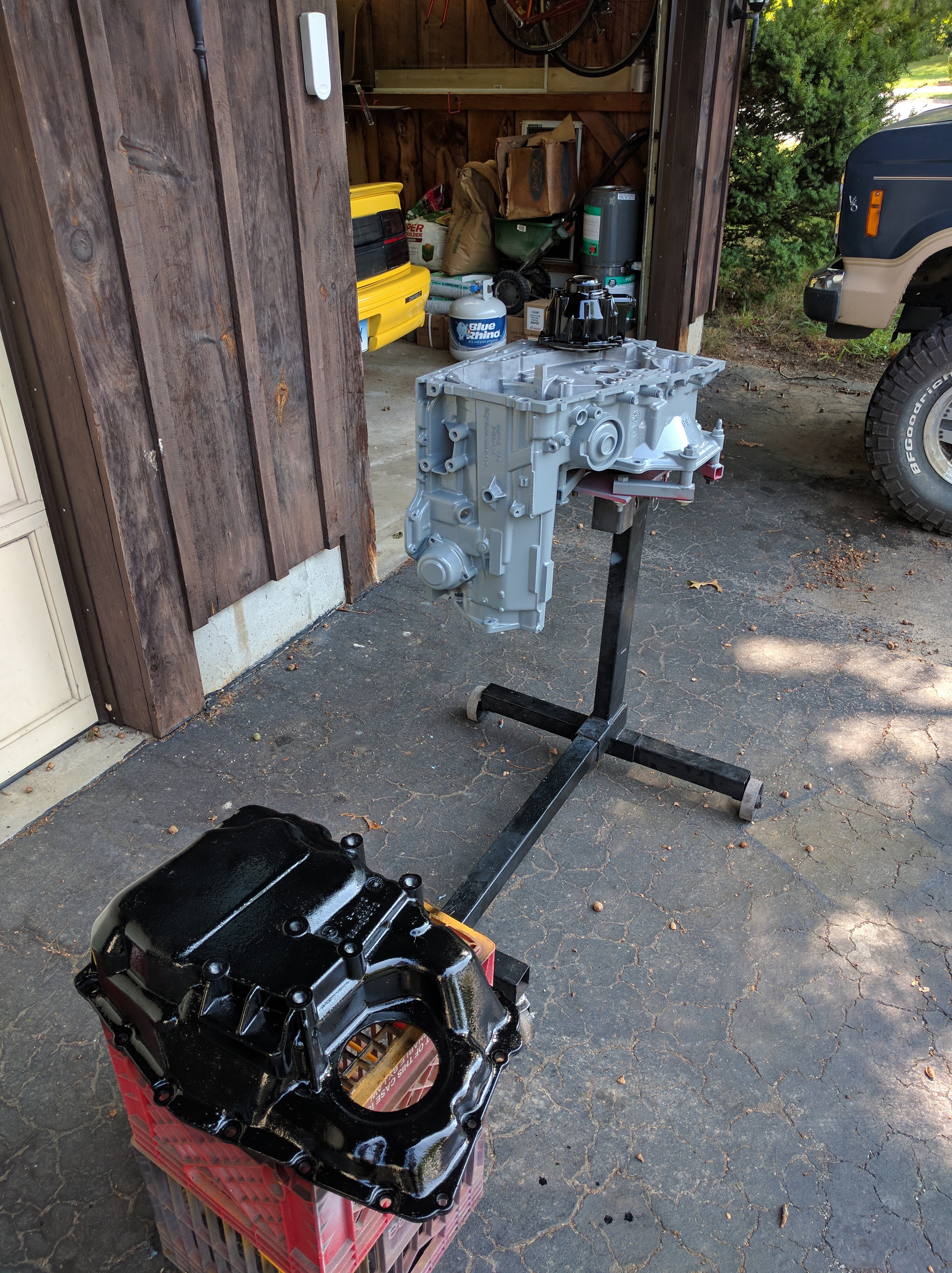

i would never install that transmission in my car, exterior is way too clean, the internals must be faulty. :D :lol:
Re: 1996 Mr.Pink
You know I cleaned it and painted it simply because you said it was dirty right? At first I wasn't planning on re-painting it.
Re: 1996 Mr.Pink
it actually looks good! i cant wait for you to come visit me, we will need 400 cans of brake clean and some industrial grey paint to do mine!
