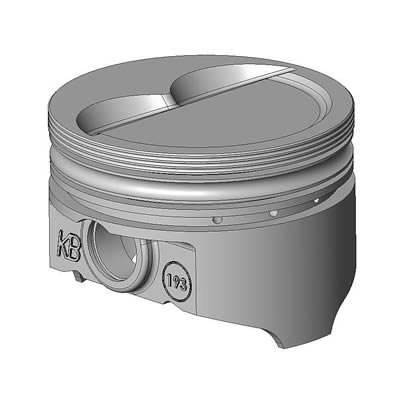

No wonder it's a goddam slug! Turns out I don't have #193 heads, whoever built the engine used #187 305 swirlies with tiny valves. The pistons also have a huge dish...they're H580P .040s, which according to google are 22cc dish. That puts my compression at maybe 9:1 even with the 58cc 305 heads and jack for quench.
The good news is the block is roller ready, and the cylinder bores look good and there's no sludge or anything. It's only a 2-bolt main, but that's fine for my usage. I did double check the block once I saw the heads and it is a 350.
So I'm thinking...LT1 roller cam, some much smaller dish pistons and Vortecs since I need heads anyway. That also means a new intake, so it should turn out to be a nice upgrade.

Summit has 6cc flat tops for $95. haha I love SBC's. That would put me at 10.3:1 with good quench though, which is a little steep for a truck, especially with a mild cam that won't bleed off that much cylinder pressure. The Vortec chamber is good for detonation resistance, but I think that's too high. 10cc would get me 9.9:1, and that's $128 for a set. Still might be a hair more than ideal, but the 12cc'ers that would give me a just about perfect 9.7:1 are $400. I can just be a little conservative with the spark timing and be good I think. The Vortec combustion chamber is very efficient.

My new cam & intake are on the way, and I'll be ordering the pistons probably tonight once I double-check the deck clearance. Compression will be 9.86:1 (up from the 8.9 it was) and the choketastic 305 swirlies are being replaced by Vortecs. Cam gets about 10* more duration and .065" more lift, stock manifolds, 2" y-pipe and 2.75" cat are being replaced by long-tube headers and 2.5" mandrel Y in to 3" high-flow cat. I'm estimating about 275-300hp and 400tq way down low in the RPMs.

Used the Beretta to haul the trans...would be nice if I had damn truck! I special ordered the 12cc Keith Black pistons for a perfect 9.7:1 with the perfect D-dish to match up with the Vortec heads for awesome quench. 87 should be no problem. They should be here Thursday, but the rest of my Summit order already came in. Cam & intake from a friend on NastyZ should be here today. Still don't have the rod-knock Vortec block from my bro-in-law yet, so this weekend I cleaned up the engine bay and Raptor-lined it. I also played with the TBI doing the "ultimate" mods. I rushed it last time with just a cut-off wheel at my dad's garage, so this time I took some extra care and it's much better.
