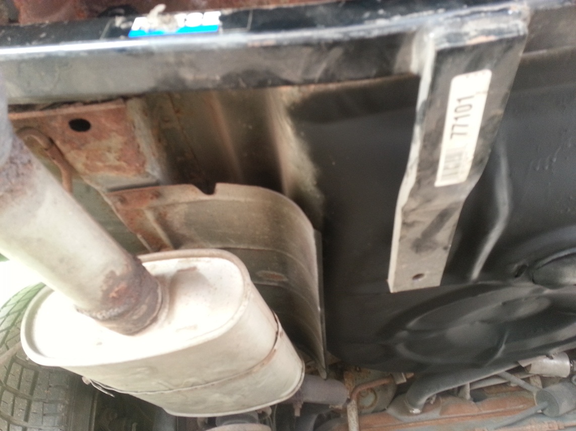

get a flowmaster or something decent if you are going to spend that much... i forget which one i put on my car, but it was "barely" used off of some guy's weekend muscle car... i paid $20, and it's a "turbo" something or other... sounds good, great construction, looked like it would last longer than the walker aluminized cheap mufflers from most stores... there is some wiggle room there for other mufflers, but i can't recall which i have... i suspect a side offset outlet. (single outlet, and i welded the stock tip on, with a small filler pipe in between i think i needed...)
Edit: here's a pic! So, don't mind the crustiness... looks a bit better after i cleaned it up and painted/undercoated after the trailer hitch install. i'm pretty sure it is an offset inlet, and then center outlet. and you can see the added filler pipe between muffler and stock "Y" to tips
