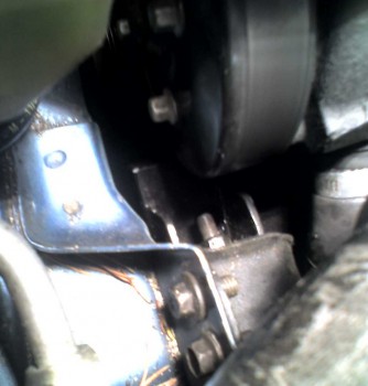

Dang, I wish I had just made two or three front engine-mounts when I built the one for my '90 LG5 turbo 'Retta upon upgrading the block to a 3400... The one from the link is really nice, if you can actually build it (correctly), but what a beast! How many pieces go together on that jigsaw puzzle? Mine has two...
Plus the two nuts I welded in place for ease of installation.
- Front Engine Mount in my '90 'Retta, using a 3400 block.
