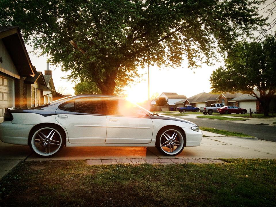

I miss my gp sometimes n Im intrigued how they would looked frosted

on a side note, this is my GP, ive had her since 07'. Its an 03' model. bought it bone stock as a spare car and couldnt leave it alone lol. dont worry i dont plan on putting huge wheels on my beretta. I like the stock look it carries for now hahaMY91GT(Z) wrote:I miss my gp sometimes n Im intrigued how they would looked frosted
