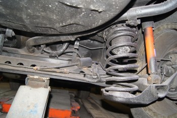

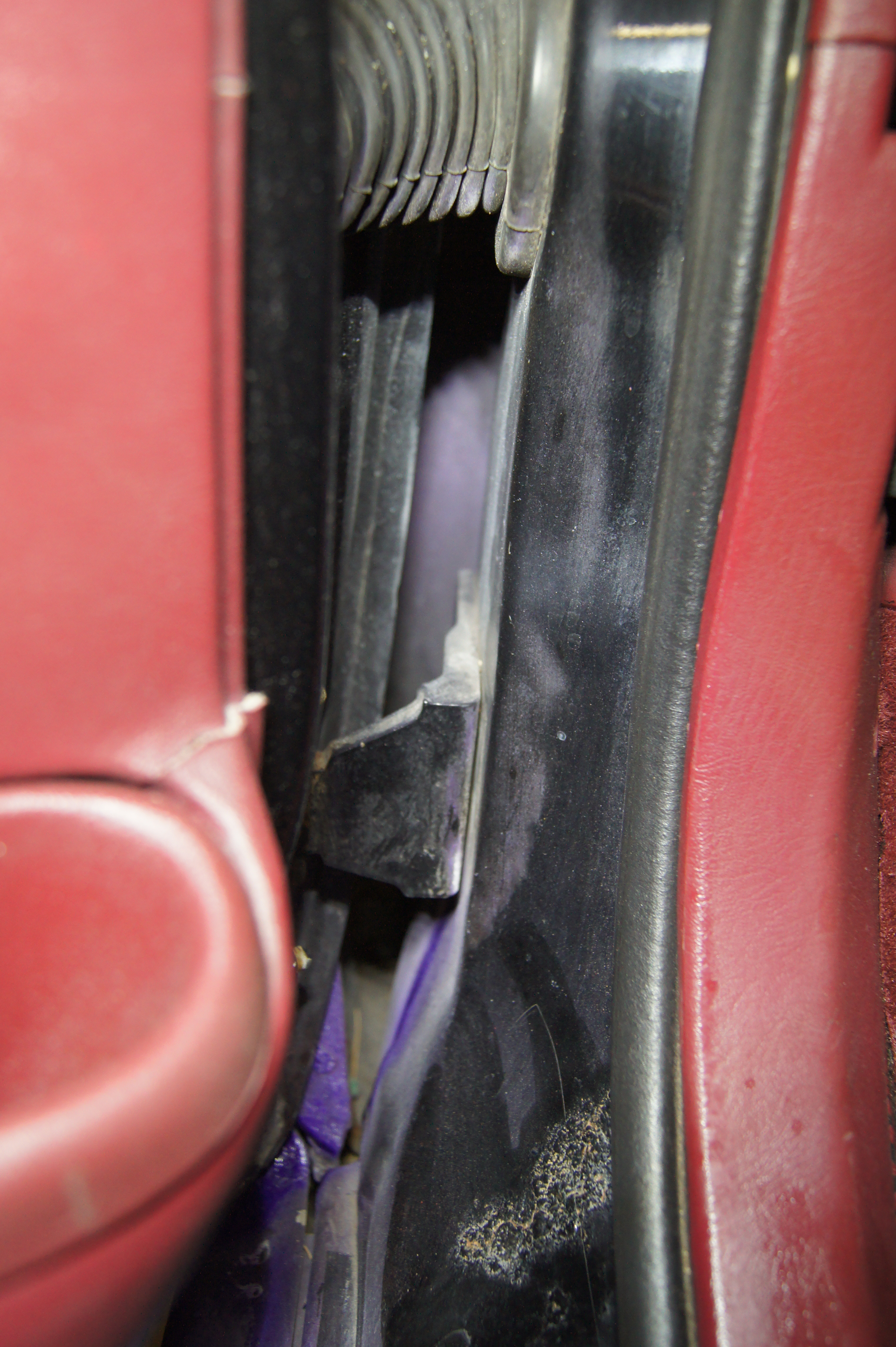

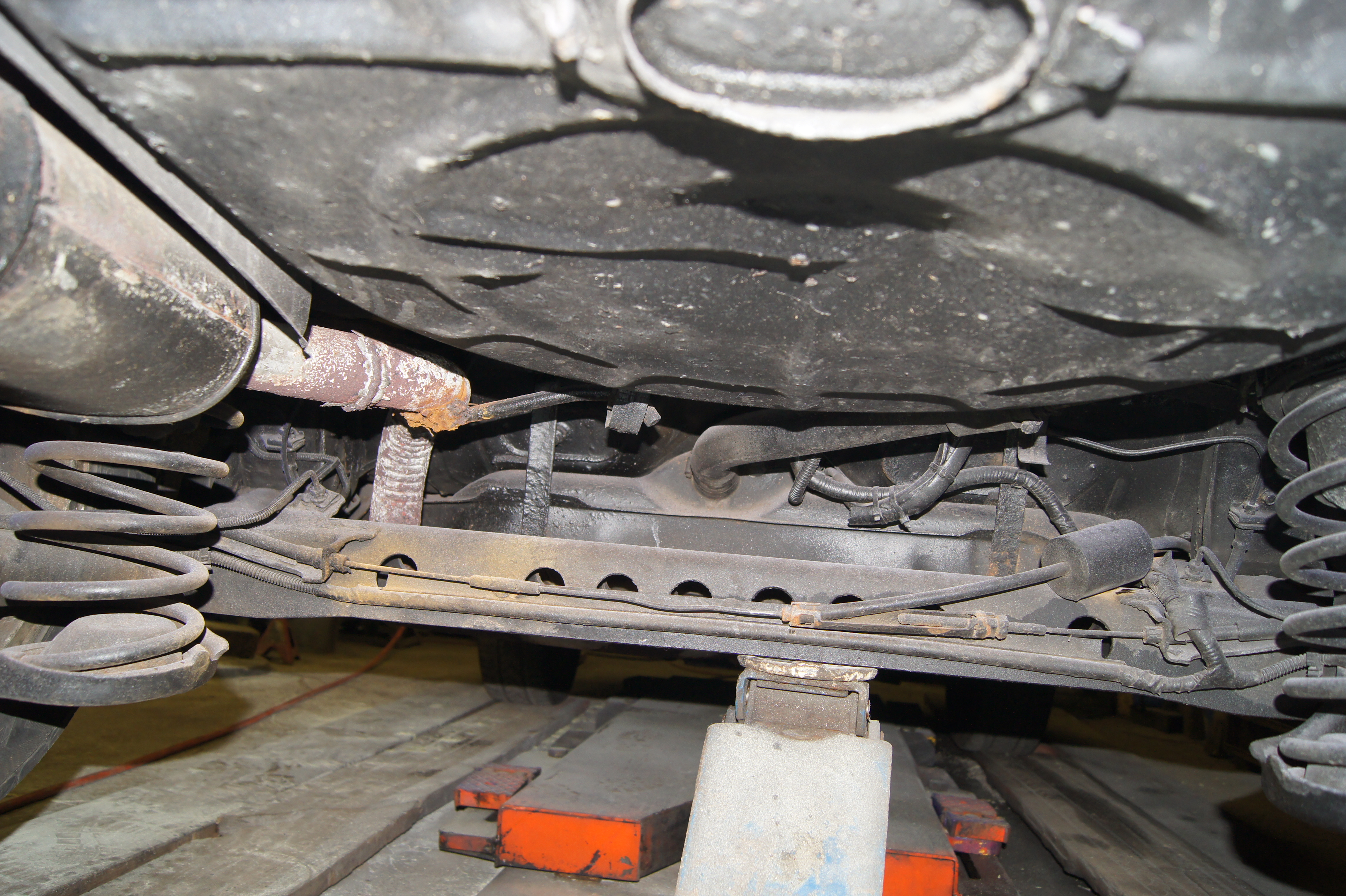

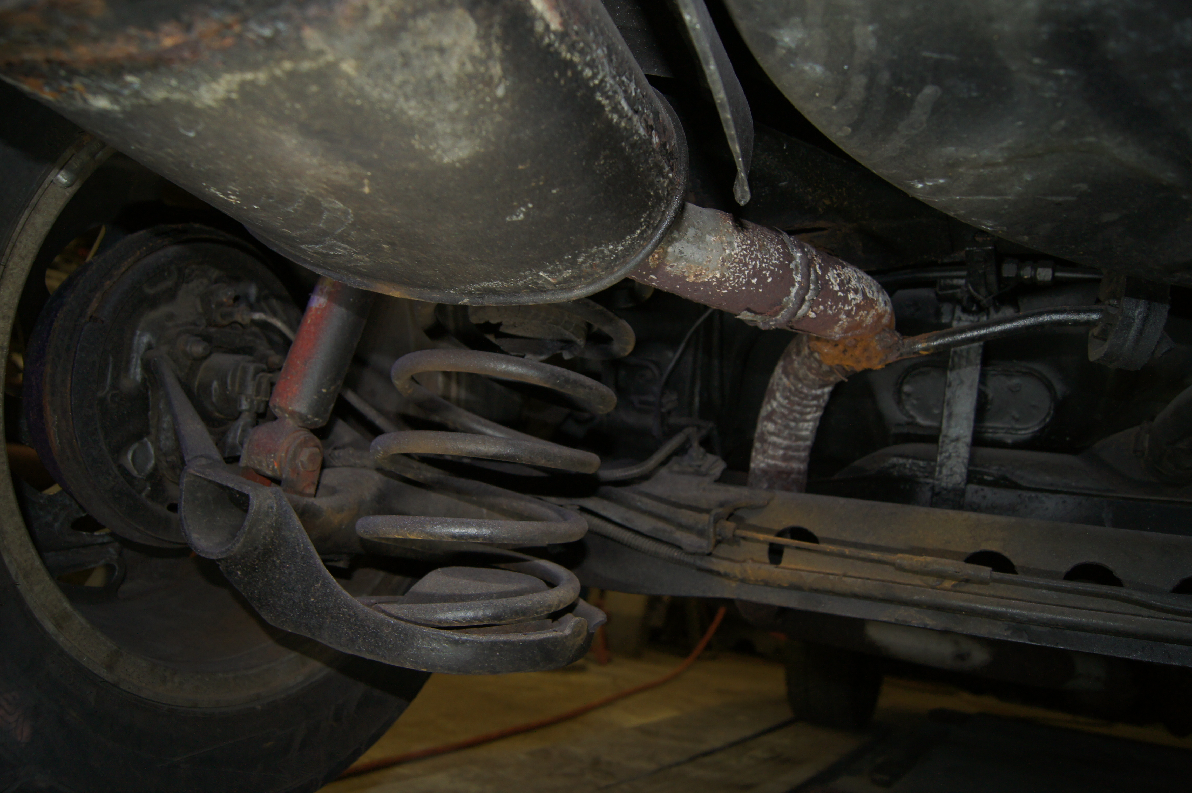

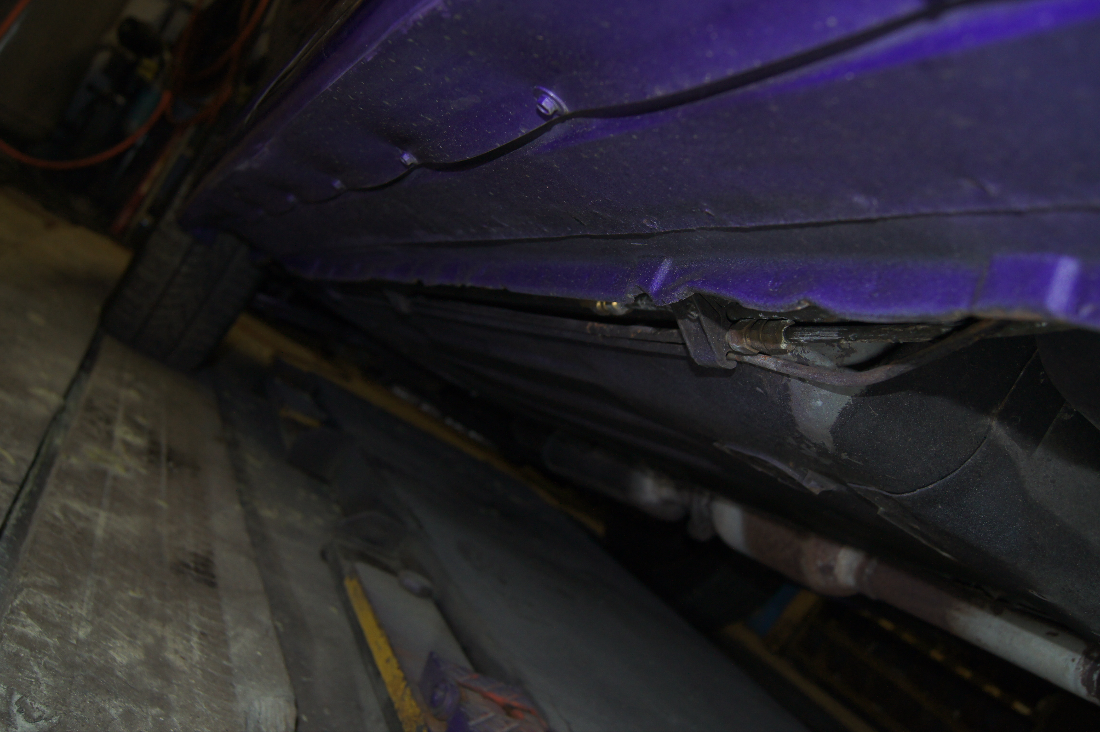

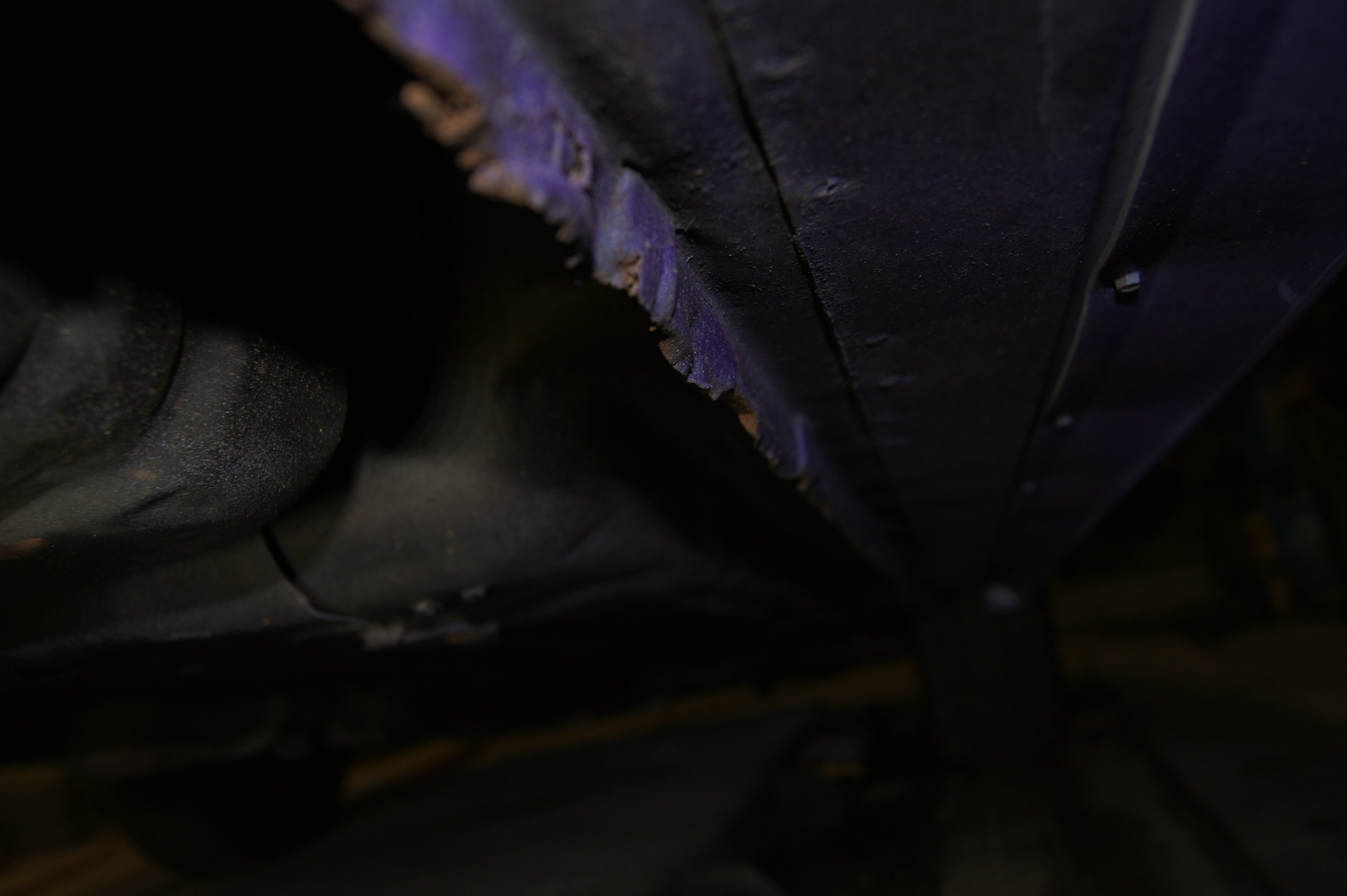

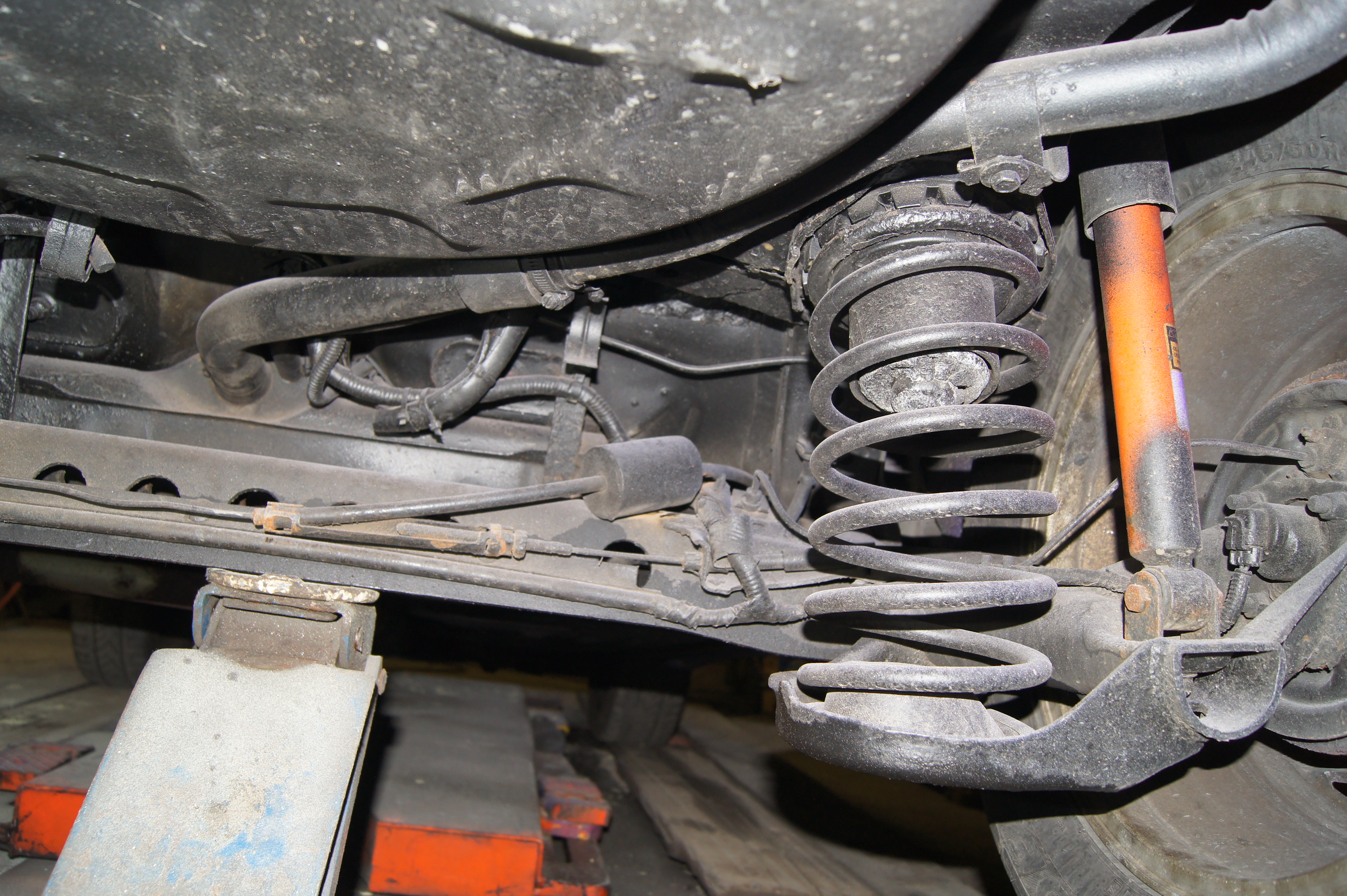

Finally have pics for you guys. IMO the car is pretty clean.... not mint but pretty clean for its age.

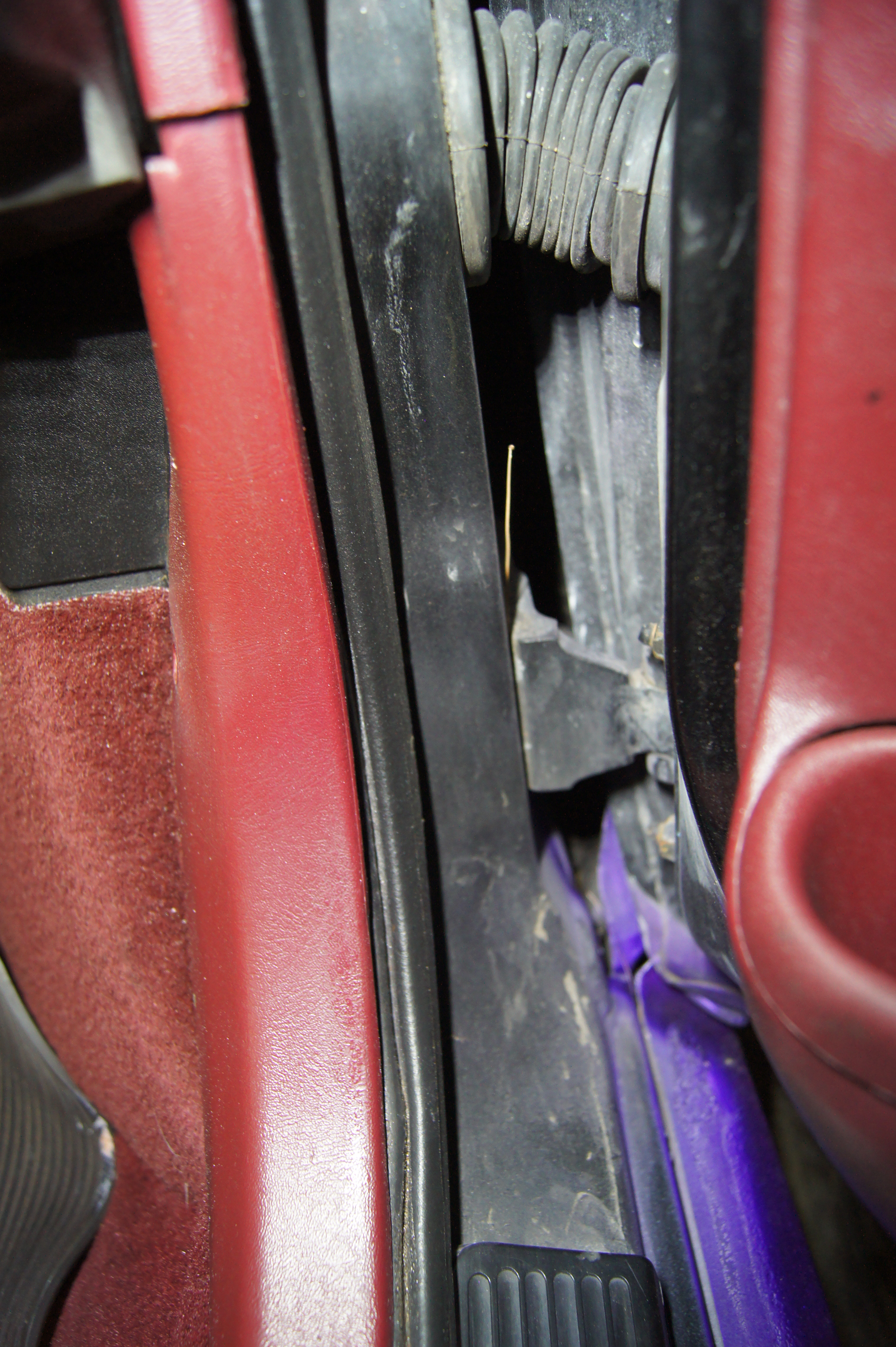

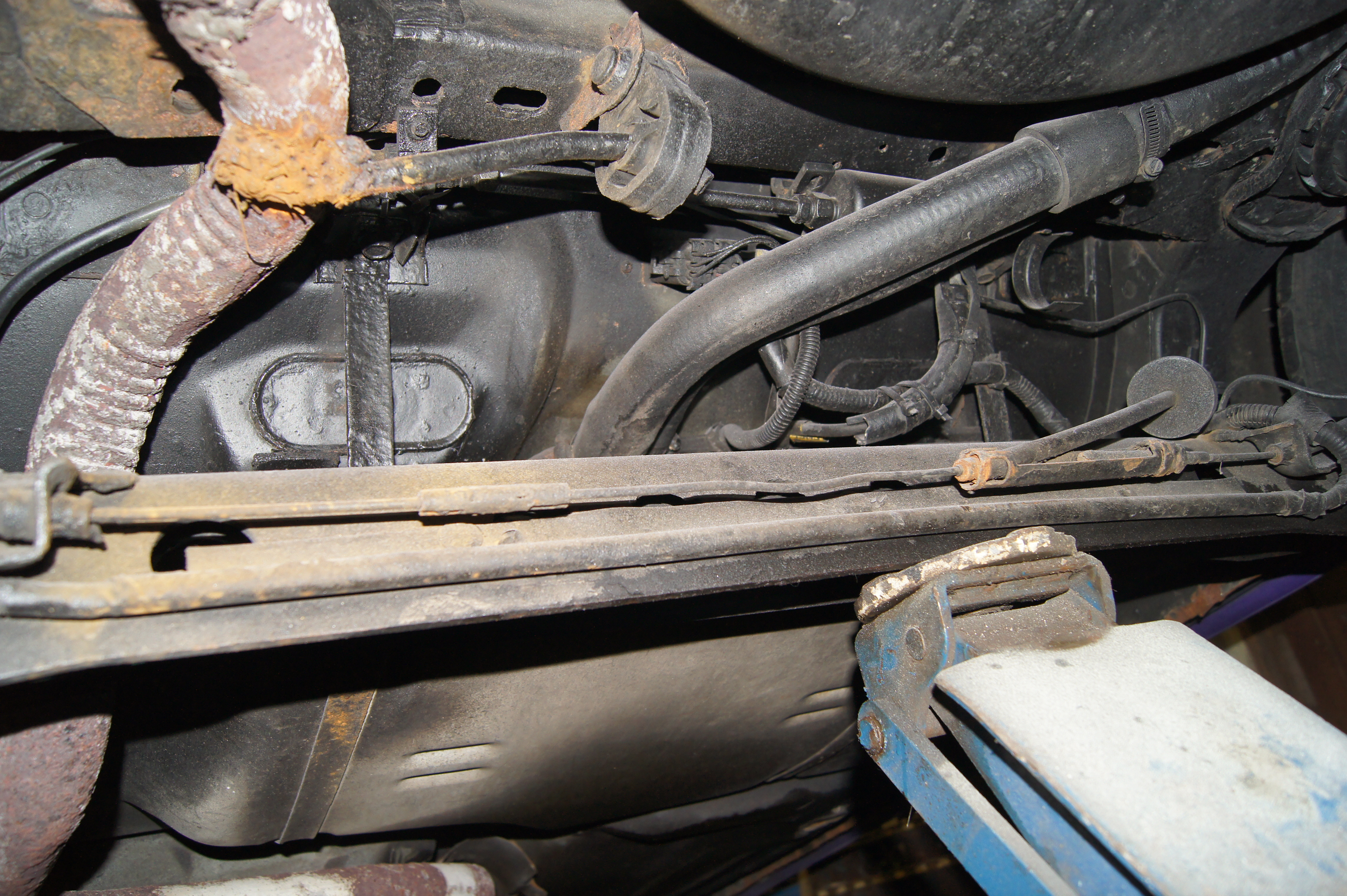

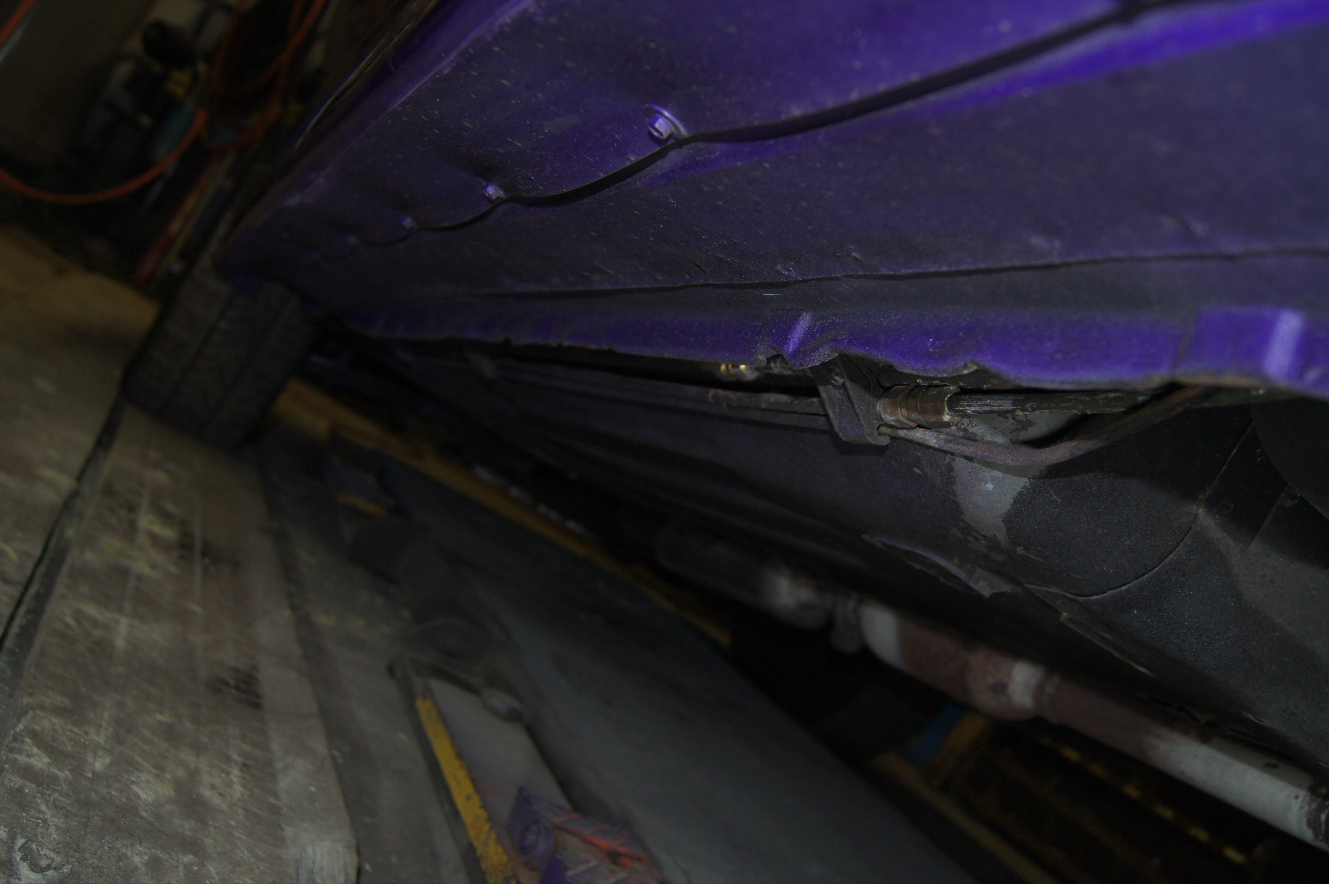

Just my .02 about what i see here.
I have to wonder what is under the undercoating? It obvious it was sprayed on recently.
Also some rust is poking through the drivers side door jamb so it's not like it's totally rust free.
I see some of what looks like brass compression fittings on the power steering cooler lines?
The pics of the underside of the rockers is that in the rear or front of the car.
It looks like the car was black and repainted to purple.
- Posts: 10916
Re: 95 Beretta Z26 for sale
Those actually appear to be fuel or brake lines, That photo is looking up the drivers side, you can tell by the order of the CAT then resonator... With the inline compression fitting like that I hope to god they are fuel and not brake lines.
I agree with everything else you've stated though.
Thank you for agreeing with me.3X00-Modified wrote:Those actually appear to be fuel or brake lines, That photo is looking up the drivers side, you can tell by the order of the CAT then resonator... With the inline compression fitting like that I hope to god they are fuel and not brake lines.
Personally I HATE compression fittings in general. Again.. its not my car.

- Posts: 10916
I was agreeing with ifixalot unfortunately.
Its not a matter of being too picky, its just the truth... if these cars have rust in the locations you pictured then they are not good projects and only a possible short term daily car before it rusts out even worse. Its very expensive to fix rust on these cars because there just isn't any replacement panels available to repair those areas.
