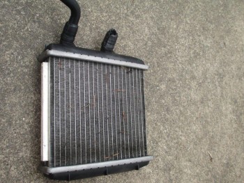

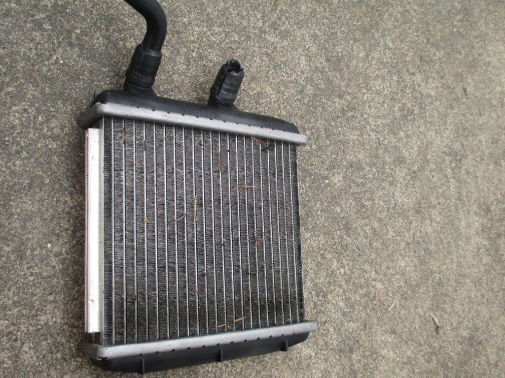

So while we're on the subject of leaks: I get to work this morning and as I walk away from the car, I turn to take a look at what I have spent the last 2 months of free time thrashing on, and uh oh, green stuff pouring out!
Heater core, the one thing I didn't mess with, lol. Looks like it should be possible to bypass it in the parking lot. Not too many auto parts stores in Amish country though.

Exactly, I just had the interior out, etc. I thought about replacing it "while I was at it", but where do you draw the line?
Worked out OK, I took an extended lunch and walked over to the Amish hardware store next door. They had 5/8" heater hose and clamps so i bypassed it in the parking lot. I doubt their buggies have heater hoses, but I'm sure glad theyn had what I needed.

Well last weekend I replaced the heater core and hoses, not a bad job if you take the seats out. Man was I sore the next day though.

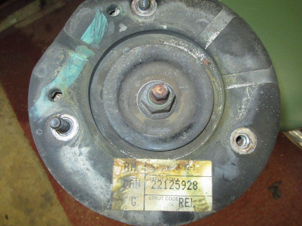

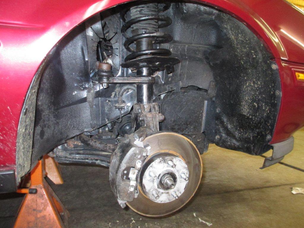

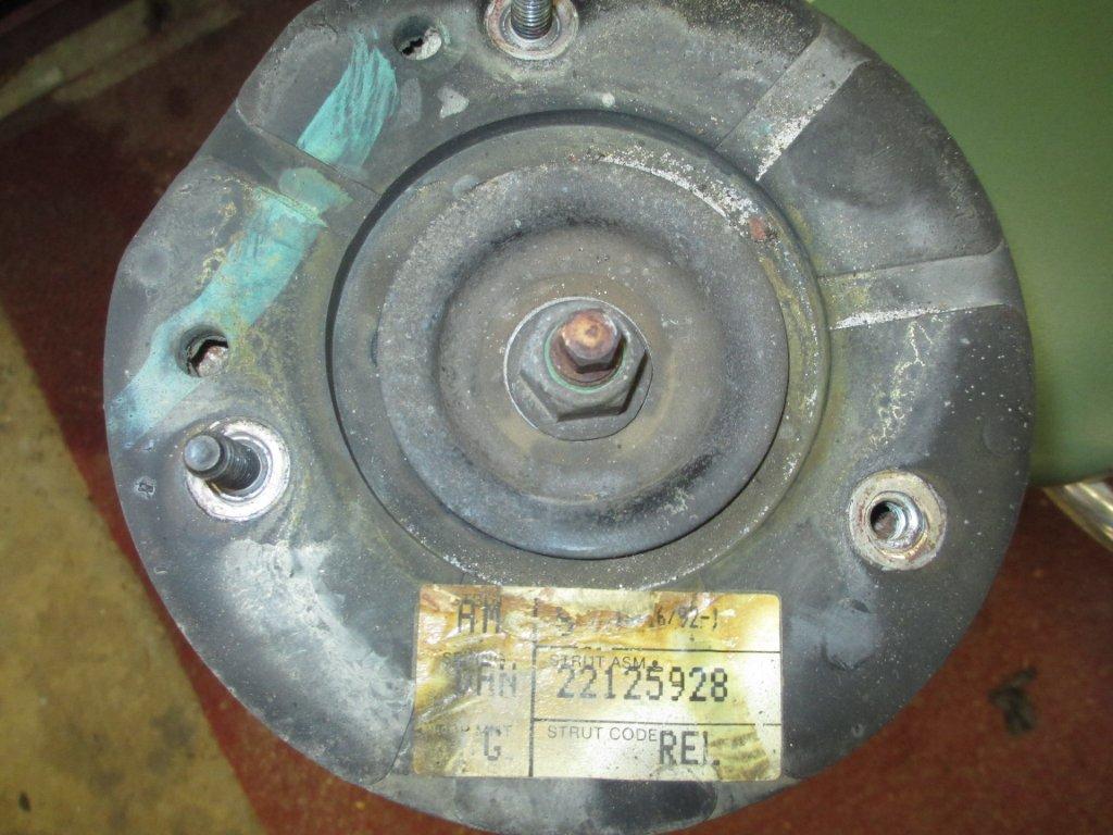

Last Saturday I replaced the pass side strut mount, I bought Gabriel parts at RA, manufacturer closeout. I got the mount kit and spring insulator for $40 shipped. I posted details of the job in the Suspensions category.
Original mount, you can see a date of 92 on it.

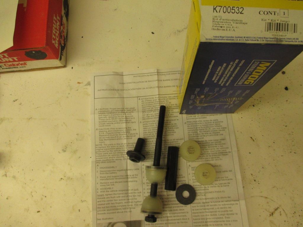

I bought this Moog problem solver sway bar link at Advance. Seemed like a good deal at $11, with poly bushings. Didn't even think about it until I got home, and then I realized it was only one. I thought it was a set. Oops. I didn't really understand the problem solver aspect of it, it has a special nut that threads down in to the bushing as opposed to just being on top of the washer. It also has a solid spacer instead of the rolled steel one with the seam that most kits have. I don't see why this would be advantageous, but I put it on and it works well.
If I would have known that it was only a single link, I would have just got the energy suspension kit, but live and learn. I was just focused on getting the car back on the road at that point.
Prior to replacing the mount, the steering wheel would almost get yanked out of my hand when you would hit certain bumps, especially cornering. I also was experiencing a constant rattling that seemed to be coming from the pass side strut tower area of the car.
The mount helped the bump-tracking, but I still have the rattling sound. I wouldn't be surprised if its the strut itself. Who in there right mind replaces only one of the strut mounts, and then re-uses the original 23 year old strut? Lol
As I explained previously, I'm still trying to decide what I want from the suspension so that's why I band-aid'ed it. From what I read here, aftermarket struts don't seem to last unless you do the bilstein mitsu cartridges.

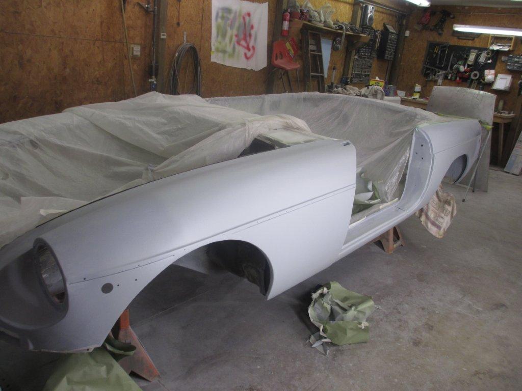

I have most of the tools and facilities for doing an overall on it, just not right now. I have a long-term resto going (1970 MGB, little British roadster).

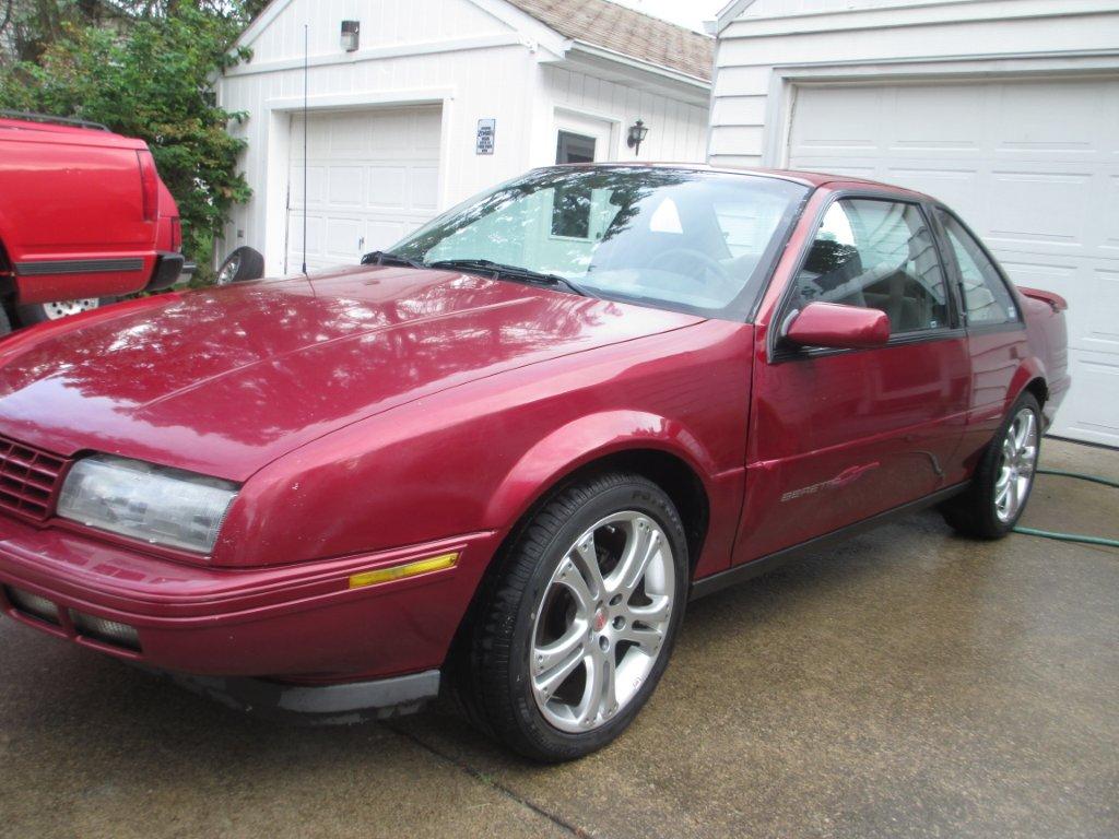

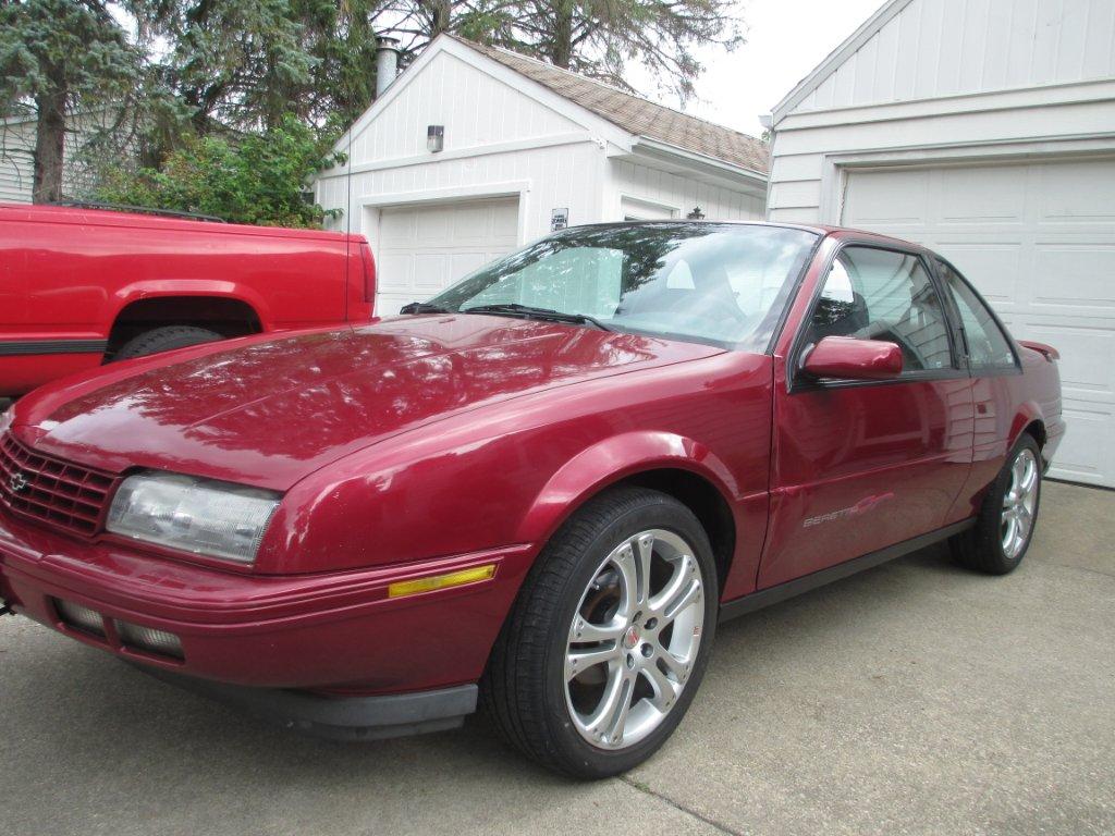

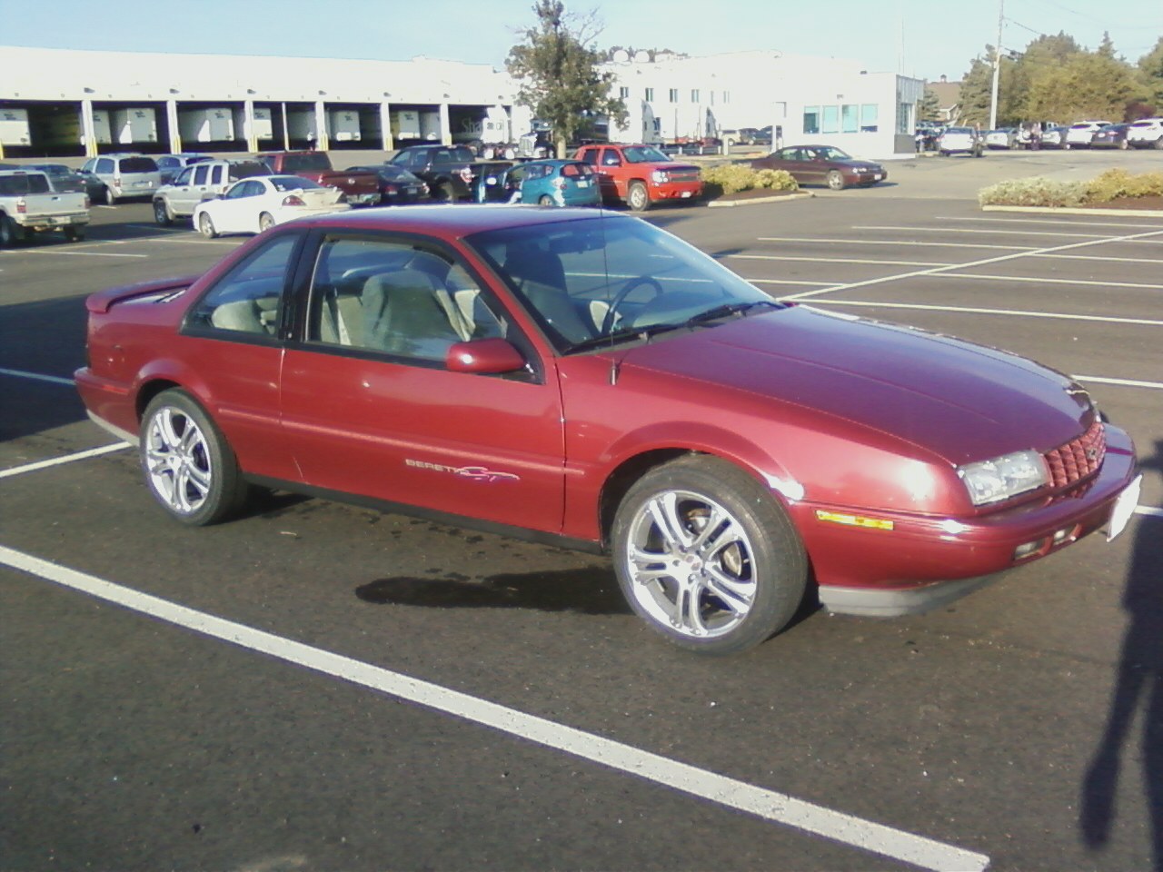

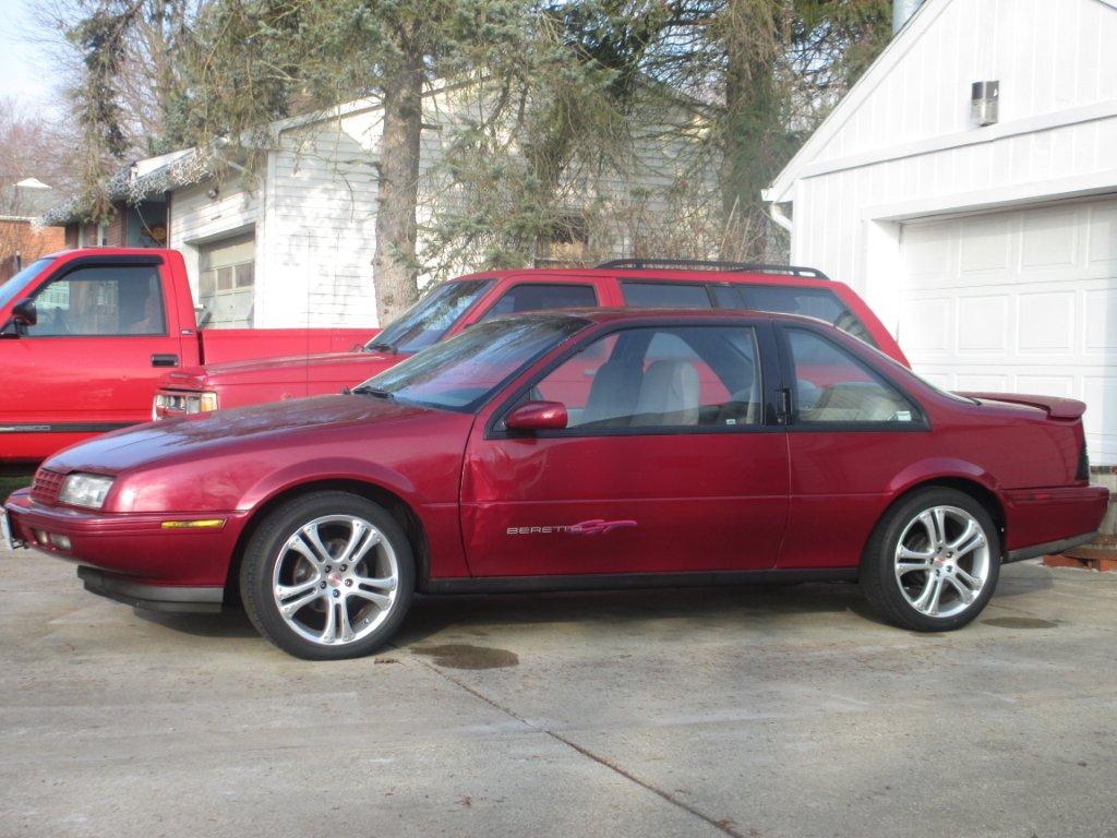

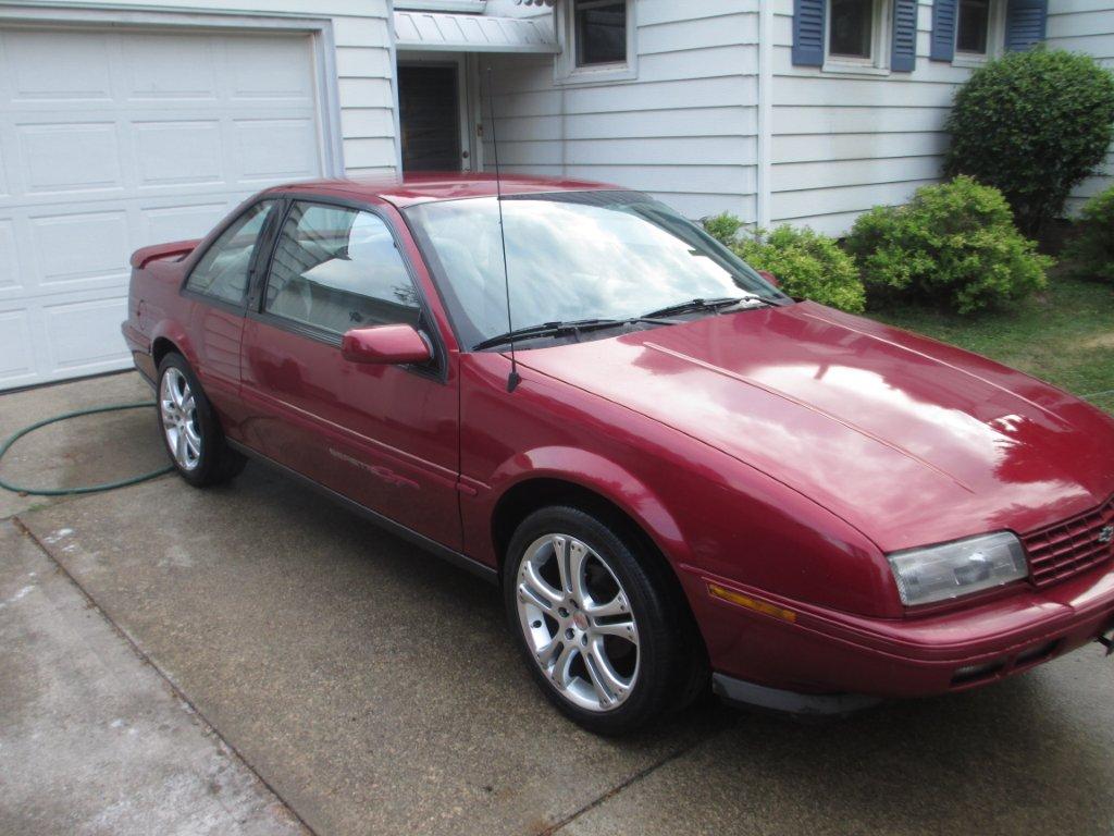

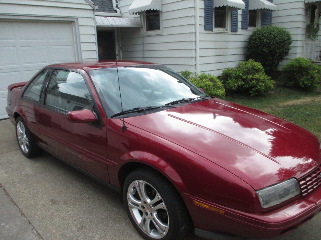

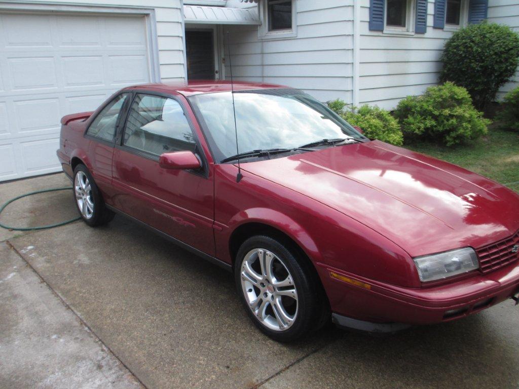

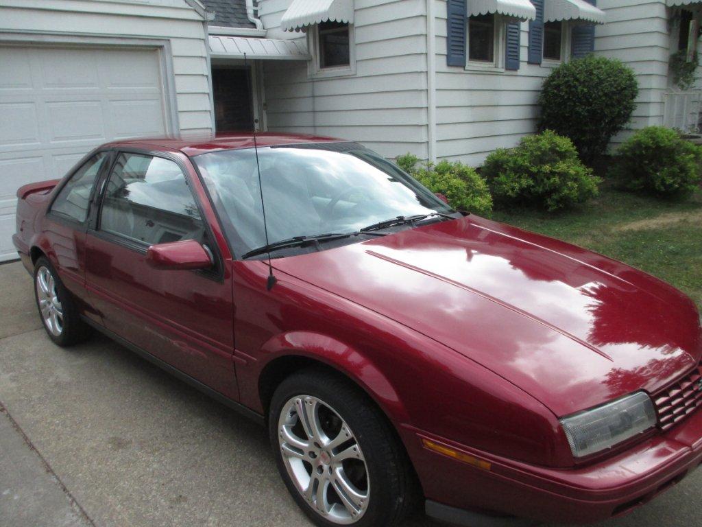

70 degrees in the Hall of Fame City on Saturday! Washed up the car, I hadn't had a chance to since we got back from Ocean City in Oct.
Wheel well gaps? I'm not sure if I can put lowering springs on with the wheels I have (came with the car) 225-45-17 Potenza tires.
Right now with 2 people in the car if I hit dips in the highway I can hear tire rubbing in the back. I think that it is just draggin-ass syndrome with the 24 year old springs, and with stiffer springs, even lowered, it won't be any worse.
This car is a daily driver in the summer months so I don't want to give up driveability.
So I have some measurements and some thinking to do. I know wheel offset is discussed on this site so that will help.

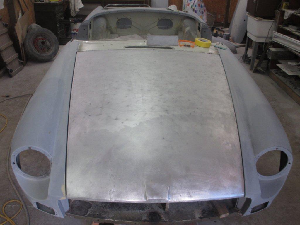

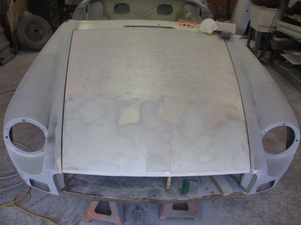

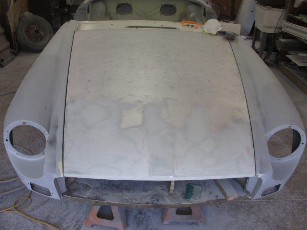

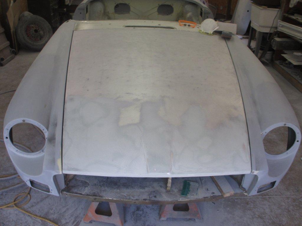

My main focus is the restoration of my '70 MGB. Heavy in to the bodywork, so that kind of takes over your shop completely. Everything is covered with a fine primer/ bondo sanding dust. Its hard to believe such a small car can completely take over my shop. The Beretta has to sit outside sadly.
