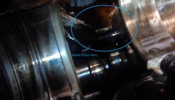

This is the damage I've found, aside from the spun bearing on #2. Five pistons all have the same damage... Everything in here is original, I'm pretty sure I'm the first one in here in over thirty years. The insides are actually pretty clean, no sludge or carbon AT ALL on the top of the cylinder heads. I can't get a good reading all the way around with my T-Gauge until I pull the heads and pistons, but the cylinders don't look overly worn, compression was good and consistent, and the one spot I measured thusfar was 4.000 exactly (perfect on a 350 Chev). None of the wrist-pins feel stuck either, so unless I did this when I first rotated the engine through (by hand, thank you), that isn't the cause either. I suppose someone else could have messed with this some years after it sat before I got it and broke something... But I'm thinking it may have been over-revved at some point? Any thoughts? All five breaks are on the same side, relative to rotation (breaks on the left bank are on the cam-facing side, breaks on the right bank are away from the cam).
![L98 good piston1b.jpg (212.8 KiB) Viewed 6956 times This is what the skirt should look like...](./download/file.php?id=6872&t=1&sid=013125eef8e9e8d5f8eb2897cf3fa5b9)
- This is what the skirt should look like...

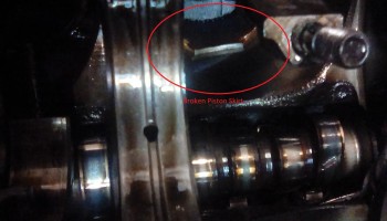

![L98 Bad Piston1b.jpg (210.62 KiB) Viewed 6956 times This is what the typical break looks like. I only found one complete piece, but the break area doesn't look oil-stained or carboned-up. There are enough small pieces in the pan to account for maybe one or two skirts.](./download/file.php?id=6873&t=1&sid=013125eef8e9e8d5f8eb2897cf3fa5b9)
- This is what the typical break looks like. I only found one complete piece, but the break area doesn't look oil-stained or carboned-up. There are enough small pieces in the pan to account for maybe one or two skirts.
The harmonic balancer had come apart before the car was parked too, not sure if that was a contributing cause.
