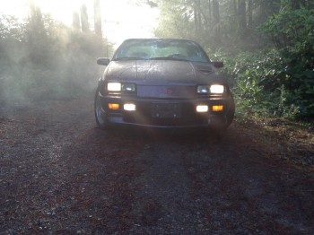

- Euro-style lights and a foggy morning, what could go together better than that?
I also fabbed-up some Euro-type headlights using the non-composite option from an '89 pickup. A little trimming on the brackets and a major chopping of the Beretta's header panel was needed to make them work, but they do fit in there okay, and once the headlight surround 'buckets' are built, should look like a factory Euro to the untrained eye. I can still put the original Beretta headlights back in too, without having to replace the header panel with a spare if I want to, as the panel wasn't butchered beyond use for the Euro lights.
