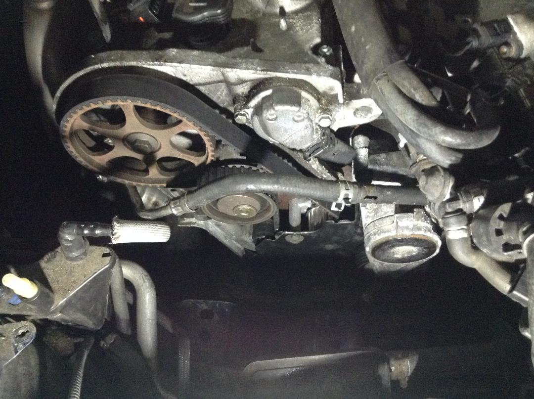

New Timing-Belt installed and ready to go.  New pump installed too -upgraded to ditch the crap-tastic plastic impeller.
And one more reason to dislike most timing-belts: Take the wheel off and work on the entire face of the engine from top and bottom... Dumb.
I found the belt HAD been changed (Gates brand -what I usually choose too), but the water-pump was original Audi -possibly replaced with OEM, possibly NOT replaced... Either way, plastic junk impeller, had already cracked and was missing pieces. :Search: Nowhere in sight and crumbly as 'Blau" cheese... :D The belt had stretched enough that the hydraulic tensioner wasn't even keeping up anymore. So yeah, the belt and the pump needed to go.

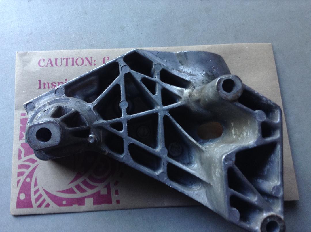

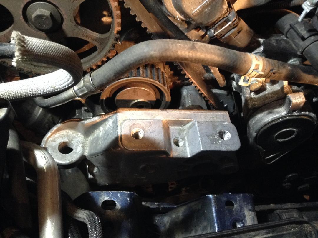

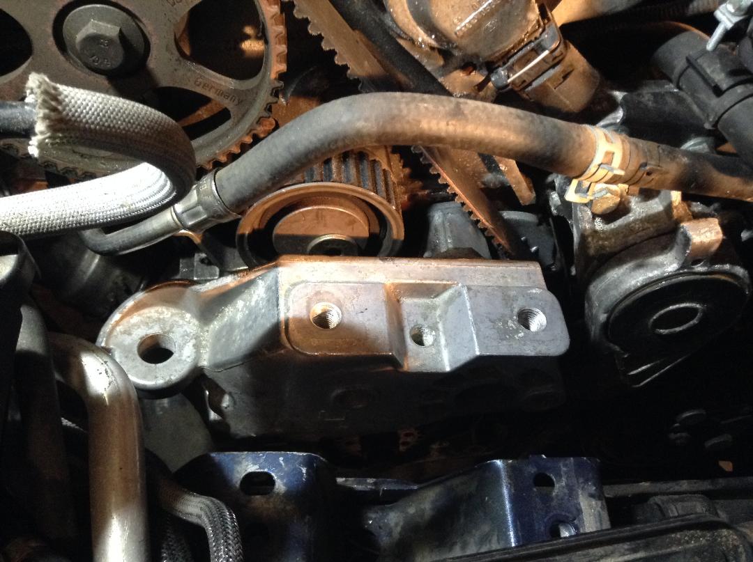

Rettax3 wrote:Removing all the little pieces and parts is expected on one of these, but the engine mount that cannot be removed despite it blocking the belt is another thing... I will TRY to remember to snap pics when I chop the stupid piece of "scheiße" into a functionally-removable component...
This is the mount that traps the belt to the engine and must be unbolted for the replacement
!@$#! Piece! >:(  Instructions say to 'shift' this mount around to get the belt out of the engine.  It is supposed to stay in the way.  Ahh, NO.

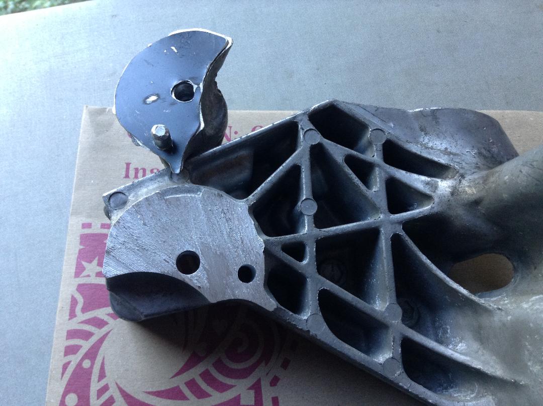

My Porta-Band saw-blade broke when I started cutting this, the only one I had was old and dull.  The cut looks nasty, but is straight.
The kerf, or cutting width of the bade, had to be made up for -so a small sheet-metal shim was made. Before cutting, I drilled a hole through the mount, and tapped a bolt in to make an alignment 'dowel pin' that will also help support the mounting bolt against shear forces.
And there it is.  In place, and now readily removeable for future belt service.

I weighed the options and considered whether or not the belt will get replaced again, but I wasn't going to work around that stupid block so it was out anyway, and it was such a PITA to remove that the satisfaction of chopping the damn thing in half AND fixing a pi$$-poor design made it worth it all on it's own. :D

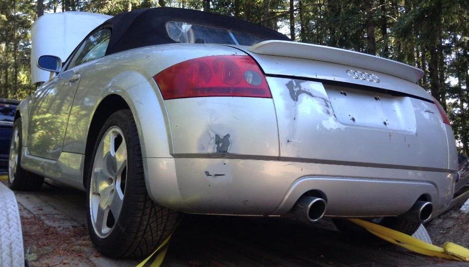

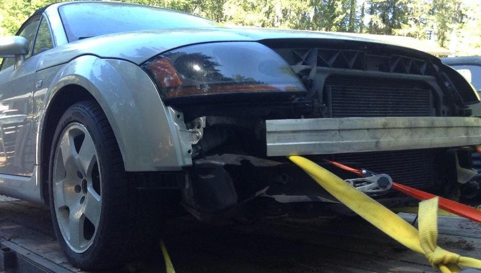

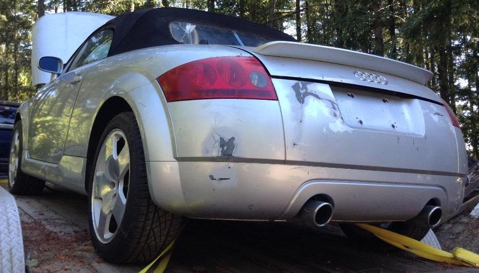

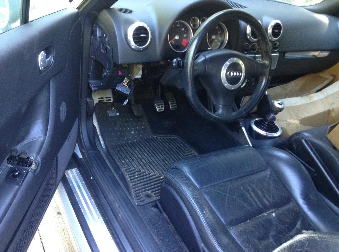

Because I found a Quattro parts-car with a six-speed manual for cheap, so of course, we now have TWO MK1 Audi TTs... Ugh. The parts-car, as mentioned, is a Quattro model, meaning both AWD and a more powerful version of the 1.8T, 45 more ponies to be exact. 225 isn't bad from such a small powerplant, and from what I can tell, they are perfectly reliable at that output (so long as the maintenance is kept up on them, and the plastic junk-parts are replaced occasionally, or upgraded...). This particular one looks just like the blue one, perhaps a little rougher, but is silver under black, instead of blue-on-blue. Stock rims (I like them better myself). Some rough spots in the paint. Oh, and a totally ruined cylinder-head from a snapped T-Belt... Duh.
This is the worst angle for the car. The rest of the body and paint are much cleaner.
...Except for the front bumper-cover.  It was included, just not installed. A few cracks, but nothing beyond repair.

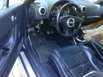

The interior is a little rough, but some replacement parts (like door-panels) were included. The P/O did INTEND to fix the car...

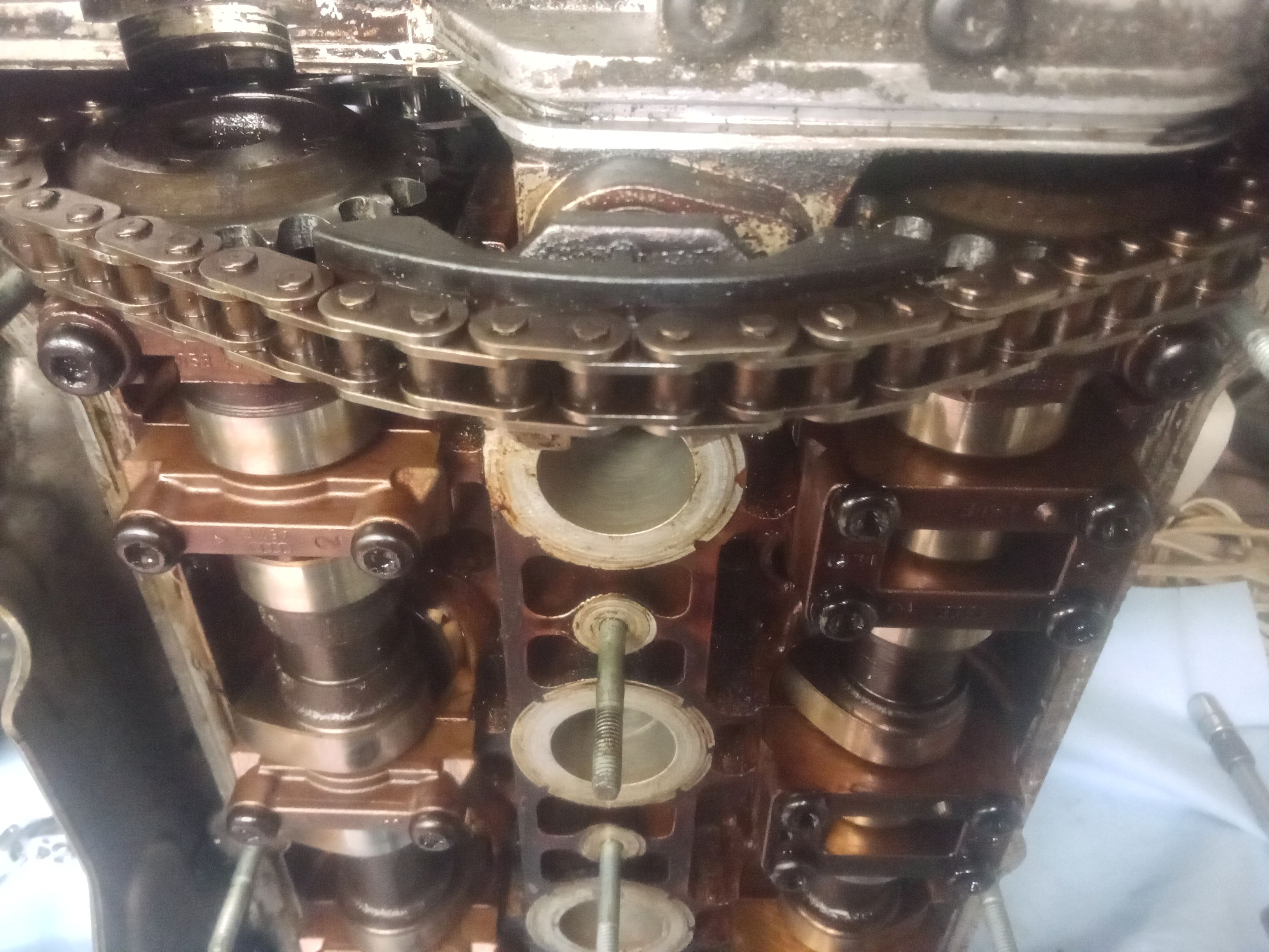

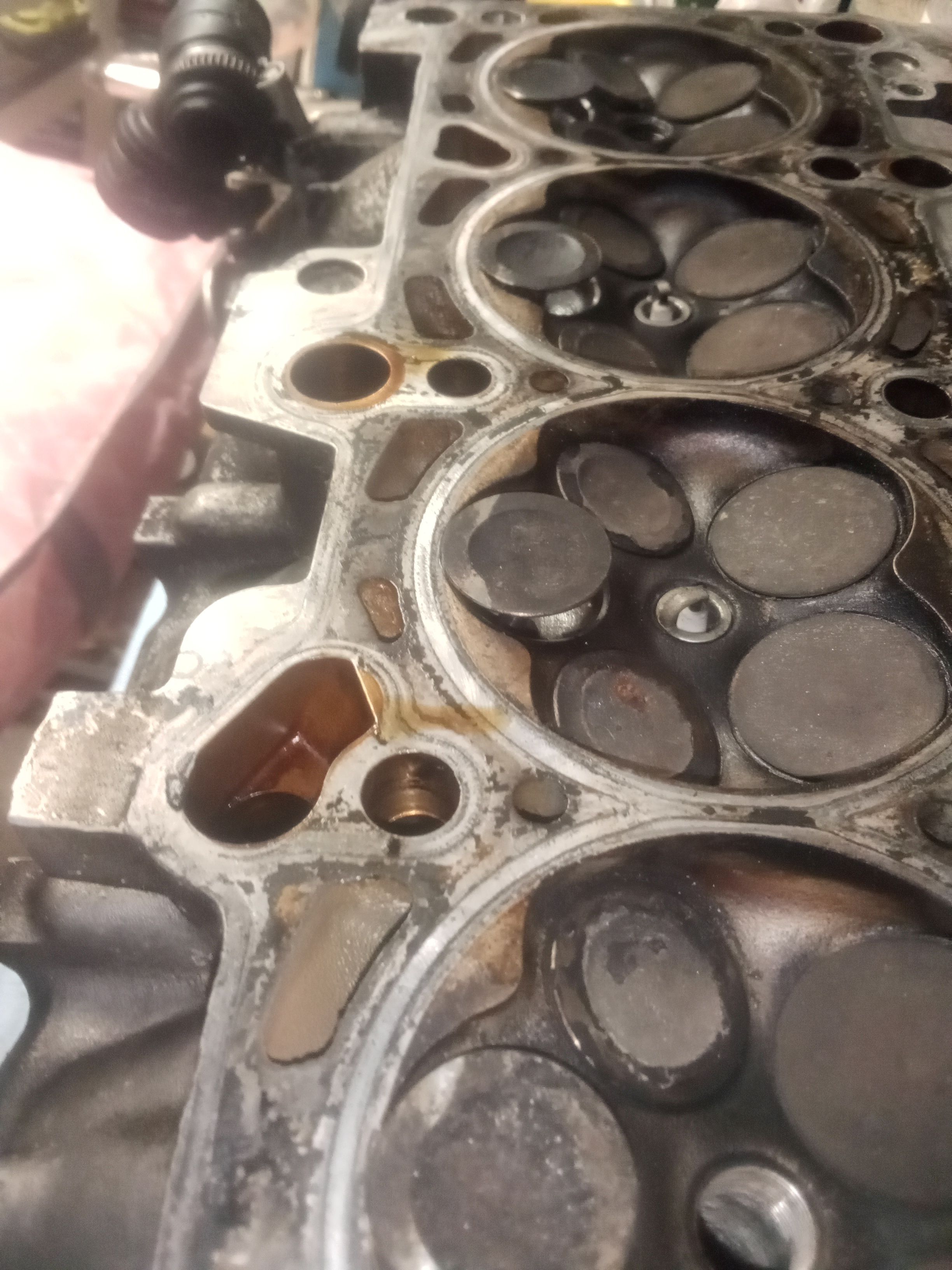

Dem be some bent valves... Stupid interference design...
Riddle me this, Batman... If VAG can utilize a CHAIN to drive the Intake Cam off of the Exhaust Cam, why the !@$#! don't they use a frigging CHAIN to drive the Exhaust Cam in the first place to avoid breakdowns and repairs like this?  GM did with the Quad-Four and 2.4L Twin Cam engines, just saying...>:(

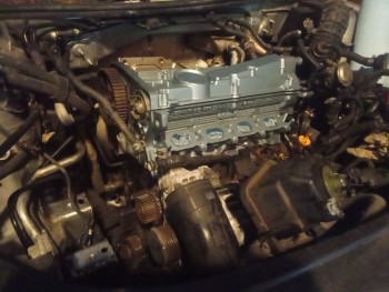

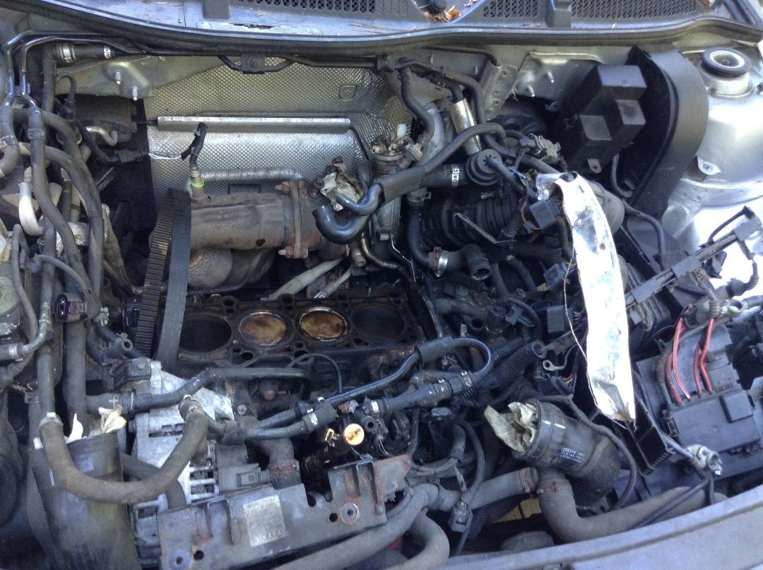

This is pretty much how it sits right now, except that I also installed a new Gates Belt, new tensioner, tensioner pulley, idler pulley, and water-pump. That was it PITA...

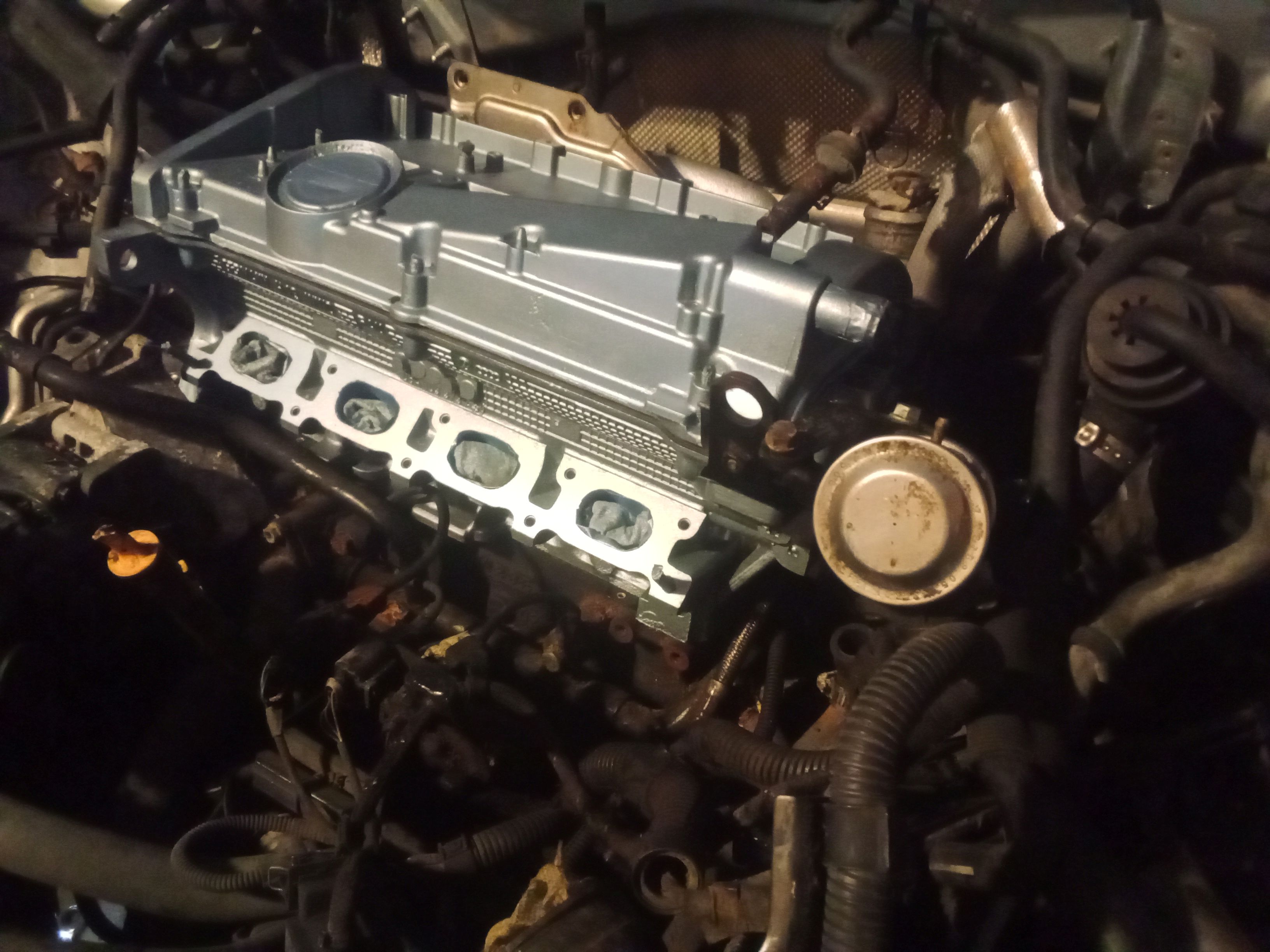

I felt terrible installing the freshly overhauled Cylinder Head, new valves, every inch cleaned, fresh paint, etc in that filthy bay, but since the car came to me with a loose head (it wasn't off, but was loose), I couldn't risk washing it and getting water in the block... but it WILL get cleaned! Fresh silicone hoses may be in order too, and upgraded aluminum coolant pipe fittings, to do away with the plastic trash.
