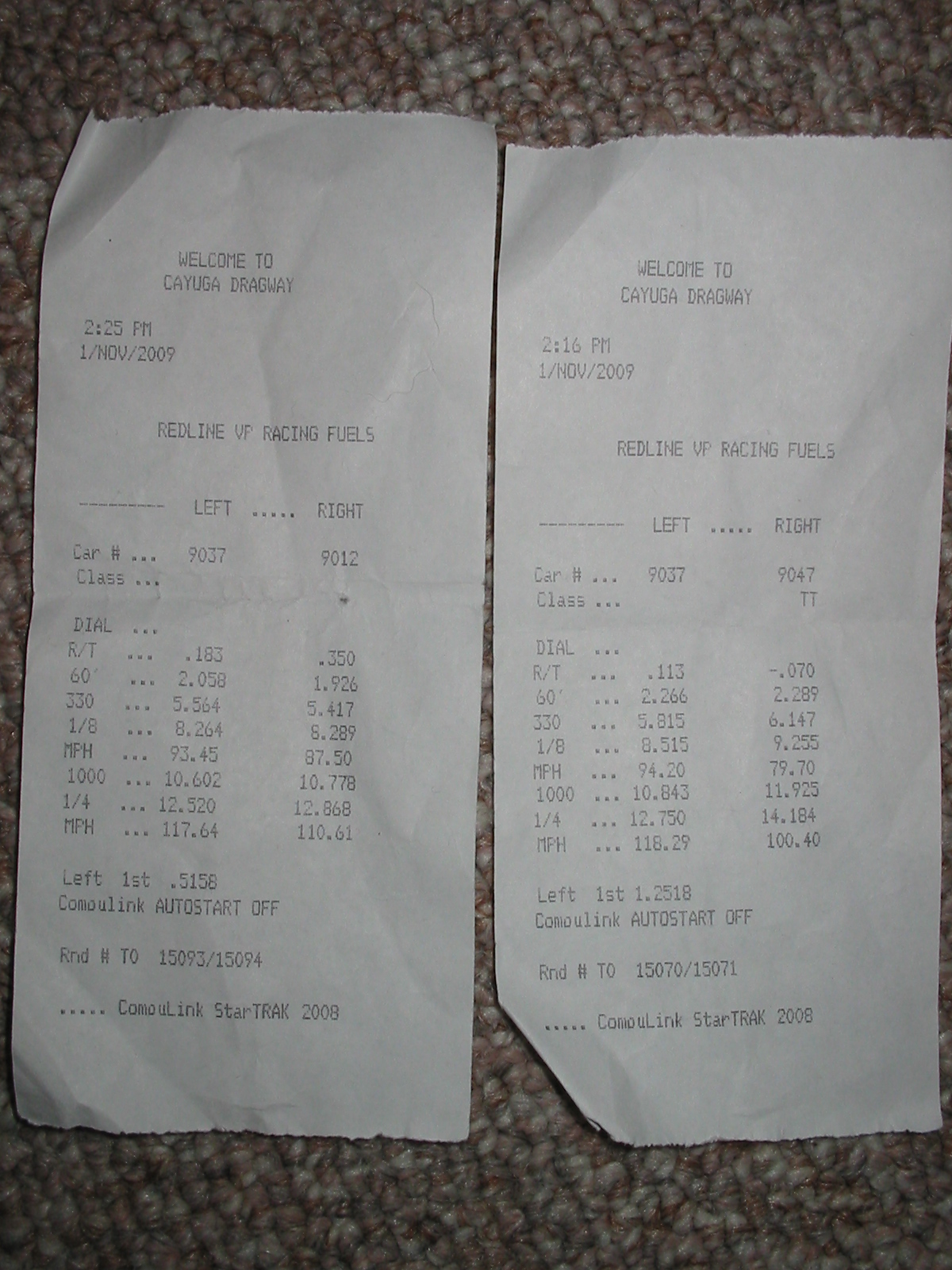

Here ya go.. on the left (9037)
On the 12.52 slip, the guy in the right lane was a magnum with quite a bit of work done to his car.. needless to say, he was pretty pissed off.. haha.
Re: Well I FINALLY broke it!
Man is that fast! Yeah I bet he about craped him self in anger.
I was there, and the guy in the Magnun (nice car with a few mods!) is STILL trying to figure out what the hell that was all about. LOL!!
Rodney's car is scary!
