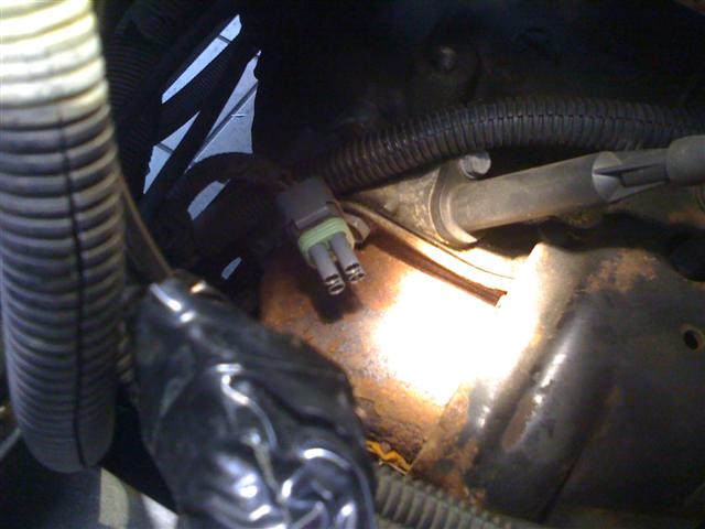

is this the connector you're talking about??
DTMAce
Posts: 3510
Location: Michigan EUP
Re: STALLS WHEN HIGH RPM'S
Post by DTMAce »
That looks like the one. As stated, this is the quick way to correct the problem, but you will not have converter lockup. What that means is you will have a bit worse fuel mileage with that unplugged, and could also cause a bit more heat for the transmission fluid as the converter will be slipping more that normal. Won't hurt anything for awhile, but in the long run it can cause more wear on the transmission, especially the torque converter.
To properly fix the problem, the TCC module that the connector plugged into needs to be replaced.
