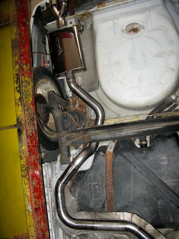

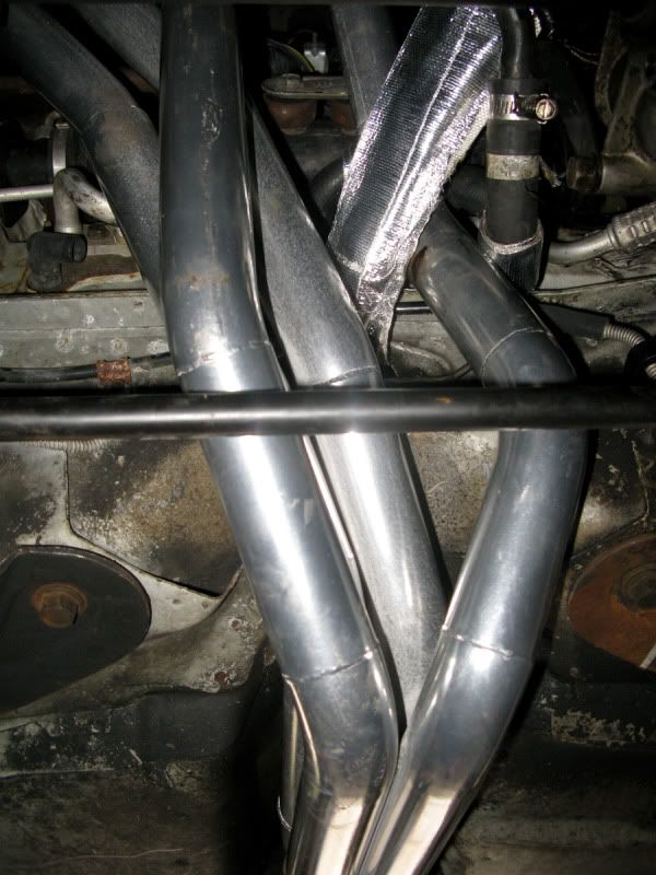

Post by uncle »

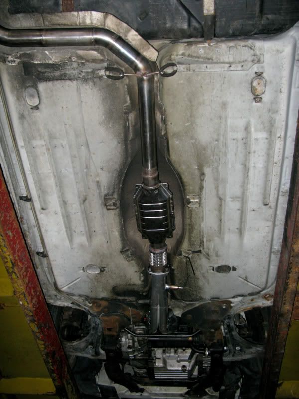

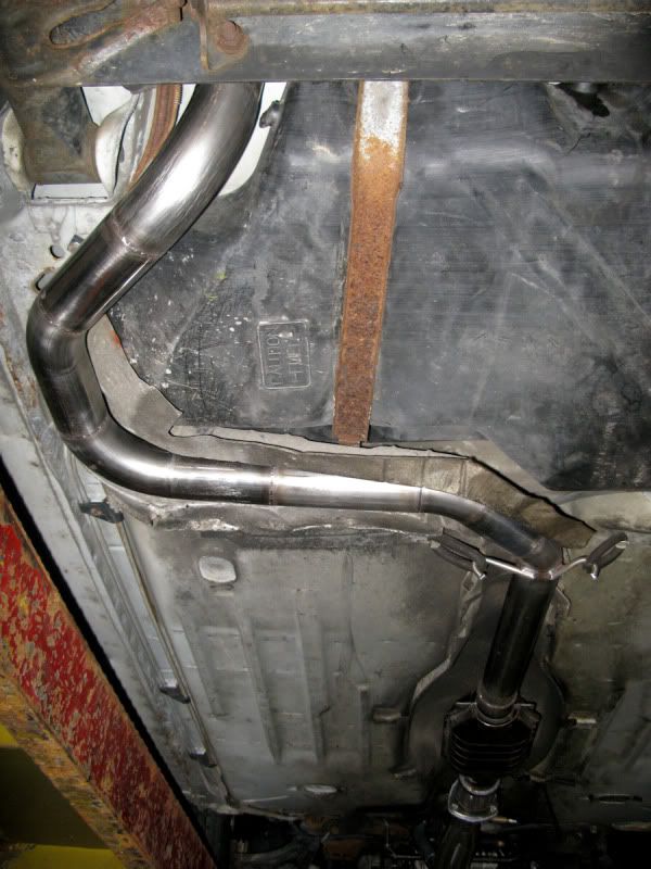

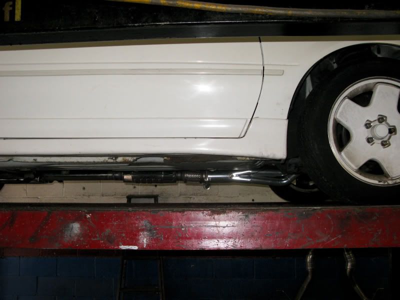

I finally got it back!
A couple of notes:

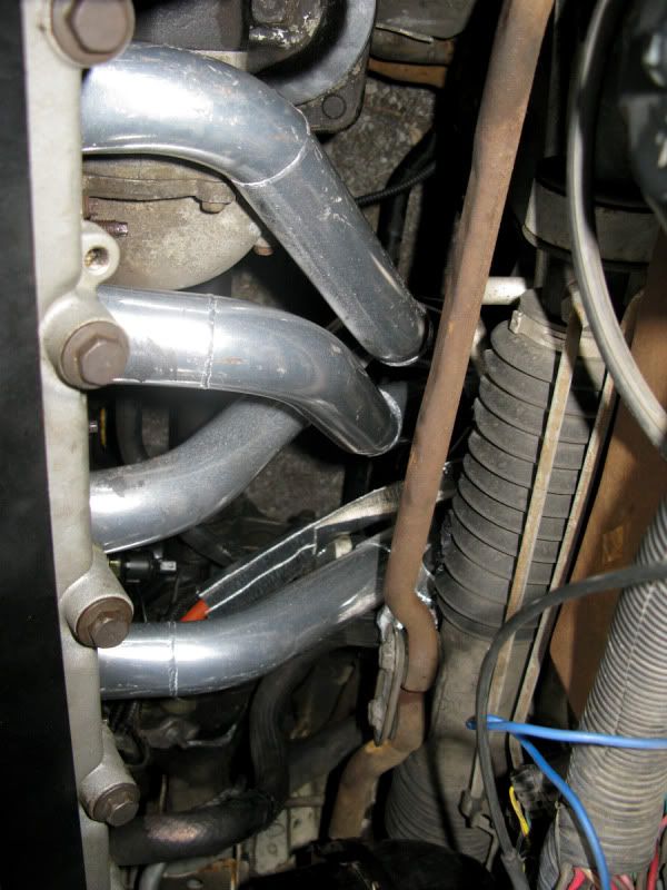

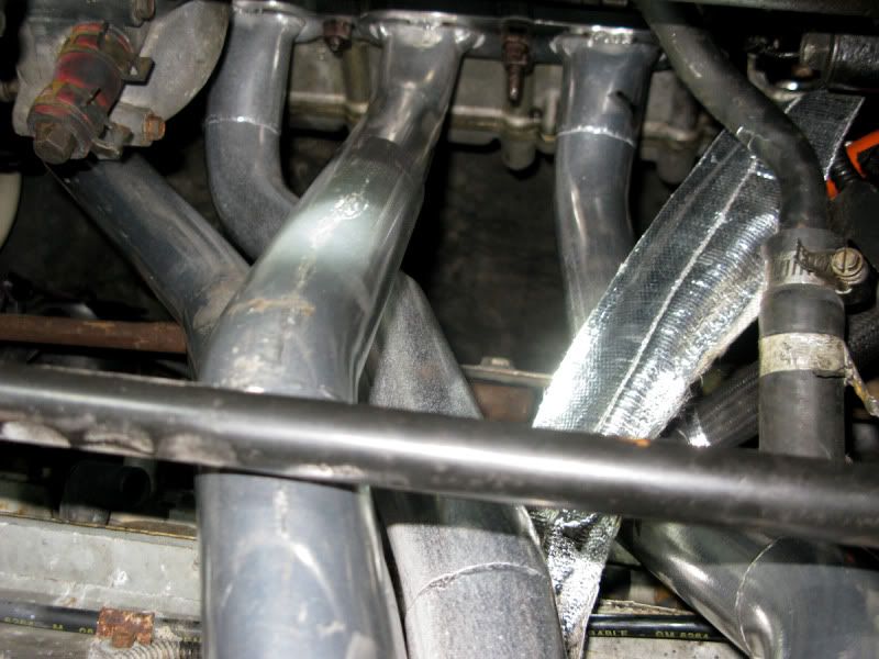

The installer said he was a little worried about the lack of clearance (less than an inch) in relation to the sway bar and that the header sits lower than it should/could. He also couldn't get the resonator welded up because it was too long and it wouldn't fit up in the tunnel.
And, as you can imagine, the Quad rocks now. It's quite a bit faster and since I haven't put my new TB on, it still has a vacuum leak but sounds a helluva lot better than the old system

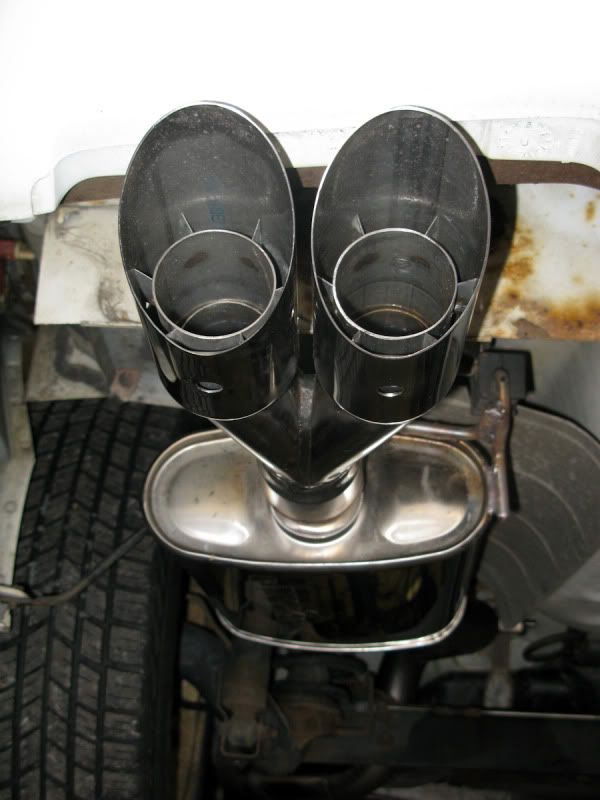

Where are you guys getting those tips? Saw them on woodys car too

Travelor
Posts: 508
Location: Neenah, WI
Re: '90 White Quad GTZ Resto
Post by Travelor »
Wow, looks nice, but you need to wrap them or your going to find out real quick that your power steering rack boot will be melting.

Tips:
http://www.borla.com/products/product_m ... ntercooled
I need to wrap a fuel line that by the coolant hose with something too. The guy at the shop said I may need to also wrap some asbestos on the shift cables since they ARE touching a runner. :shock:

weba
Posts: 1097
Location: Finland
Post by weba »
Exhaust looks well done. I spy couple badly rotten spots on the frame tho, those are going to need attention soon.

wicked-irocz
Posts: 1035
Location: South Central MN
Post by wicked-irocz »
The exhaust looks nice. The bends are a little tight to not reduce flow and I would put a 2.4 heat wrap on the rack ASAP as its already melted. All the quad headers hang down too far...
