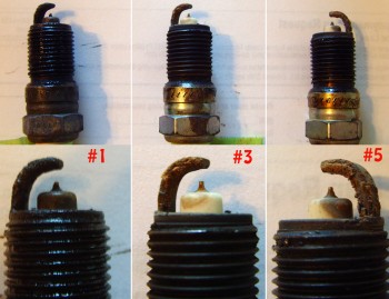

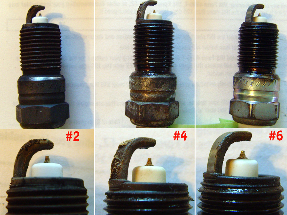

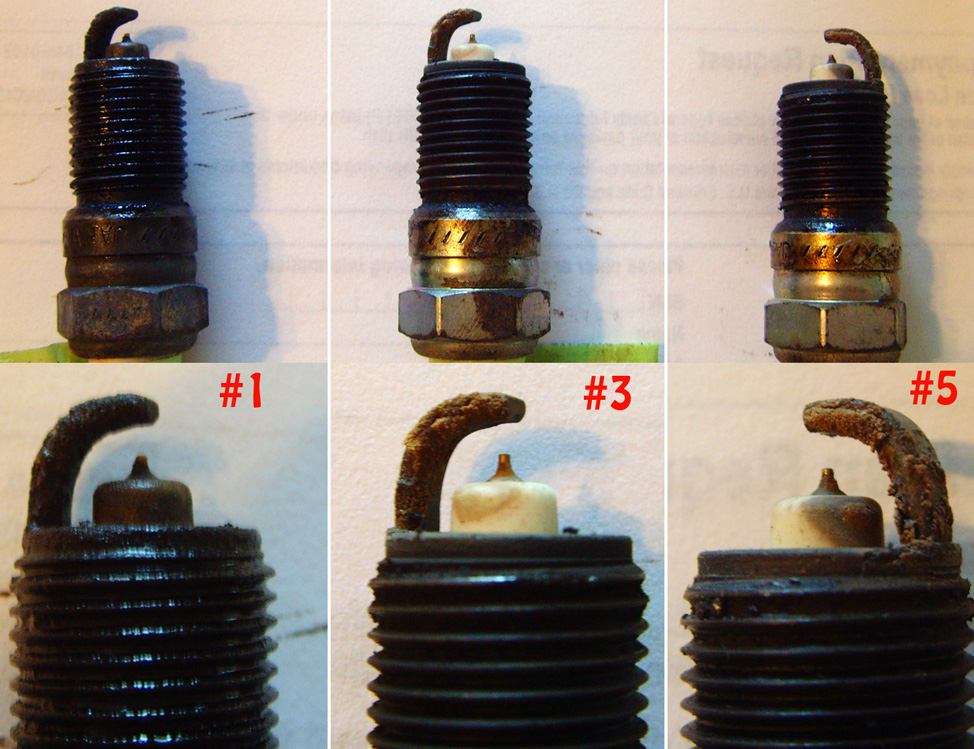

Beat my lame old record kind of, lol. Took me about an hour from start to finish... a little less if you don't count time spent hunting for certain tools. Now I'm just waiting on my wires, which I had passed off the pickup slip to my mom to grab on her way home. Then it's just a matter of hooking the wires up, putting the coil packs back on, and starting it up.
It was kind of terrible that all 3 rears were pretty easy to remove, which means all 3 weren't in there nice and tight. Whereas the front ones took decent pressure to break loose. I didn't use anti-seize lube last time (because I was dumb and didn't know better), but this time I did and all 6 went in easy. Putting the new ones in, the only one that was a real bitch was #5 because there's so much crap in the way that arms have to go at horrible angles.
Onto pics of the plugs! It was #1 that was really loose and #3 was reasonably loose too.

#2 looks way too white, almost like the injector isn't flowing enough fuel, and #1 obviously looks very oily.. I wonder if its dripping from the valve cover down into the threads and then being loose just got in the cylinder, either that or your loosing ring seal on that cylinder. The rest look pretty good color wise, if there were no deposits on them it would be best but this motor is far from low mileage so you cant expect nothing to be getting in the cylinders.

Ok, thanks for the analysis. I know that the power steering line that runs back there is leaky. Every time I was screwing around back there the back of my hand was getting wet from touching that PS line. Is it possible that's leaking down onto the plug? It's too cramped and dark for me to tell if anything else back there could be leaking. I know for sure that the front valve cover gasket has a tiny leak (drips from the gasket down along the engine between the seats for #2 & #4).
Edit: Turning the plugs over, the opposing sides of #2 & #6 both have a tan semi-circle on them. If that's the sign of fuel being burnt, then #2 has it, just not on the side that was facing the camera. My bad.

Those look like iridium plugs, are they?
Re: Some minor issues/questions...
I don't remember what they were. They were NGK's, but I'm too lazy to check them for a part number and look it up. Edit: Okay, I decided to not be lazy lol. They were TR55GP, platinum.
