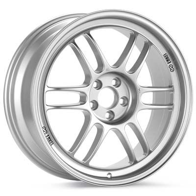

1. ENKEI RPF1 16x7
-this will upgrade my wheels from 15 to 16's without adding rotational weight....instead it takes away. my 15's are about 15-16lbs each. This is 13.7 lbs each!
-Another plus is that I can run a slimmer sidewall than possible on the 15's (load limits!) which in turn reduces sidewall roll on hard cornering. win/win

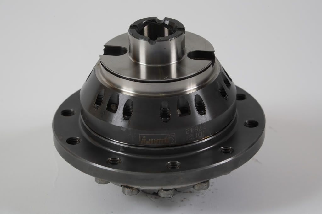

2. Quaife QDF2I ATB Differential
-Progressive differential that isn't full locking. I want this thing in or around my car now
-Downside, 900 bucks

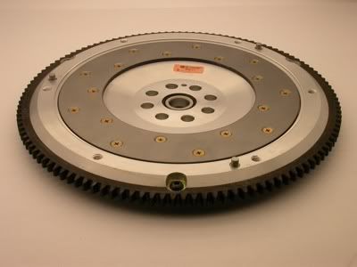

4. Fidenza lightweight flywheel
-a little over 1/2 the weight of the stock one=less rotational mass=quicker to rev up

Does Quaife actually make a diff for the trans you have?
They make it for the geo storm/isuzu impulse. Those run the same Isuzu MR8 transmission that the cavalier/sunfire/beretta 2.0/2.2 has. So it should be a fit.
The reason they made that at all were because the people at isuzone.org contacted them and made a group buy of like 10-15 units IIRC for around $750 a pop a few years back.

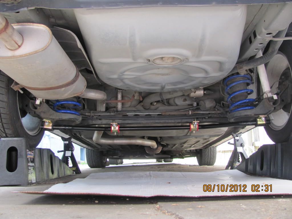

FINALLY got around to installing that big fat Addco rear sway bar. I'm AutoX'ing on Sunday and this will help me out immensely. Installation was surprisingly simple. So I took it for a test drive after installation and holy jennifer love hewitt! It's like I got punched in the face by awesomeness!
The car is wayyyy more stable and gives me much more confidence in corners now that body roll is mitigated. Of course there's a trade-off. Daily driving suffers from the increased torsional stiffness in the rear.
In all seriousness though, it's like my car is completely different than before!

How much did that swaybar cost? I never really thought of getting one for the GTU since they are solid beam rear axle suspension. So it's a pretty big improvement? Mine doesn't really have any noticeable body roll I can notice, but it certainly wouldn't hurt to put on on the rear!
It was around 200 bucks w/ shipping. It was a big improvement; on an on ramp today, the back end felt like it wanted to kick out if I applied enough throttle. Oversteer on a FWD car isn't the same as a rear wheel driver (alot trickier), so i definitely have to change my driving style to suit this newfound bias. Mind you, i was coming from a base beretta with NO sway bar (internal or external) in the rear period so the difference was alot greater.
