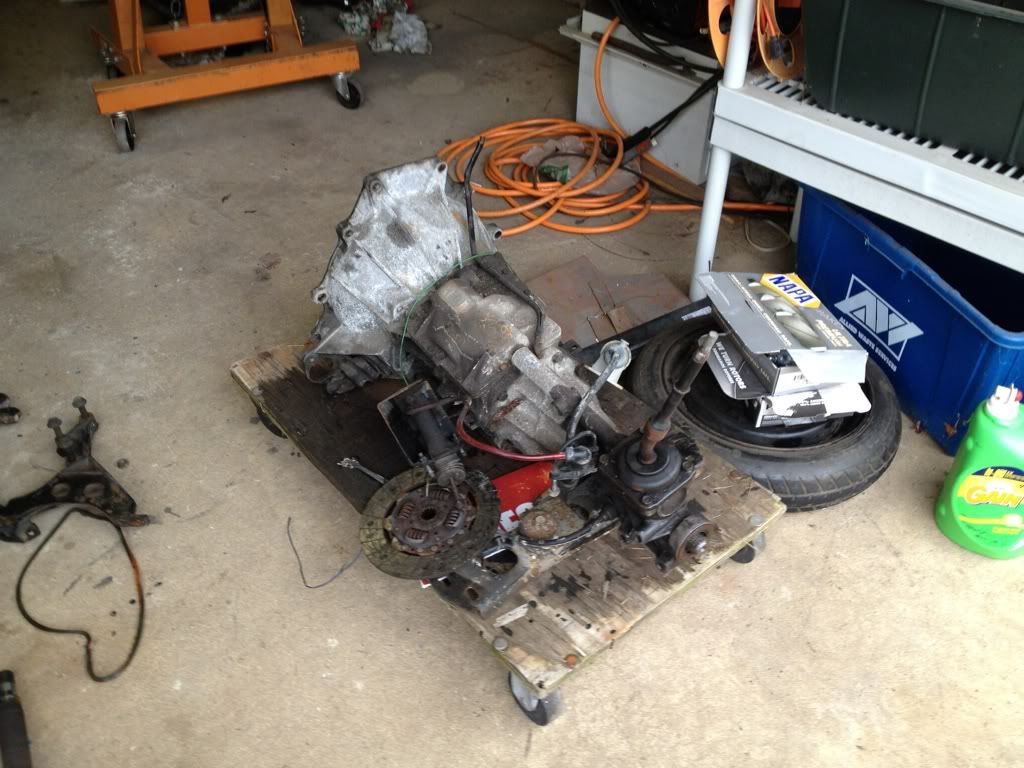

Got a trans and stuff.
Looks like I'm gonna loose heat and a/c. Kinda sucks I wanted to keep heat for winter events but oh we'll, bundle up I guess.
Gonna mount the motor and trans this week

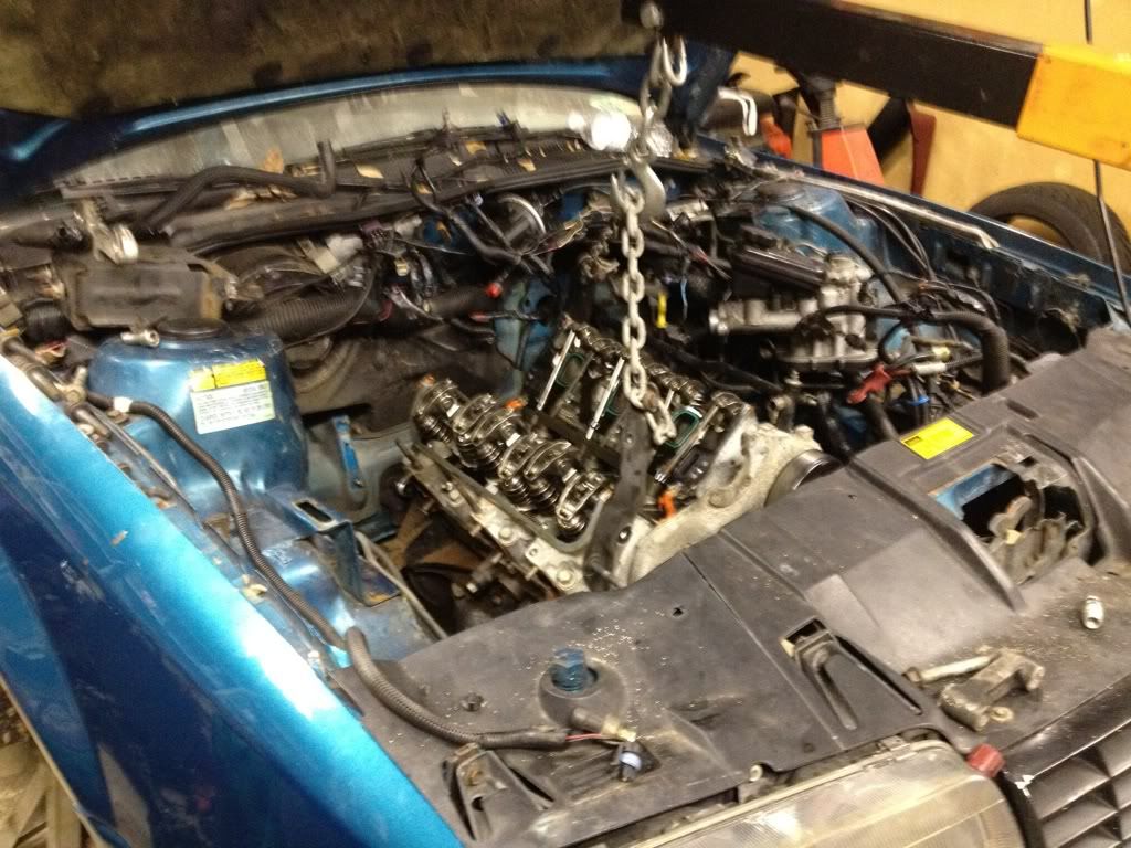

Re: Project: Slideways z26
how are you gonna mount it? using the factory body mounts or are you gonna put it on the subframe?
Right to the subframe. Will probably use hocky pucks. Poor mans motor mounts haha
what is the tranny out of? v6 camaro/fireturd? or s10/blazer? or something else?
With little creativity, you can still have the heat
I've actually been looking into a way to make atleast heat work from a different car still in the process of finding a sutable donor. you could always hack up two blower motor housing and fab the up right to the heater core and ac thing like dan did to his z24 on v6z24

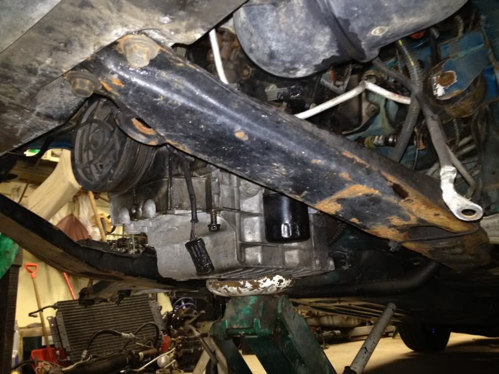

Looks like you will need to drop your sway bar out of the way though. Hopefully you won't have clearance issues with that?
The sway bar actually clears surprisingly. I'll probably have to pull it to get the motor in and out but oh we'll.
Trans is from a 88 camaro but the tailshaft is from a older one so it's a cable driven speedo. I'll look into that one later
wow.. you left the hood on? removing that thing will make your life 1,000 times easier man.
