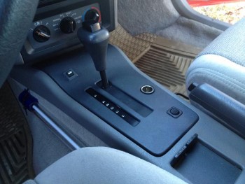

Here is one of the additions I made back in 2011 for the strip as I was hitting my speed limiter. Works Great and is yet another mod that was done without any cutting or splicing in the factory harness.

Just cuts the VSS signal once you're in 3rd gear I assume?

Yup woody.

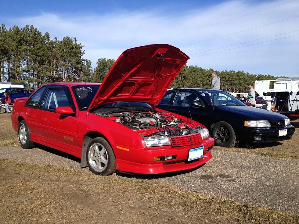

No plans for the big runner setup yet. I'm making 278 hp without it and the limiting factor with the engine is the valvesprings right now. I might do the big runner setup in the future. I have other plans for this summer. I found out the 20" slicks were not loading the turbo enough so I should have ran another tenth faster by just running the 22's.
