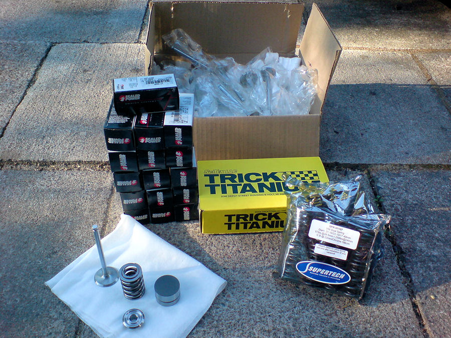

Update
I got the goodies I've been waiting for months, now if i can get the required head work and custom parts made in time, i may be able to drive some before snow falls again. Lets see :)

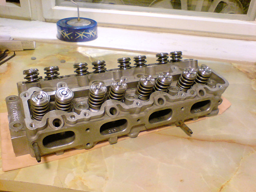

hopefully that head will liven up the car some it also looks like it has some nice port work done too

Re: the white car project
Looks nice. No porting? I still see some numbers.
weba
Posts: 1096
Location: Finland
Post by weba »

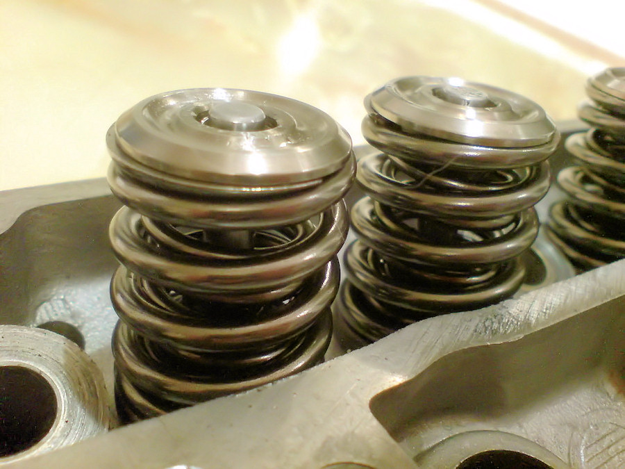

No porting done to it, just cleaning. The 086 is very good flowing from the start, it really doesn't need to be ported. Not meaning that it would hurt when done right, except rigidity with the material removed. But as i noted, these heads don't need that kinda work.
Here professional port is kinda expensive, so with the Gain Vs Cost be'ing minimal, i decided to skip it for now, the biggest restriction is elsewhere on my system (stock intake and t\b, injectors and fuel pump maxing out)
For some reason they also shaved the head again, even if i told that it was already shaved, Let's hope i am not going to have too much compression with -0.2 and -0.08 shaves %)
This head also has tiny cracks between the valves and spark plug holes in couple of the cylinders, like in most the 086 heads out there, but the head has been pressure and vacuum tested (twice?) and it's good to go.
Cool thanks for the info on the head. I would be thinking about the piston to valve clearance. I did see the number on the bottom in the pic and thought you just wanted to be sure it was flat.
