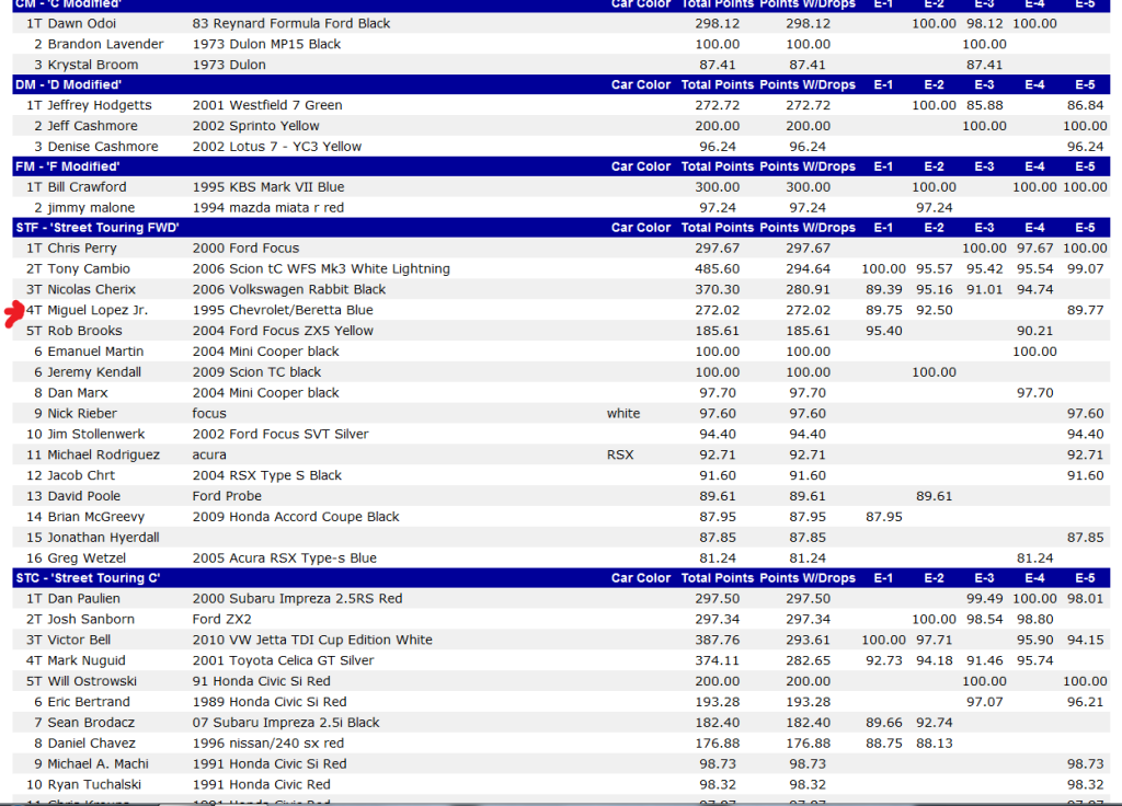

So I noticed that I'm in a trophy spot for the Chicago Region, running in 4th place overall in class for the season. Hopefully I can finish strong to keep it! If my car can pull it off, we're celebrating, Break out the Royal Purple!

That is awesome! keep up the good work! Imagine what it would do with a hot quad-4 thoughAmateur wrote:So I noticed that I'm in a trophy spot for the Chicago Region, running in 4th place overall in class for the season. Hopefully I can finish strong to keep it! If my car can pull it off, we're celebrating, Break out the Royal Purple!

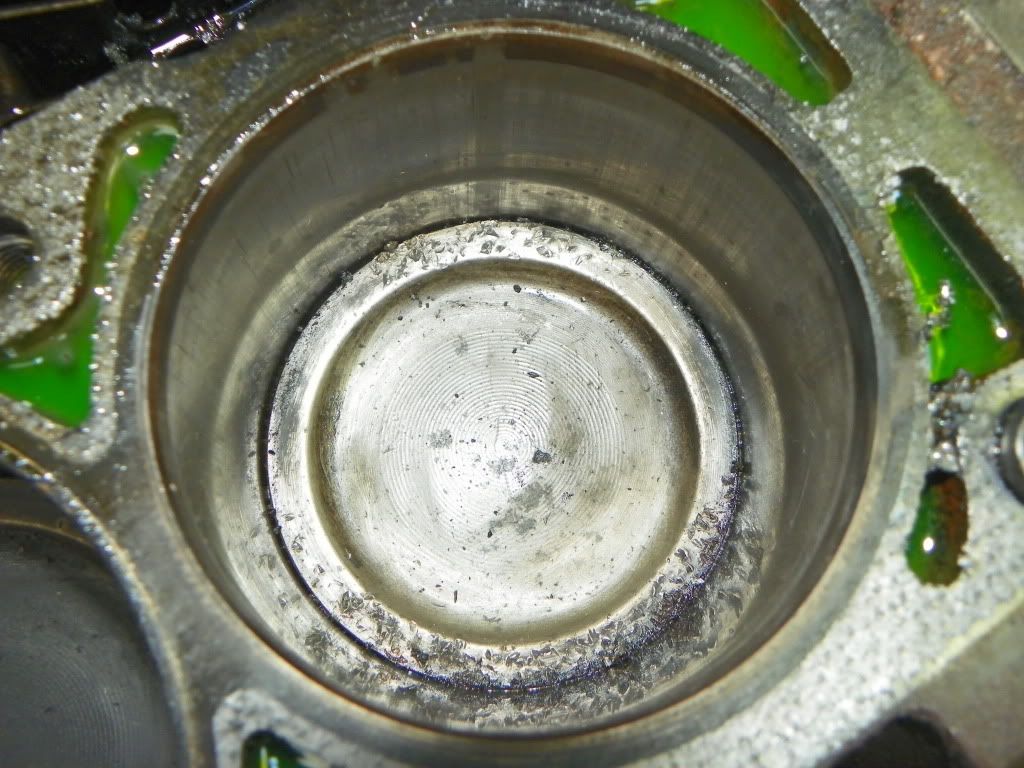

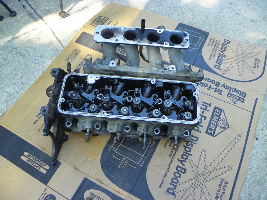

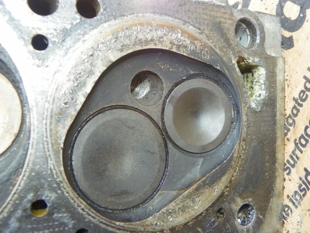

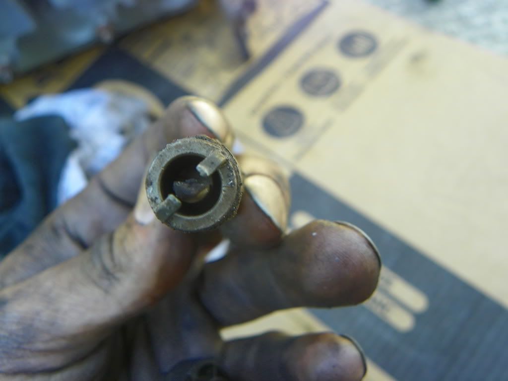

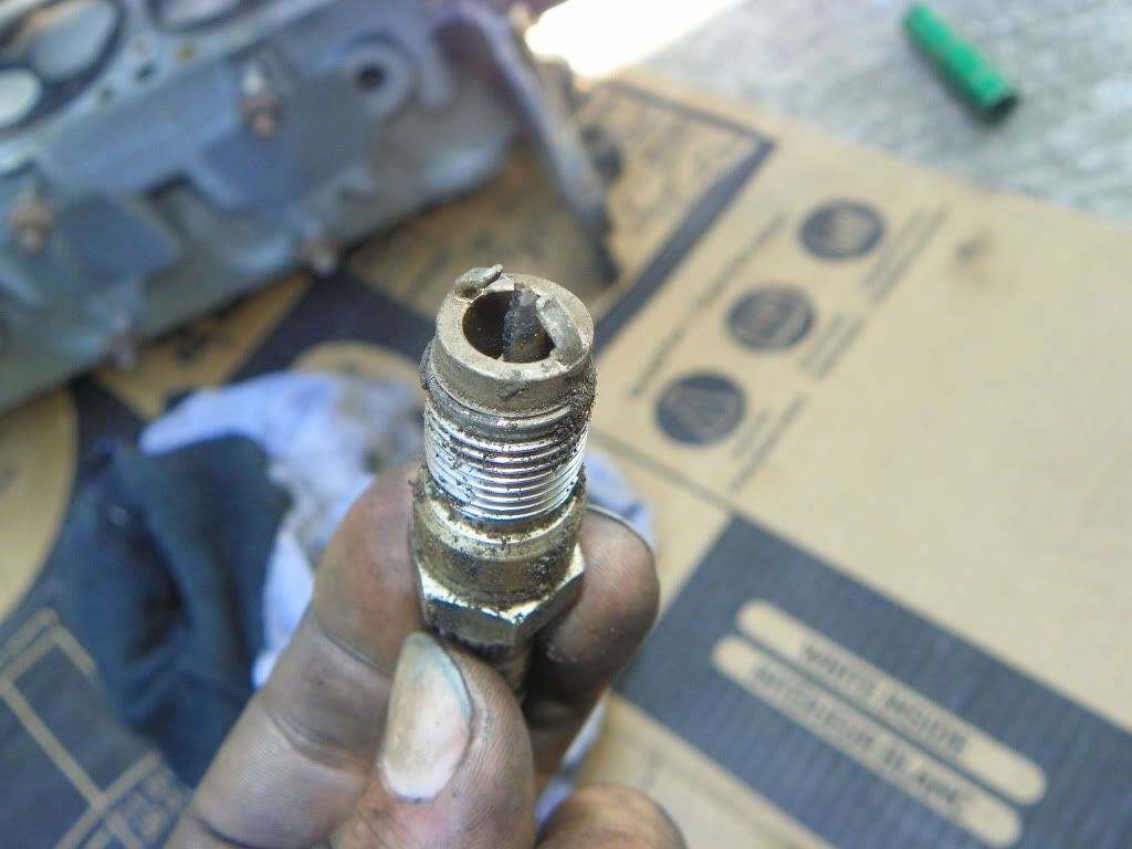

So The whole motor dying at idle is over with. Turns out a fresh set of spark plug wires did the trick. On that though, My motor only runs rough in the mornings when I first turn it on. The culprit, Mr. headgasket. It's a slow leak of antifreeze to the cylinder chamber but all the signs are there. White exhaust smoke as it burns the antifreeze; Checked my spark plugs and there's a build up of light chalky stuff. Added to my to do list.
Re: Chevy Beretta FF
Looks like some detonation happened that fragged cylinder 4 real good and annihilated the spark plug for it. Other than that, everything looks really good and surprisingly clean inside. The engine runs silky smooth despite explosionfest. Remember, these engines never die. This should hold me over until I drop in a better one later.
