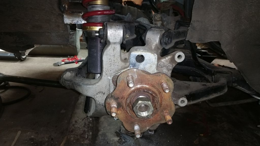

aluminum 300zx

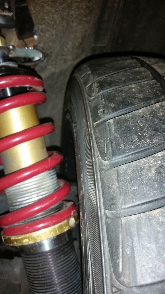

steel/iron, whatever it is lol. s14. looks like its not quite 7lbs difference like I thought. I think thats what I read anyways.
just sitting on the lower mount, no rotors. looks like I will have plenty of spacing between the tire now.
and thats the progress of the past few hours. once I get more gas for the welder ill build some quick upper mounts for the coilovers, drill the lower rubber mount to get the adapter in and mounted (holding off and getting the aluminum "bushing" pressed in for now), figure out a sleeve setup so I can use a smaller bolt in the adapter.. then recheck the rear roll center, and possibly lower the rear subframe a hair. Then double check the front roll center, build some sort of quick coilover mount, then its frame time!

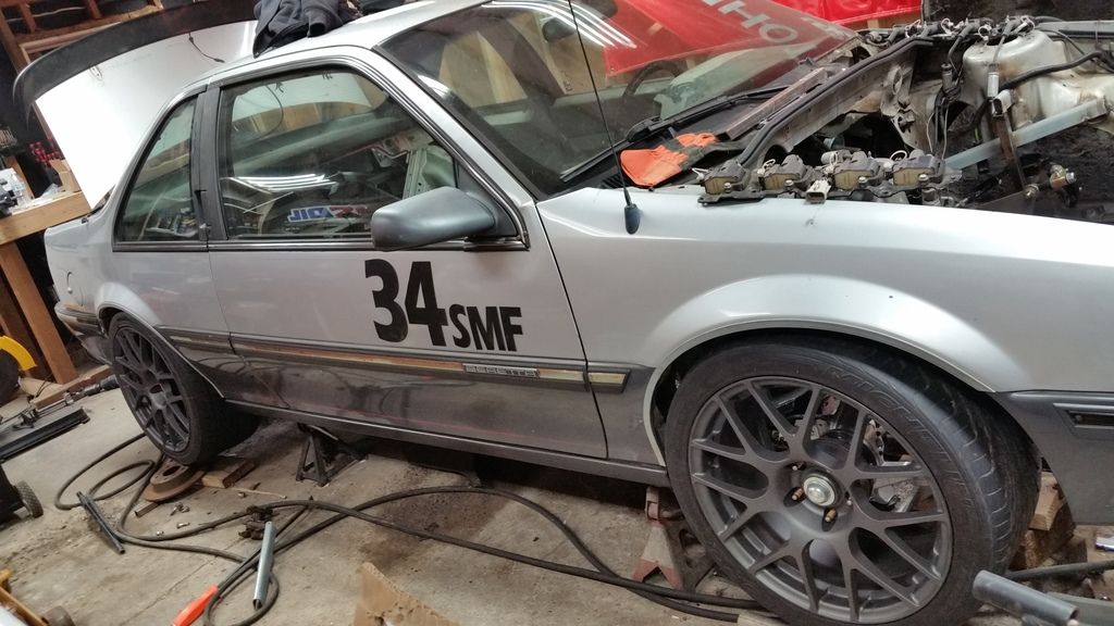

Alignment fun.. Caster was Not where I expected! I put about 5* in, and it moved the wheel back about an inch lol. so.. front end gets a 1" shift forward, which is always good! I decided im going to make the front subframe a bolt in, with slotted holes for adjustment to move the wheels back to the center after changing the caster. I have that about 95% designed on how im going to do it.

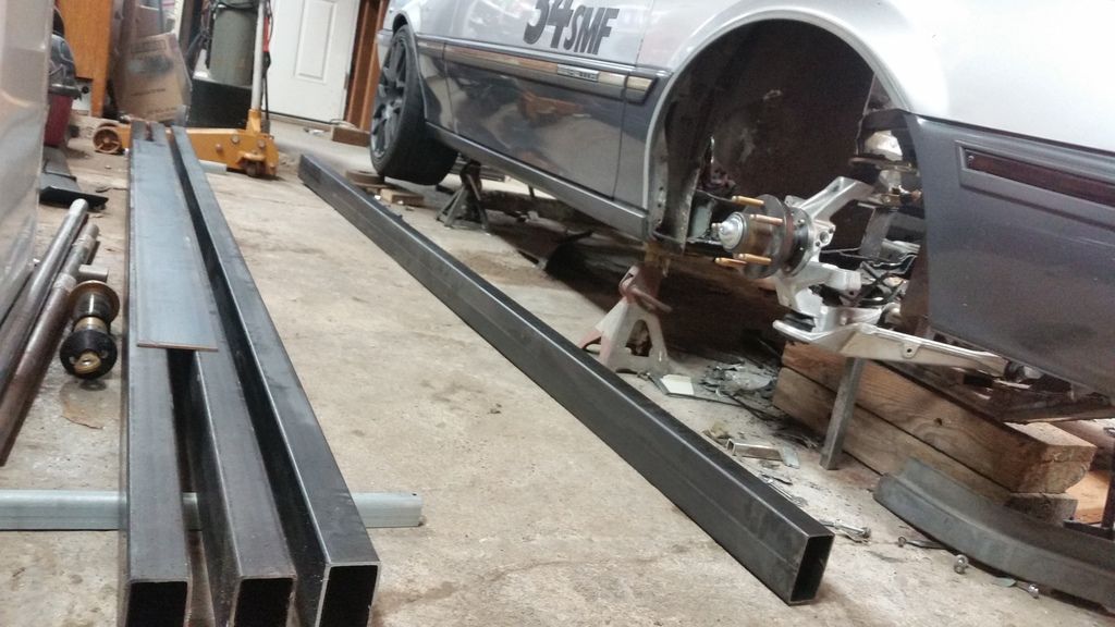

40' of 2x4 .120 wall (1/8").
It begins

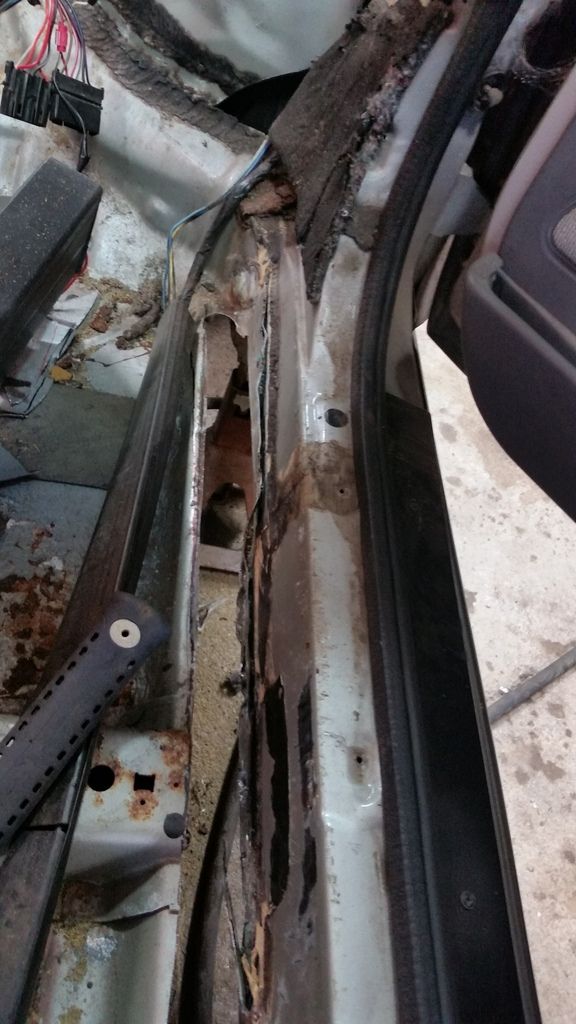

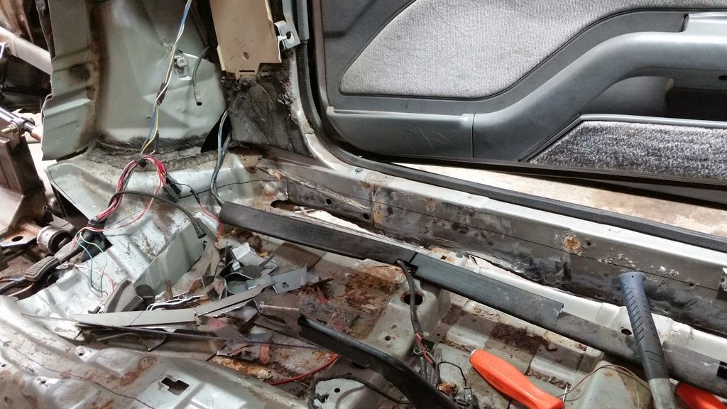

disassembly of the pinch weld..
Rest in peace..
black line is the top of where the frame is going
cleaned up for the most part. Just need to order some rustmort to kill the rust, and prep the metal. Minor fitting to do still also.. and get a for sure plan for the left turn up front.
