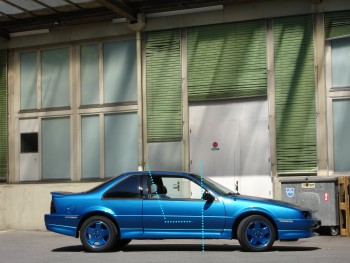

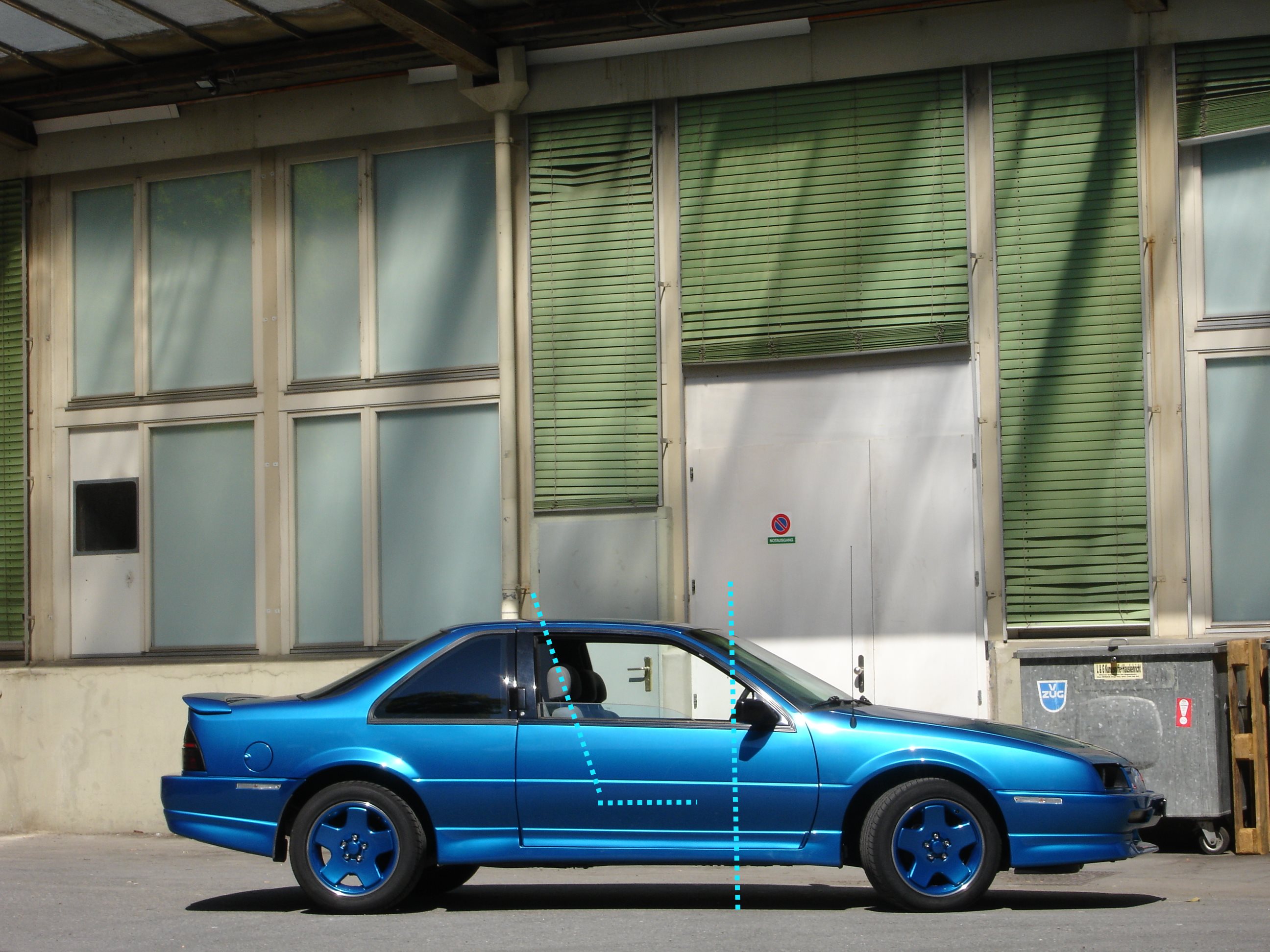

Center of front hub to bottom of steering wheel in driving position is ~43"
Center of hub to shift knob in neutral is ~40"
This is as measured from outside the car.
FWIW.

I also think the seating position wont be off a lot, if at all...
Beretta driving position is pretty much in the middle.

@ Asylum and GTZfan : Thanks for the measurements and the comparison pics.....from my "eyeball" side view measurement with a tape measure the hub to the steering wheel and shifter seems to be aprox 45 in...... so really only 2 inches further back than the Beretta steering wheel and 5 inches further back than the beretta shifter.
so @ bonecrusher the difference in seating position will be pushed back a little but defiantly not look ridiculous.....like opening the door and driving from the back seat......hahahahah.... but i defiantly had wondered about that...... and everything will maintain the relationship to each other because im using all Camaro steering column, shifter and seat.....

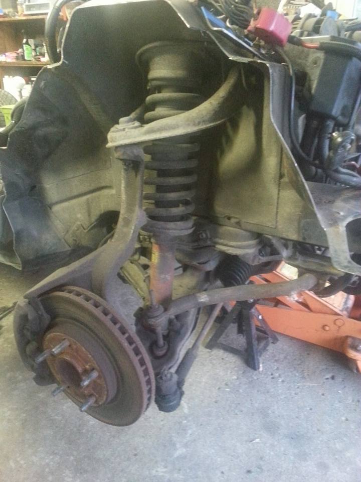

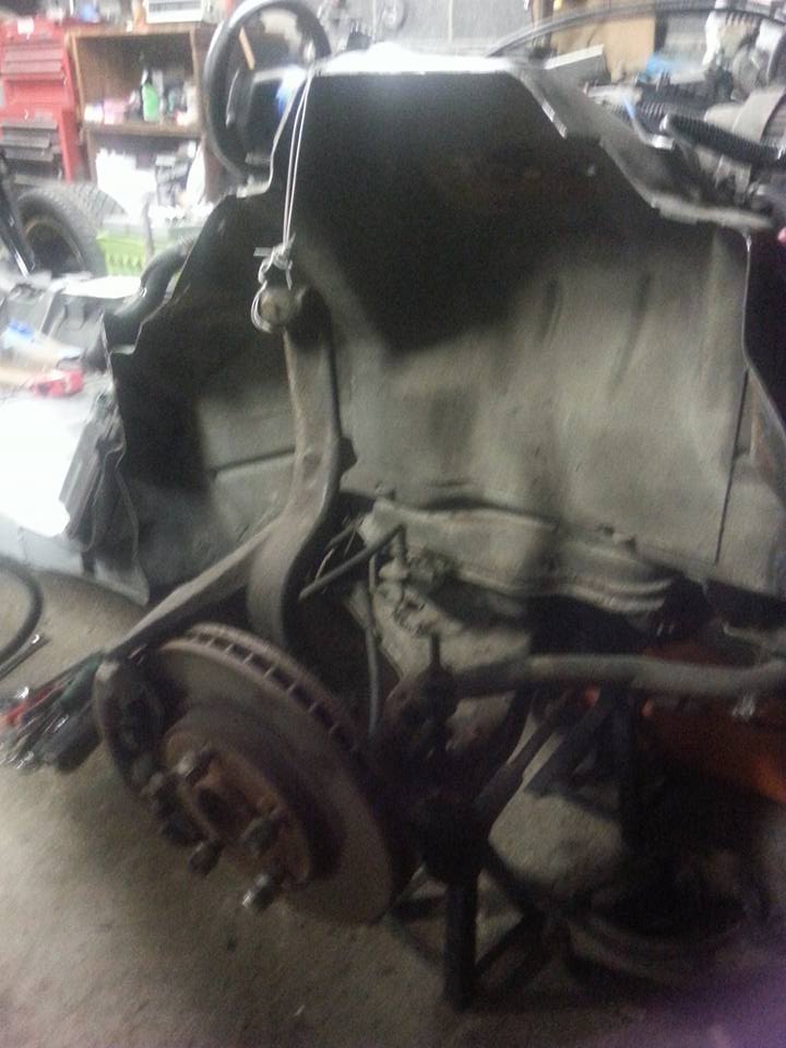

well the roller didnt last long..........Removed front suspension in prep for the new 1" lowering springs .....which I am afraid wont be low enough and Stiff enough........... might see if there are some spring and shock combo that will be more like a 2 or 3 in drop........what to do??????
Re: Beretta Z28
Chopping down the perches to accommodate aftermarket coil-overs made for another platform mike suffice? Shocks are not hard to custom order, just expect 600 for a pair made to fit for a decent pair.
