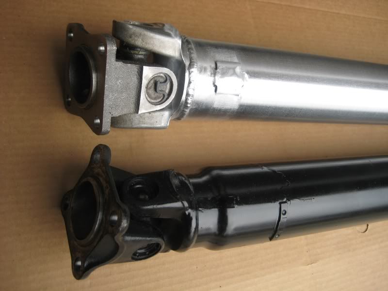

Barry wrote:Nissan uses a 4 bolt flange on the diff and the u joint looks non replaceable
They are removable and replaceable, but they are pressed in. The Driveshaft Shop INC. makes aftermarket 1 piece driveshafts for 240's with the 4 bolt flange included, and they might sell you that piece separately. Otherwise, you can have your old u-joint pressed out of the flange, and have it modified to accept the normal style u-joints that are secured with the spring clip.

Yeah that's it. I'm just taking my camaro shaft and my Nissan shaft to the shop and telling them to make this work

Barry, Measure the distance you need to cover plus and minus too since some say to find one that fits then put your motor in... and then let Brett go look for a shaft of that length with the GM output on the front and then find a conversion U-Joint that works with that, since we have no idea what we are talking about. I highly doubt he'll find a working combo.

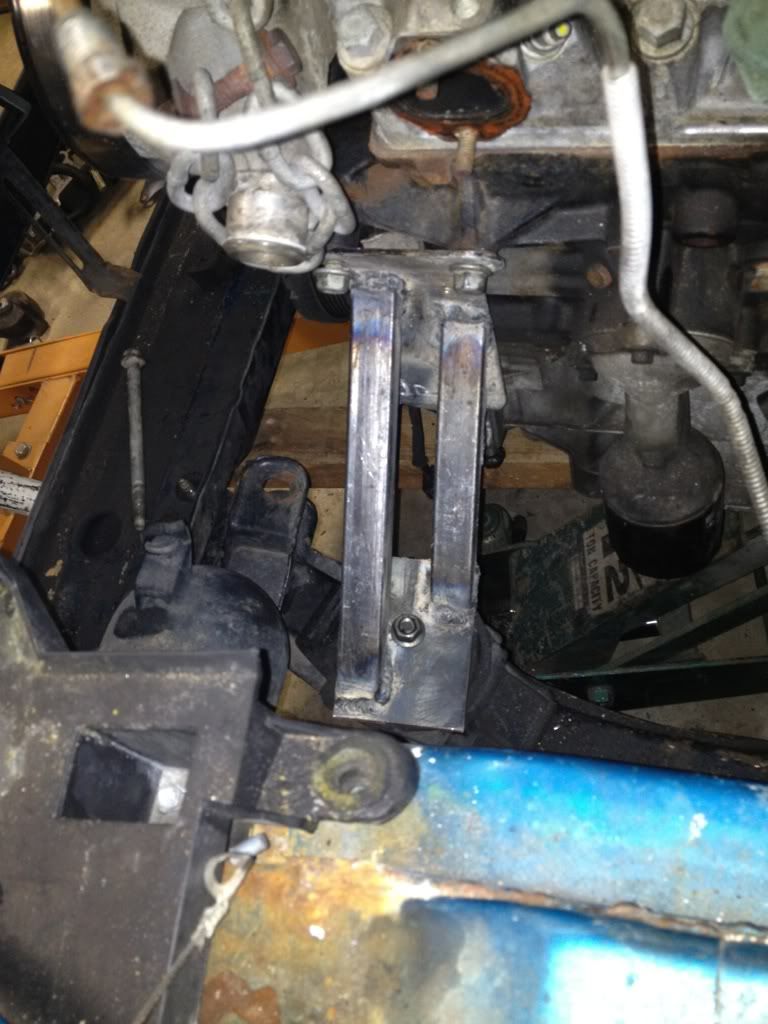

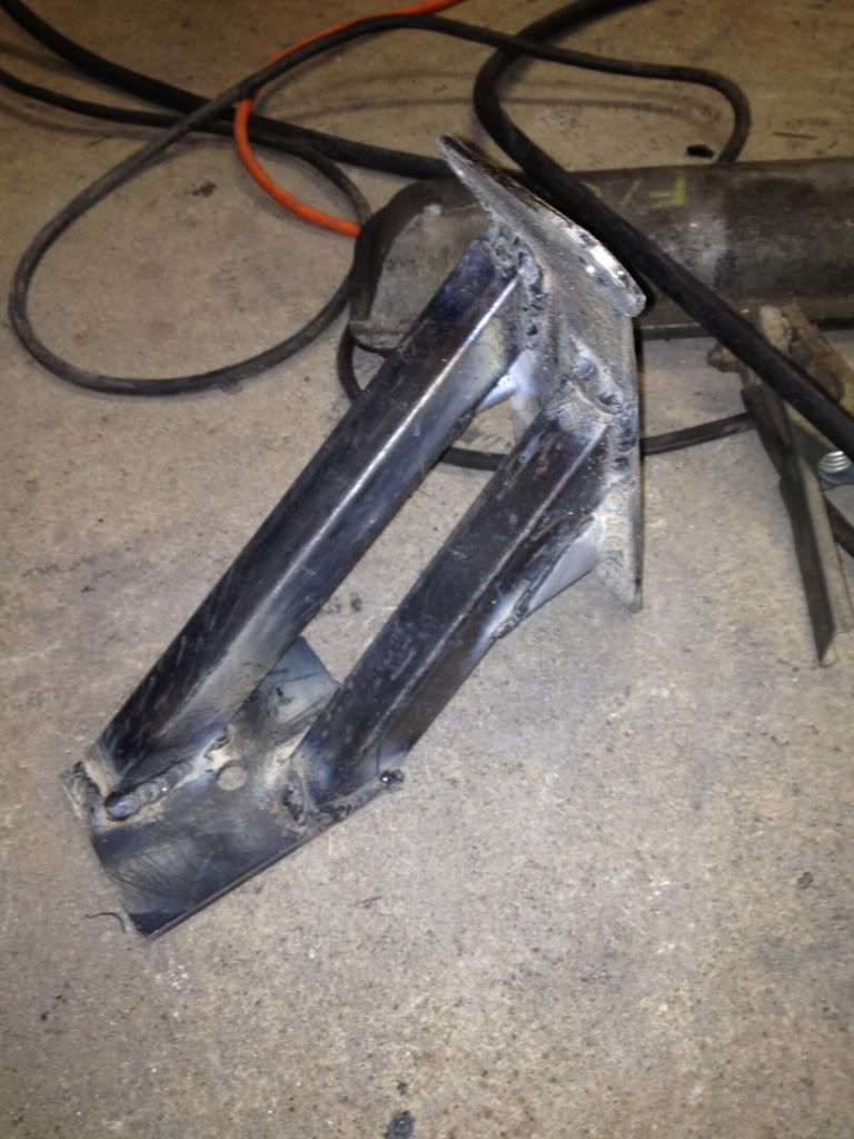

Made a motor mount. Its a stock 240 mount on the subframe, then custom up to the 3500, mounting on the A/C compressor bosses.
Still need to do the passenger one and decide if I want to get aftermarket 240 mounts or just use hockey pucks.

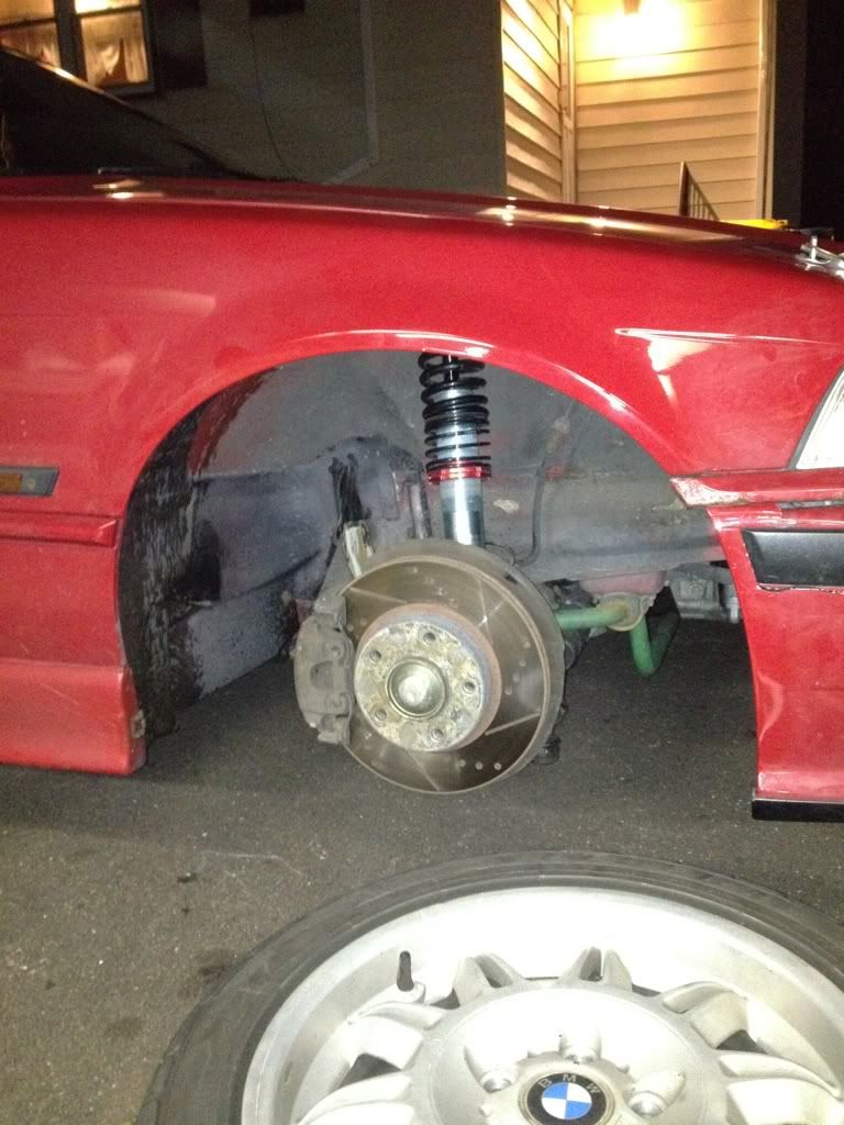

Been busy maintaining and modding and beating on the bimmer.

Hell yeah china! Read my review on bimmer forums if your curious what im doing with them

Do you have a link? I forget what your SN is over there...
I'm thinking about using a set of the fronts for air ride. :twisted:
