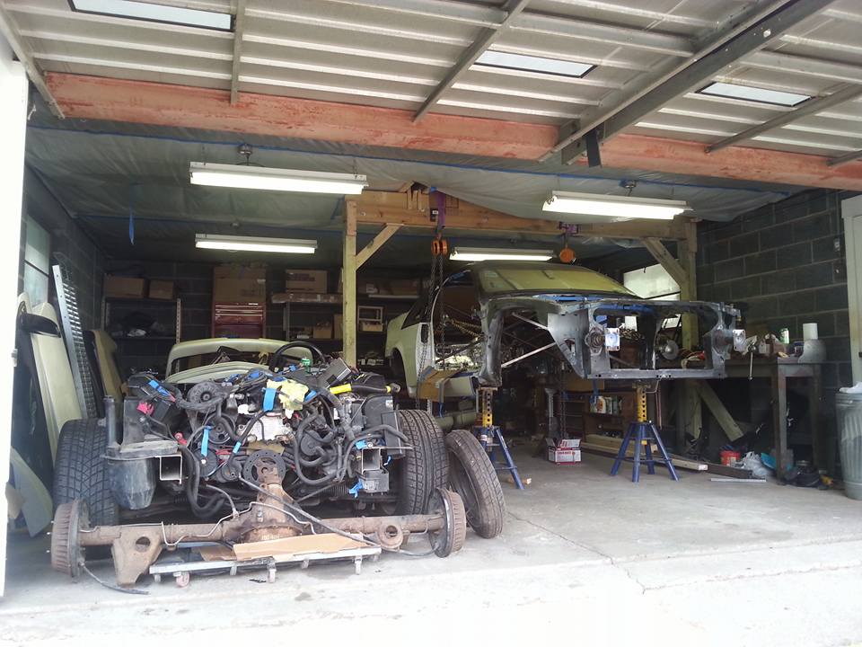

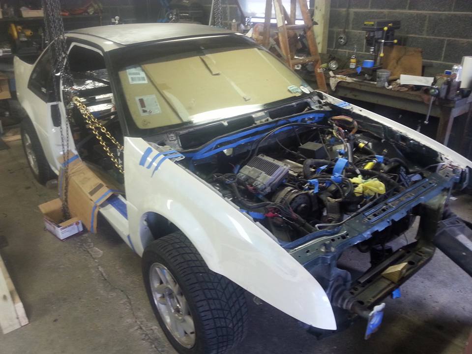

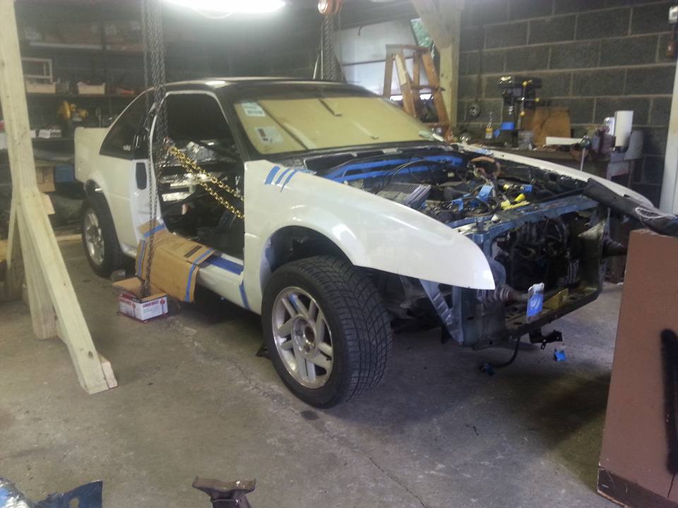

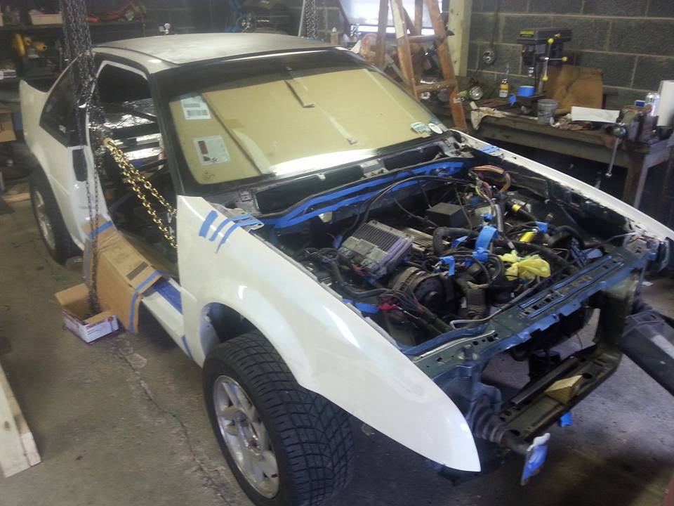

The Beretta body transplant is underway. Got a few areas to trim back and cut out to get it down on the frame but its on its way to being one!!!!!!!!

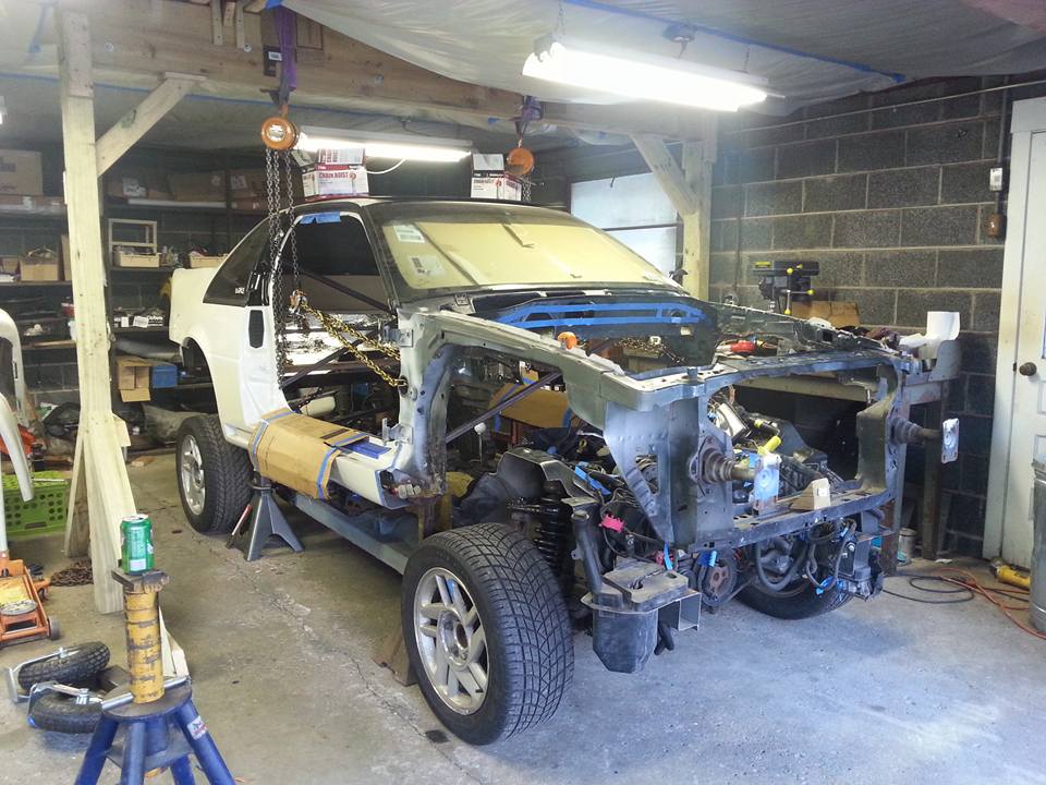

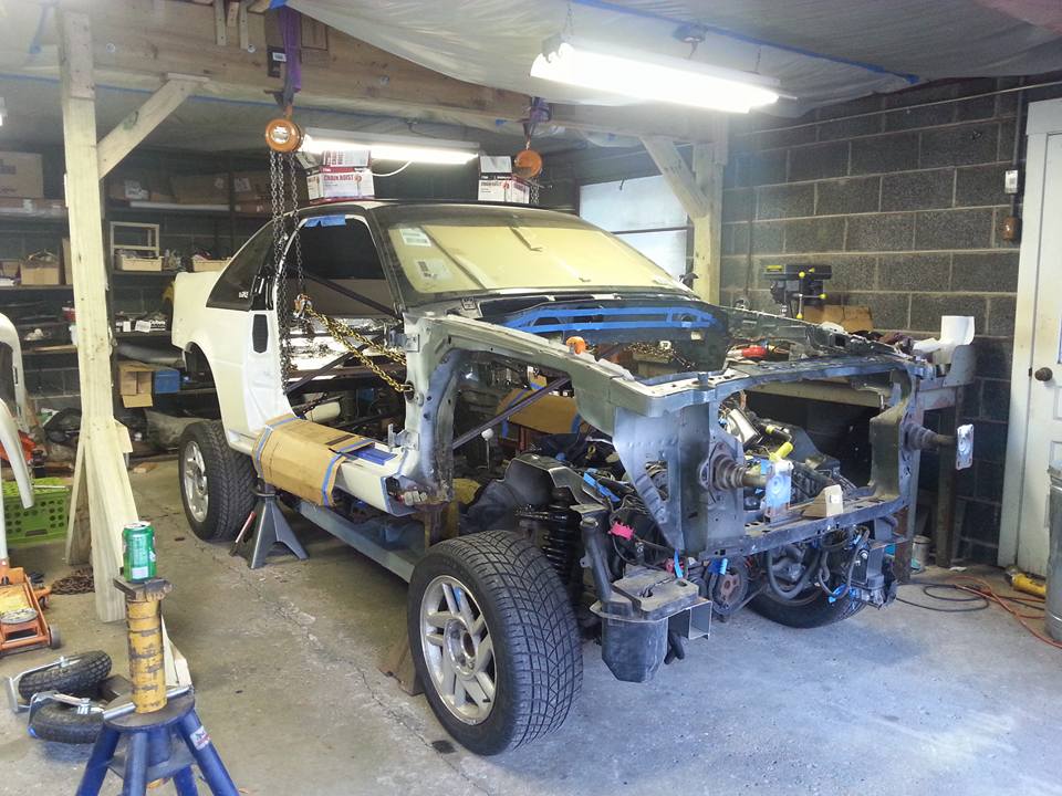

trimmed all the remaining floorpan sections out along the beretta inner rocker and had to cut out the inner of the rear wheel tubs completely out , but got her down another 10 inches. A lil more trimming on the wiper cowl to clear the brake booster and upper intake and she will be sitting at the proper ride height ....shooting for a inch ish of jounce/wheel to fender gap. ......Im really hoping to not have to loose the wipers while trimming the bottom of the cowl but i will see soon enough....... as is i believe i will have to relocate the wiper motor already ..... about 5 more inches and she will be sitting at the proper ride height. things are lining up fairly well think its really gonna work out

The problem might not be where to mount the wiper motor but more so making sure the arms that go from the motor to the wipers have enough room to articulate .....gotta just start cutting and seeing what I can get away with

Re: Beretta Z28
Couple questions...
-Are the front wheels gonna be able to fit okay lock to lock in the Beretta fender opening?
-From what i can see, it looks like the wheels will be sticking out about an inch. Were there plans of a slight wide-body modification?
-What are you doing about the blower motor area/motor?
-On the wiper matter, check out the 88-94 J-bodies. The have theirs mid-firewall mounted. Might give ya an option for stock mounting.
I see the camaro from rails appear to line up with the Beretta frame rails...badass! I cant wait to see this beast rollin on its own power!

Have not tried to articulate wheels with fender on yet but not expecring any major issues....definitely gonna have some tBerettaf wide body fender flares or lips In both the front and rear .....there will probably be about 2 inch flare to get fenders to sit flush with the rim offset.....and I will definitely check out that jbody wiper set up ...thanks
As for the frame rails the uni body rails of the camaro sat about 48" wide which just fits into the inner rockers of the Beretta which happen to be about 50"
