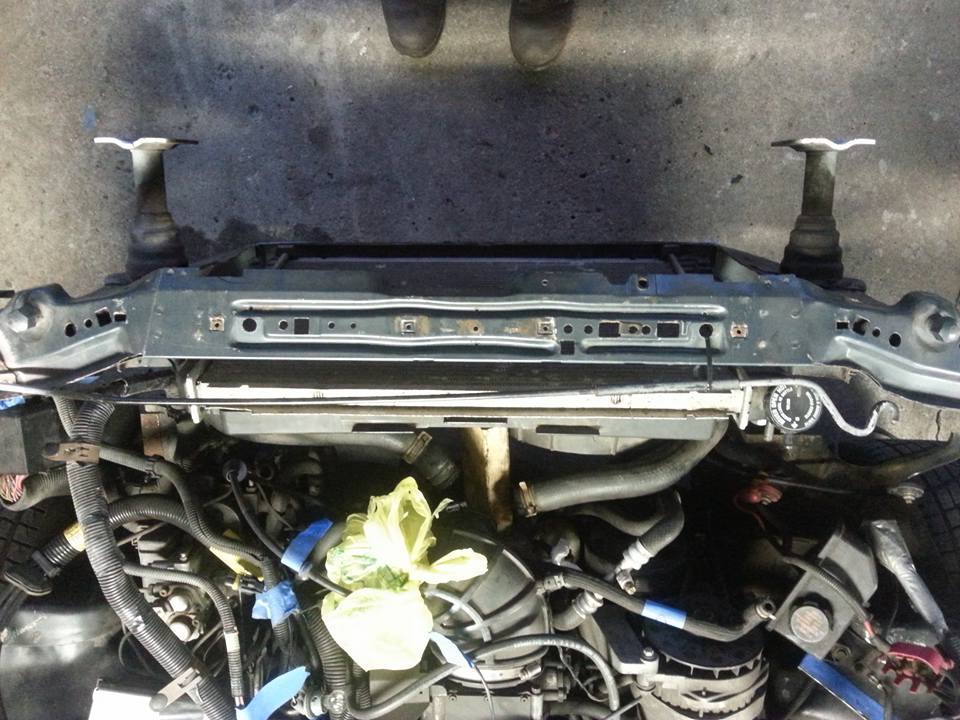

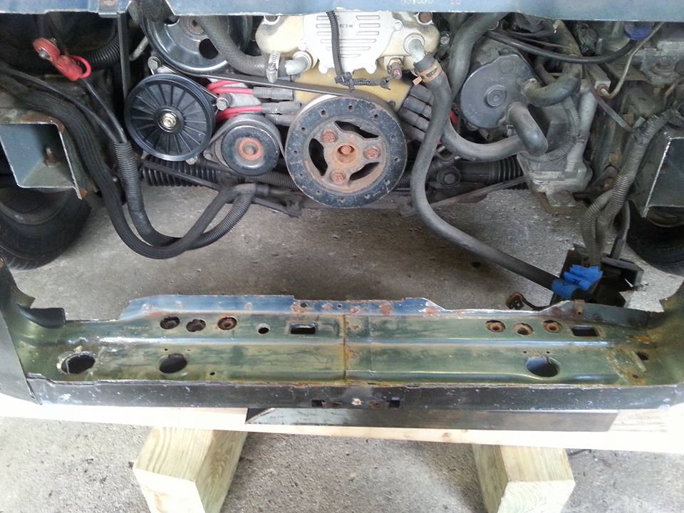

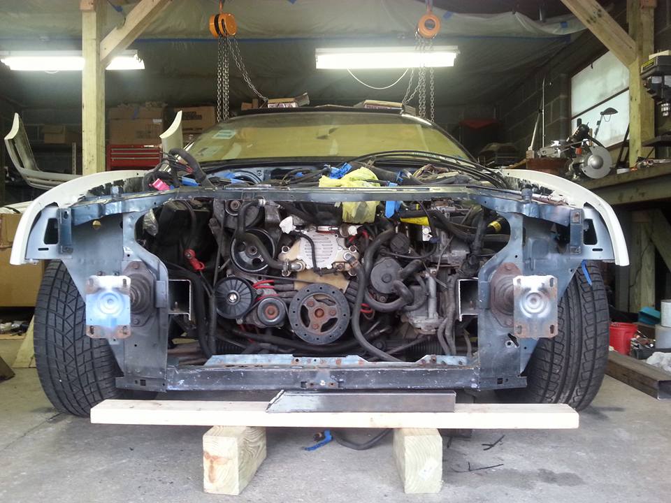

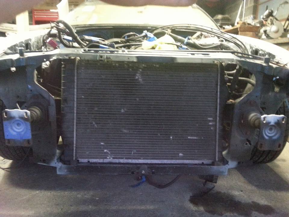

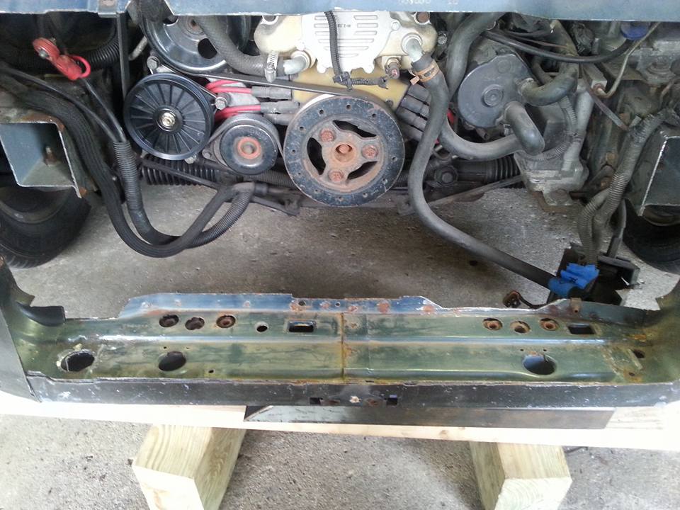

progress has been a lil slow lately. ment to post this awhile ago. or thought i did. Got the Beretta lower rad support/core support notched for the drain and fan shroud and dropped it down about 1.5 inch to make room for the camaro radiator and dual fan setup..... just gotta make a top bracket and should be set..

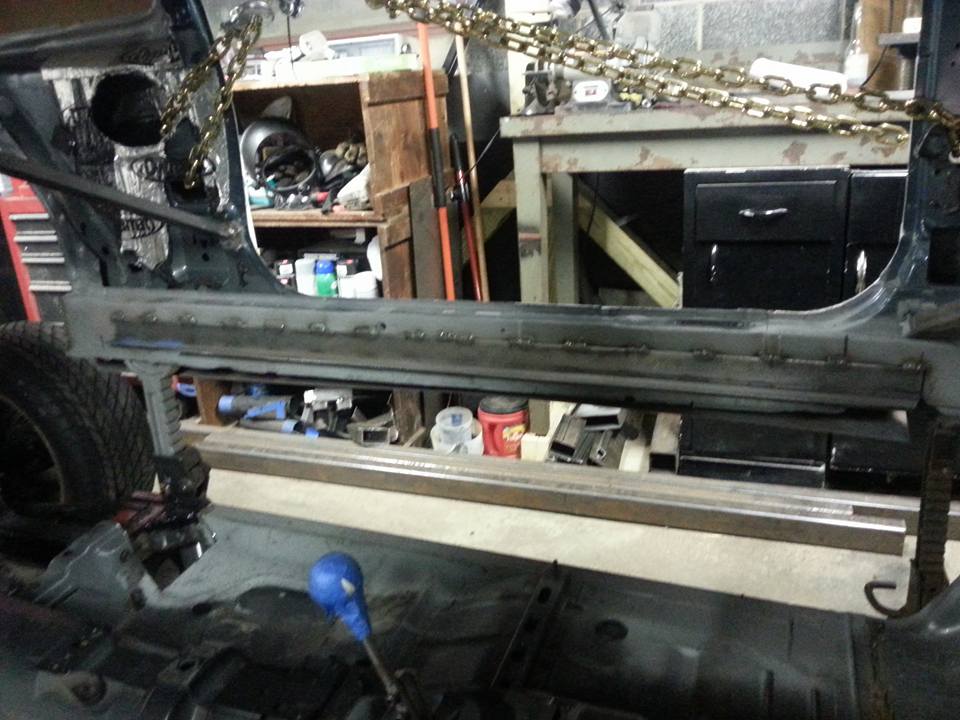

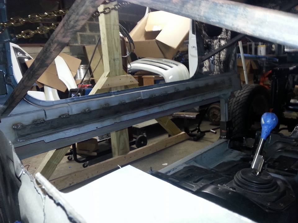

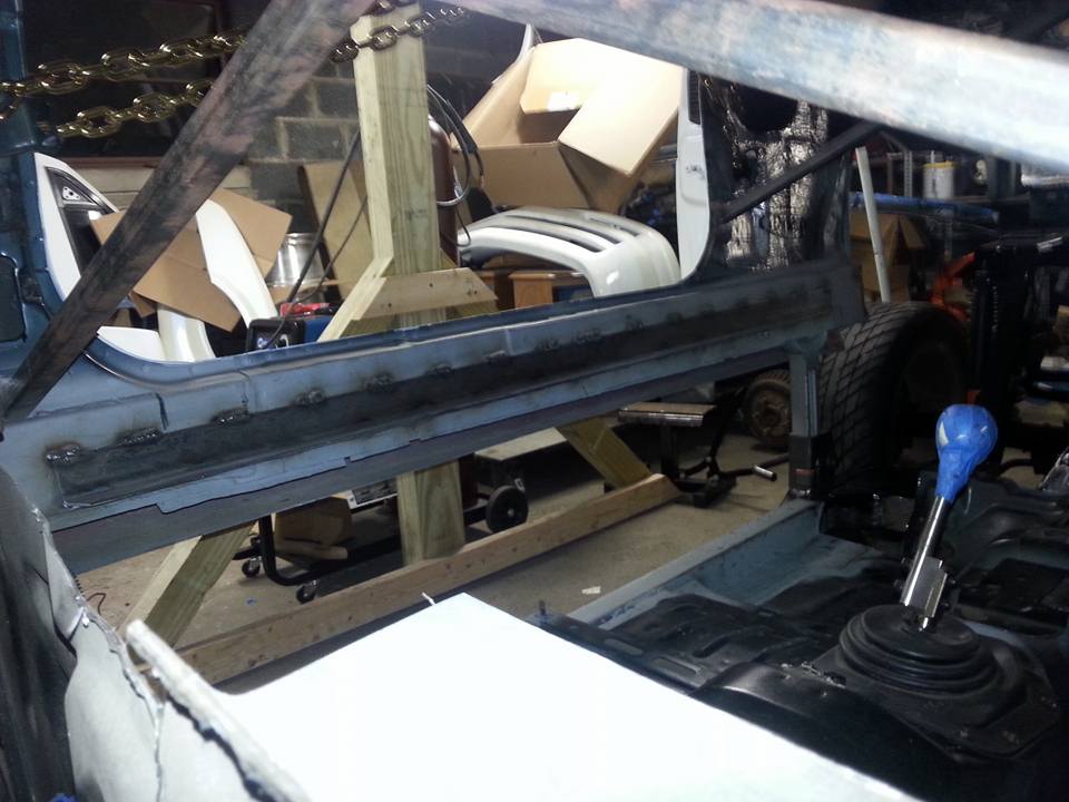

Stitch welded the body flanges in place ...gonna sit her down square her up and tack the body to the frame so I can start planning for roll cage and seat mounts.

Are you going to leave the angle iron on there after you weld the body to the floorpan?
For that lower radiator mount - If you have any C channel - cut it at 45* on both sides to form a triangle and weld it in to reinforce it being lowered - should make it stronger.
jjanke
Posts: 425
Re: Beretta Z28
Post by jjanke »
Yeah ...angle iron will stay. Thats what bridges the gap between body rails and inner rocker and supports the body......and good call on the lower rad support piece ......I thought about doing somerhing like that but figured that it was good enough for now.

Very cool - when you get the body and floor pans welded together - I'm assuming you will be permanently attaching them together?
I've seen some race cars where they have made the body/shell removable from the floorpan/rollcage.
jjanke
Posts: 425
Re: Beretta Z28
Post by jjanke »
Yeah .....was eventually gonna weld it as one ......just gonna tack the body on for now until cage is done fitted in there so I can lift it back up weld the cage then weld it for good

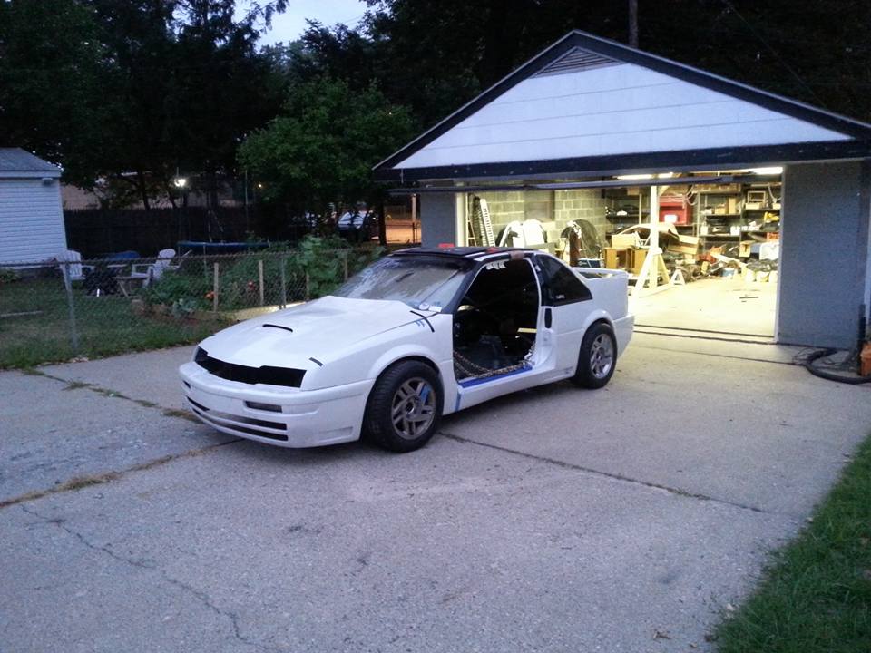

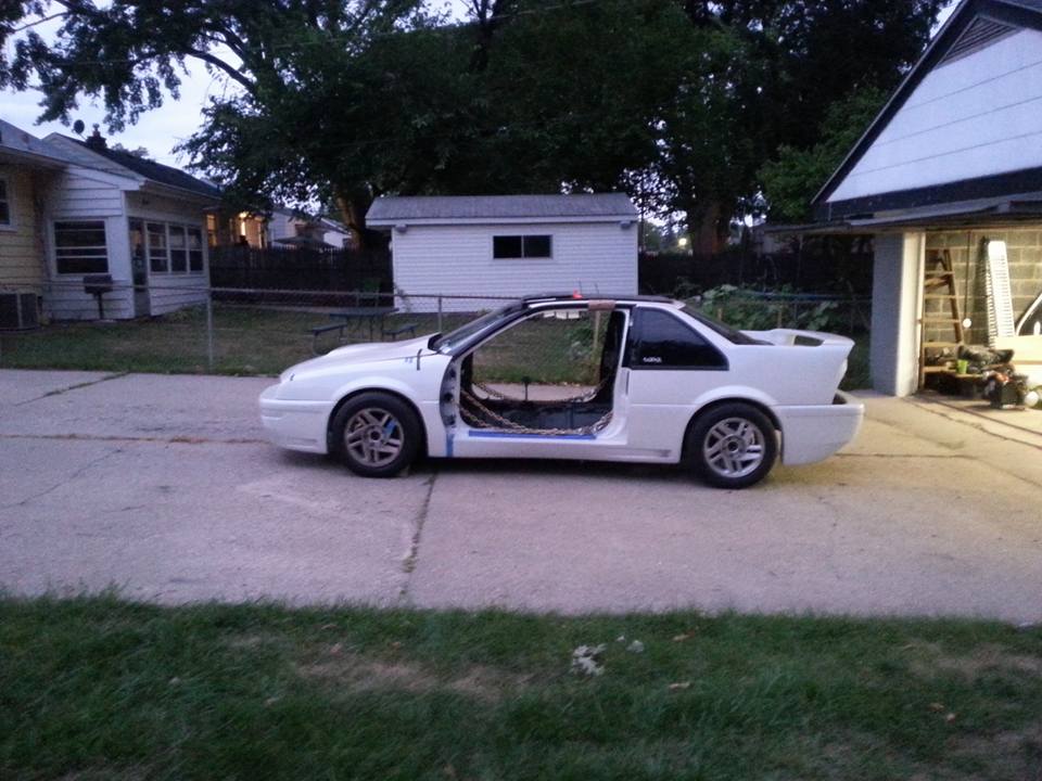

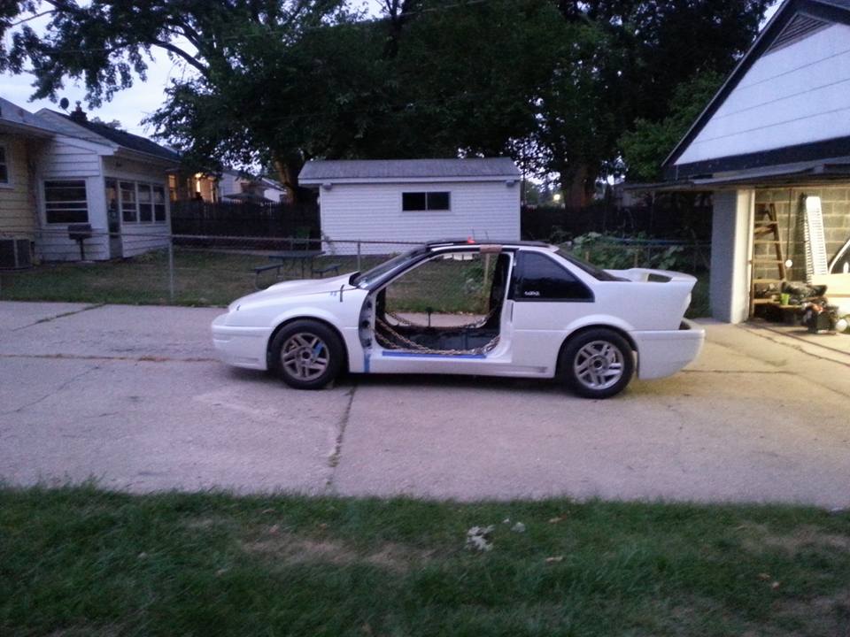

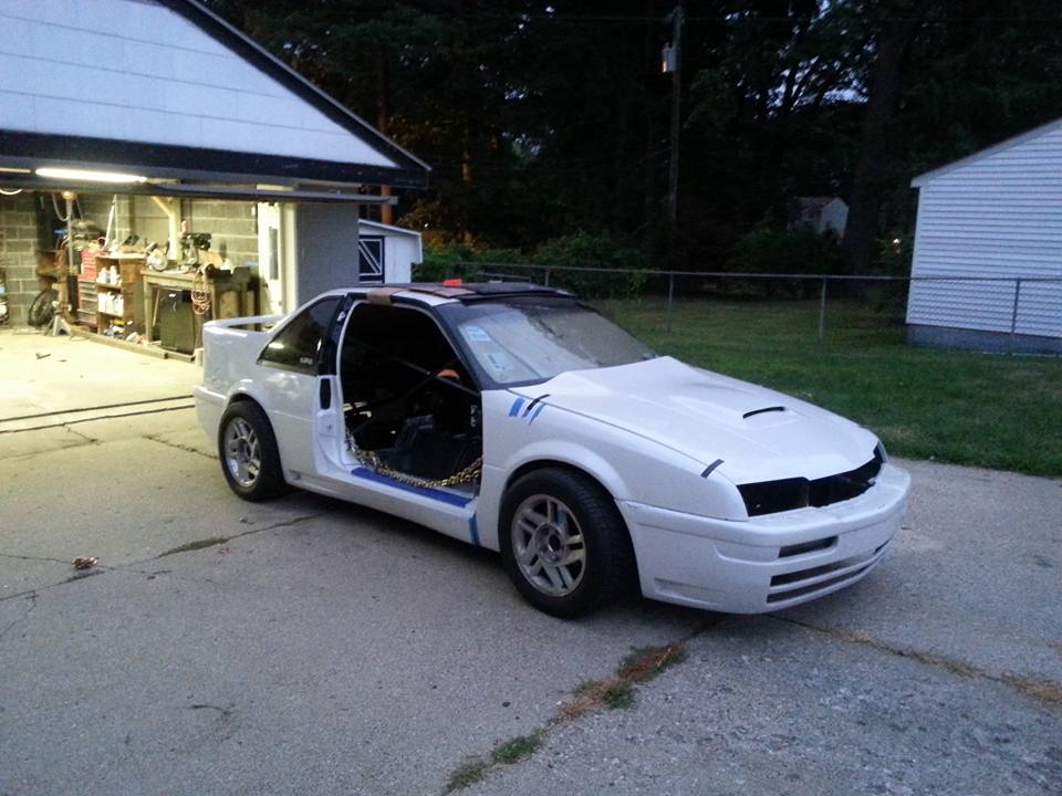

jjanke
Posts: 425
Re: Beretta Z28
Post by jjanke »

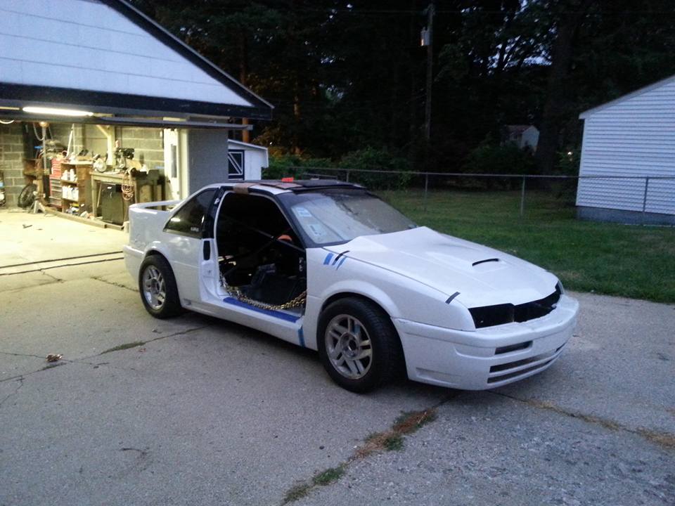

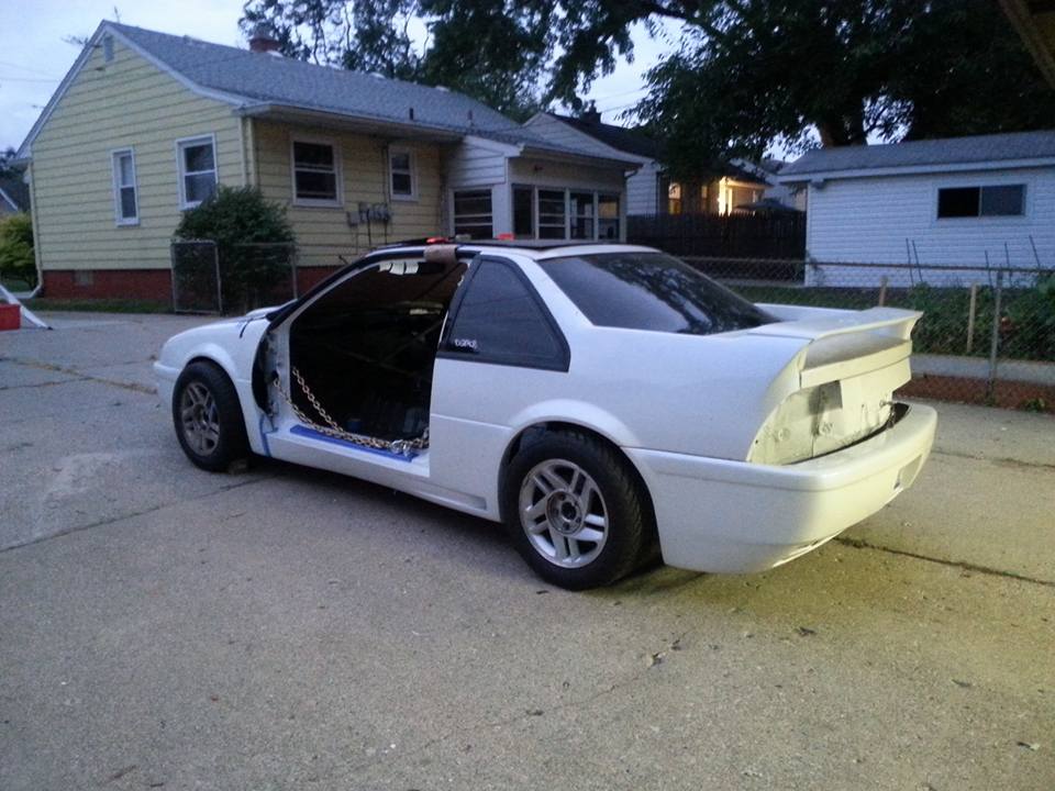

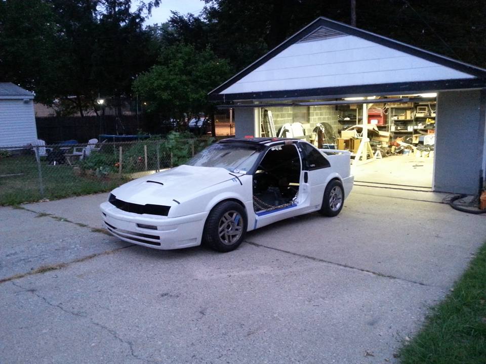

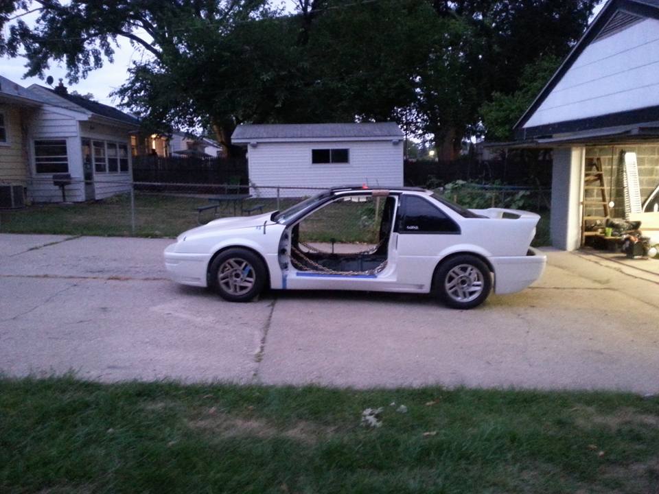

Actually tacked the body to the frame and rolled her out for some fresh air. Its really starting to look like something.!!!!gotta get a plan going for the next steps
Re: Beretta Z28
It's got fins like a '57 Cadillac and a trunk spoiler off an '09 Honda Accord?
The wheels stick out like a Clown Car!
Should have maybe checked with this guy on how to build a RWD properly.
http://www.smithperformance.com
Everything lines up and a rolling chassis is out the door for about $15K, certified to 8.50's.
Just a thought.
