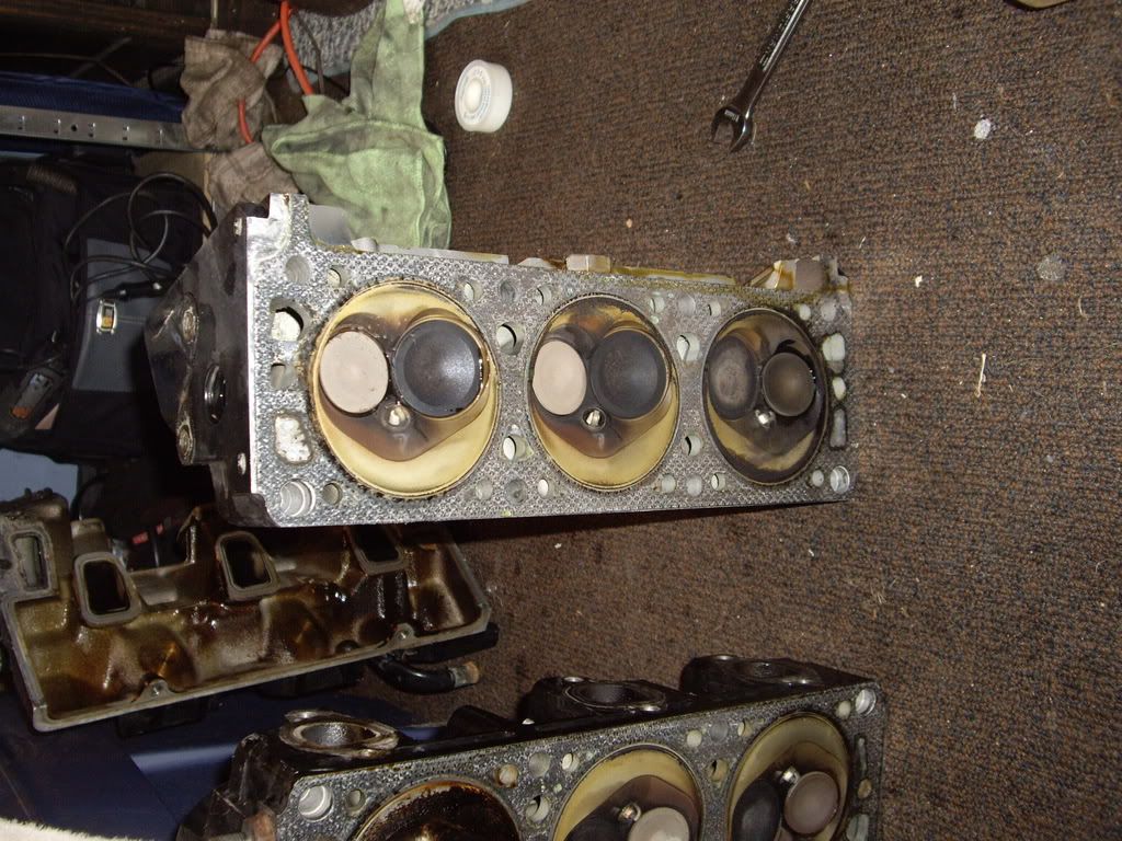

Here is what the pistons look like:

I'm confused on why you think the dish itself is a cause to think the quench ability sucks... Look at the cylinder head... how much flat surface is there exposed to the top of the piston?
The area of the head that would even come into play with quench isn't all that large to begin with, so I really doubt that the dish on the piston makes them alone suck for quench.
Your best combo would be to get a set of forged 10.5:1 3400 pistons and combine that with 3500 heads, IIRC that comes out damn near close to 9.8:1 on a 3400/3500 setup, but as you noted you don't feel that power is necessary. Remember it might have to do with your 12.635 gear ratio now, vs your old 8.55 ratio on why you only spin tire.

Jon has a good point. There is not a whole lot of flat space on the head, but if you wanted to go all out on the best possible setup you could have, you would go for flat tops to get the extra bit that is not covered by the outer edges of the stock pistons. There isn't a TON there, but it is a fair amount if you consider how little you get anyway.

Jon, are those tan areas completely flat? It's hard to tell in the pic but it doesnt look like it, and I would think they should be for good quench. In this pic you see the flat area of my Vortecs where the .040 quench with flat tops comes in to play.

This a better image to see it?
More just the yellow areas of the head in the last post.
So it's only really the ring area of the dished piston that even has a flat surface above it, the rest of the head is the heart shaped chamber.
