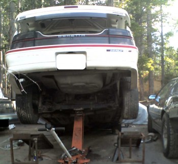

...And the stock pump in my GTU ran the 3800 SC just fine too for quite a while, before it finally succumbed to old age at 160K+ miles and over twenty years of age (at least I am pretty sure it was the original pump...). The most important part of doing the tank swap, aside from having it as empty as possible, is getting the car up high enough.
Even the ramps I had here didn't give me the room I wanted to drop the tank, so I used my long-frame jack for more clearance.
Also watch yourself around the filler-neck, that can be a PITA, otherwise, the fuel pump is a piece of cake to swap.
