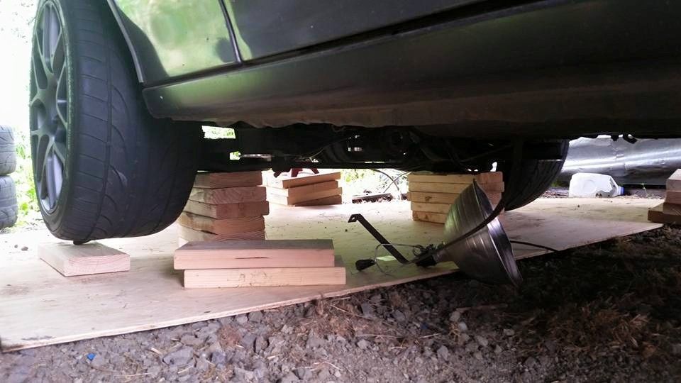

Got a little more done today. My hubs should be here by wed too.
I didnt spend too much time getting it perfect, it was just a quick mock up so I could see how the wheels would fit and how much I would have to flare the fenders
yes, it really fits that good! that side even needs to go in about 1/2" too.
I was kinda bored, really not ready to dig into the rear end but what the hell.. its gotta be done at some point
I didnt want to cut too much, I need to move the jack stands before I cut any more and mess up the structure. I dont want to fold the back half of my car over..
thats where I will need to cut.. 3-5" depending on where the roll center ends up needing to be.

got a little more done, power was out so I was pretty limited. Moved the jack stands and got the car level again
took a little more apart and cleaned up some.
That black line is where it will get cut for the frame. That is if nothing else changes and nothing was over looked, anything is possible at this point
