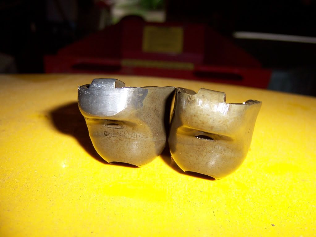

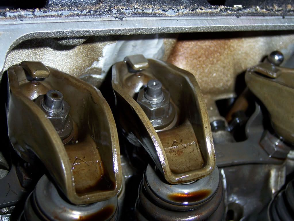

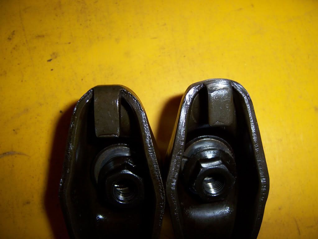

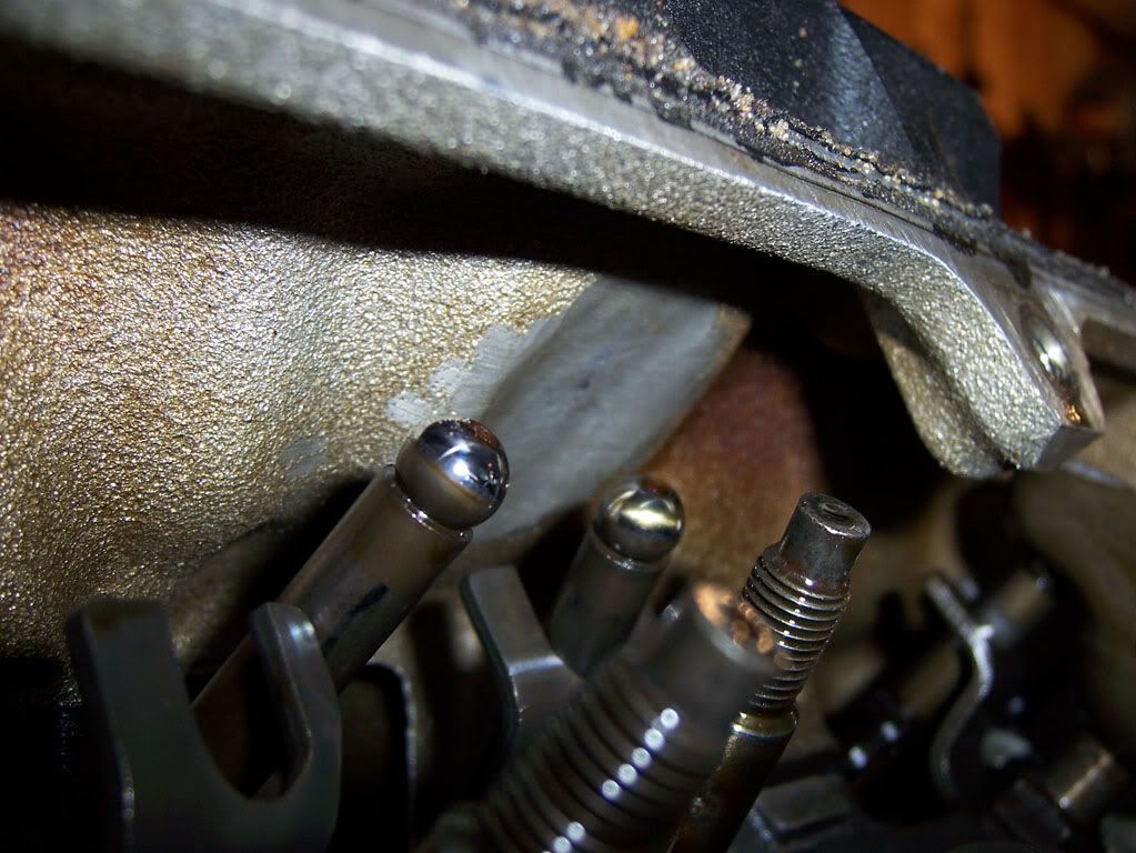

Sorry I'm way late on photos, but here...
This is what I did, I ground the intake a little, and then hit the rockers, its only 4 points that need it done.
